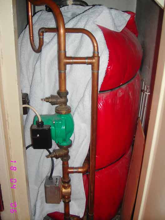

Hi, please help.
I have a Glow-Worm Fuelsaver mk 2 boiler which had a new gas burner 12 months ago and also a new pump fitted 10 months ago.
3 or 4 years back I noticed the radiator in the bathroom was getting warm even though I was selecting hot water only, this wasn't really an issue until summer!
Now however it seems to be getting worse as 2 of the 4 radiators upstairs are getting hot when I select hot water only from the control panel. My son's small bedroom is getting too warm now so I need to solve this before it turns warmer. Having the new burner and pump hasn't seemed to affect anything for better or worse.

You will have a valve somewhere, probably the airing cupboard, with 3 pipes and an electrical box on top. This is your 3 port motorized valve. The pipe from the bottom is your system hot water. When all is cold tomorrow and nothing has been on select hot water only on the programmer. If both pipes coming out of the valve get hot then the valve is passing to heating....will probably need a new valve but tell us the model and we can advise.

I don't seem to have that valve in the way you describe. The pipework is complicated but I'll try to explain.
There are 3 pipes to the hot water cylinder, bottom, middle and top.
The middle one exits and forms a T junction with a pipe from downstairs which is warm to touch after the water was on. Below this T join is a silver Honeywell box with a mains cable that has a Auto or Manual selector. Above the T junction is the pump. A further pipe comes from downstairs and is connected, without a valve, via another T junction joining the first pipe just above the pump. Hope that's OK.
Thats the puppy I'm talking about
OK but there's only one pipe in and one out. It's set to auto at the mo. Does it need changing?
A picture would be good to see exactly what we are talikng about but basically wheather it be 1 x 3 port honeywell valve or 2 x 2 ports or any other configuration the heating valve is passing and needs the ball and plate replacing.
AQs far as I can see in your nice and sharp photo, you have a limited control which gives hot water OR hot water PLUS heating.
The heating is obtained when the motor valve is powered to open it.
There is a lever on the side.
I am guessing but would expect that the valve has become stiff and is not fully closing under its spring pressure.
Push the lever against the spring pressure about 10 times and let it return un aided and it will probably free itself up and stop the rads heating.

Thanks Tony. I have tried flicking the lever a few times as you suggested but won't know if it works until tomorrow. I do have to say that the spring connected to the lever seems very weak.
