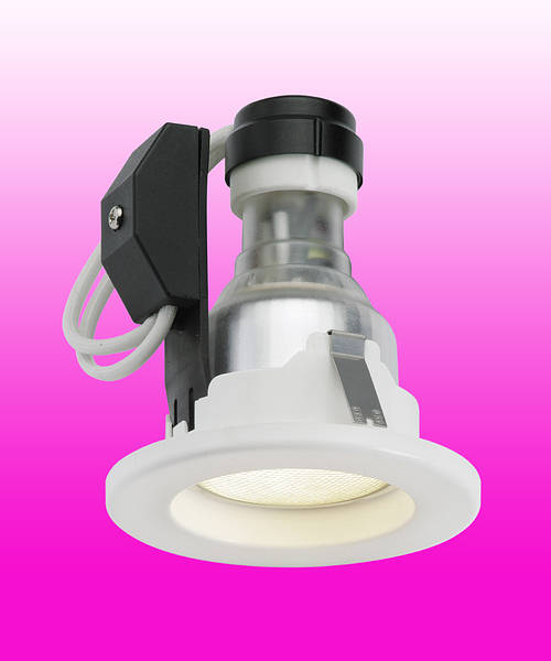

crafty, I've been looking at those but really want something that dims and don't think they do? (have replied to another thread asking about comercial flourescent downlighters, digital dimming etc. so won't cross post)
