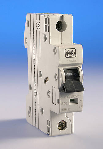

Something like this?
An MCB is on of these and is housed inside the consumer unit.
An RCD is one of these and is also housed inside the CU:

There is a reasonable chance that the isolator (The jobbie with the big red switch) may have failed, melting the wiring behind it causing a short circuit..
The MCB (middle photo) has not failed. It is still doing its job, exactly as it was intended. I recon I see 1 failed MCB every 2 years or so.
The thing you have been calling an MCB is a switch.
("Isolator" is a posh word for this kind of switch)
:wink:
What you have been calling an MCB is actually an isolator (top photo). The RCD (bottom photo) detects earth leakage and an MCB (middle photo) protects the cabling against damage from short circuits and overloads.
If upon switching the isolator the RCD trips, you have earth leakage. As RF said this could be due to melted insulation and a phase to earth short. Turn off the electricity at the MCB and check the terminals in the isolator (switch with red neon). Have a look for melted insulation or scorch marks on the plastic (caused by lose connections overheating). Let us know how it goes but remember to turn off the MCB at the fuse box first.
