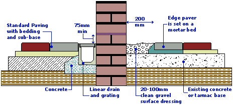

The dpc should be a minimum 150mm above ground level. You may also have motar bridging in the cavity by the careless bricklayer.

I agree with Masona that you should really take up the concrete outside and lower the level. That will also make it easier for you to remove bricks and rake out the cavity. I wonder where your airbricks are, with that outside concrete so high? Lack of ventilation will make the dampness MUCH worse and it looks like you have a newish joist, so maybe the floor has already suffered from rot.
