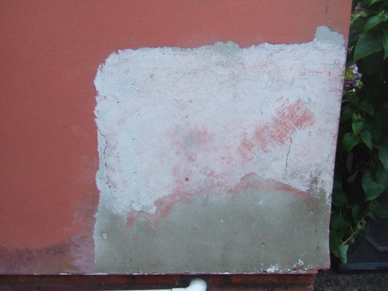

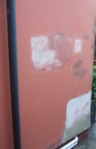

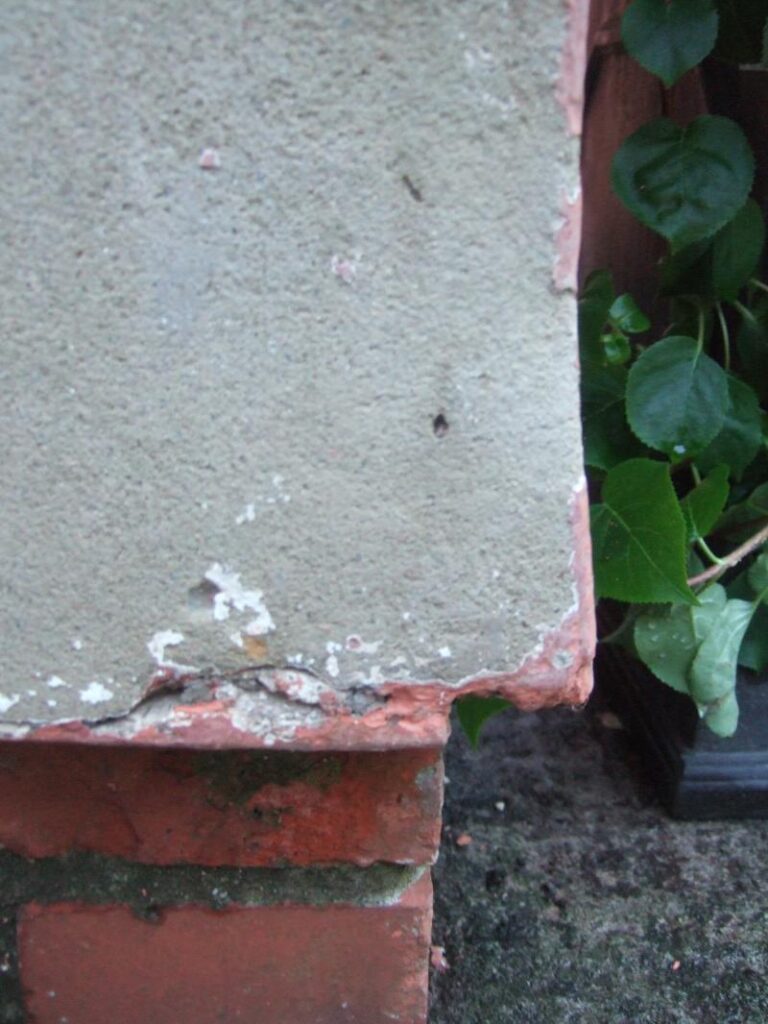

A homeowner has a rendered extension that has been repainted last year. A stabilizer/sealer coat has been applied over the previous masonry paint, and the finish has subsequently bubbled, flaked, and lost its adhesion. They have tried using sandpaper, scrapers, and a general-purpose paint stripper with very little success; they would like a quicker means to strip the paint away from the render, want to know how to prepare the render prior to painting, and if the bare render will be okay left exposed until they are ready to paint (images depict uneven paint removal with sections where the paint remains well-adhered). This is a common problem in many UK homes. Prior to investing in materials and labour, there are a few simple things you should check to ensure that you are addressing the root cause of the issue rather than just treating the symptoms. Below, we will describe the most common causes for this type of failure, provide several simple self-assessment tests to help determine the most probable cause(s) of the failure, and describe the proper repair process – along with common “bodges” that typically don’t last.

In many cases issues such as these result from either moisture or a poor layer within the system. That is, the new coats of paint have essentially formed a skin over something that should have been allowed to breathe or was already compromised in some way.
A stabilizer is not always bad per se. However, if the render was still green, meaning not yet fully cured, or if the surface of the render had powdery or weak materials, salt, algae, or old flaky paint under the new coats, the paint could seal in dampness and prevent the wall from drying properly. Once the sun hits the wall, moisture pressure increases and blisters and sheets of paint lift. Neat masonry paint over new render can also form a barrier that prevents drying when applied in a single, overly-thick coat.

Tap Test
- Tapping on the surface with your knuckles or the handle of a scraper.
- Hollow sounding surfaces typically indicate that the paint has separated from the render.
Scrape Boundary
- At an edge where paint is flaking, try scraping back to see if the render surface is solid or dusty.
- If the render surface turns to powder easily, that requires consolidation or repair, regardless of paint.

Good – Remove Loose Paint, Re-coat Correctly
If only certain sections of paint are failing, a reasonable approach is often:
- Remove all loose or flaking paint back to a solid edge.
- Feather edges, wash down, and treat any algae.
- Repair cracks properly rather than just smearing filler over them.
- Prime where necessary, then apply a breathable masonry system.
This is the least invasive approach. However, there is a possibility that additional apparently sound paint may fail at a future date if the original cause is still present.

How Long Will Exposed Render Be Water Resistant During Interim Period?
Render will shed some water, however it is not a waterproof jacket. It will absorb rain, then dry out if it can breathe. Generally, short term, that will suffice provided:
- No prolonged periods of heavy weather are expected.
- No obvious cracks are allowing water to track behind the render.
- Temporary coverings are not trapping moisture.
If the render is cracked, crumbling or you have exposed weak spots, that is when water will enter, particularly at edges and junctions. In such cases, prioritise repair of cracks and monitor for signs of internal damp.
