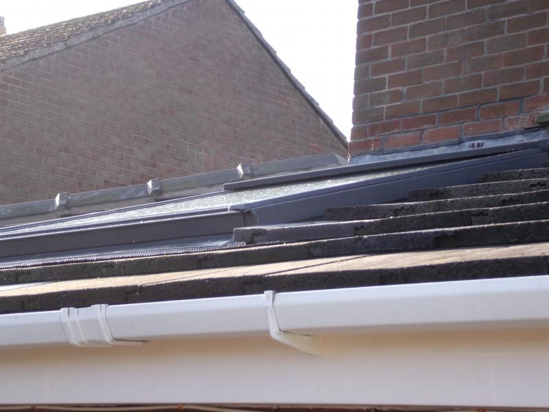

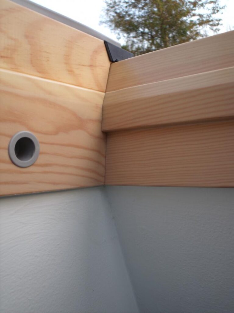

The leak is with my four year old centre pivot roof window which is only leaking in very windy rain conditions. The water appears internally (at the bottom) left hand side. When I inspected the internal frame further I could find no signs of water anywhere else except for the same area where the wetness appeared. I have checked the external surface and can see nothing out of the ordinary. It makes it difficult to identify which issue is responsible i.e. either the flashing, the window frame itself, blocked drainage channels or simply due to the low angle of the pitched roof. Which item(s) would be the most important thing to inspect first? And what would be an acceptable method of repairing this type of roof window?

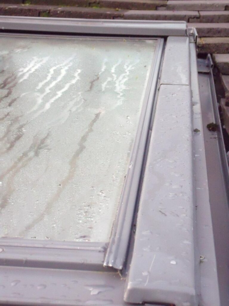

- Check the exterior frame and seals for moss, debris, and leaf litter.
- Clean these areas if necessary. If the leak disappears immediately after cleaning, it indicates that debris was clogging drainage channels or preventing water from flowing away.

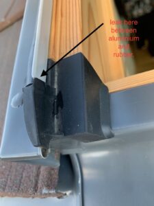

- Inspect the bottom and sides of the aluminium trims.
- Look for bent pieces, gaps, uneven edges, or anything else that looks slightly askew. Even a small crack can allow wind-driven rain to enter.
- Examine the rubber seals, are they dirty? Slime-covered? Holding beads of water?
- Cleaning seals is possible. If you notice water collecting and dripping down the seal lines, it indicates that water is seeping in there.

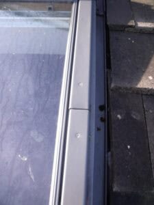

- Check the screws fastening the external covers.
- Any screws that stick up from the surface or appear to be driven crookedly could be trapping water or distorting the covers enough to create a water pathway.

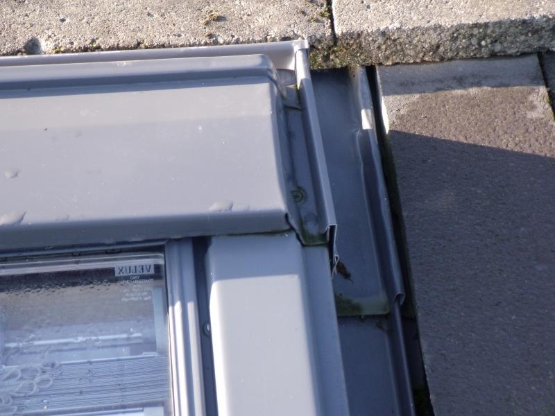

If none of the above-mentioned issues present themselves, then a logical next course of action would be to remove or raise the flashing around the problem area to determine where water is actually entering. Do not guess – prove it. Ideally, you wish to visually verify whether water is being forced behind the flashing, if either side channel is clogged, or if the problem lies further up and water is flowing downward. This is typically when an experienced roofer earns his keep since he/she knows what should be there and what appears amiss.
