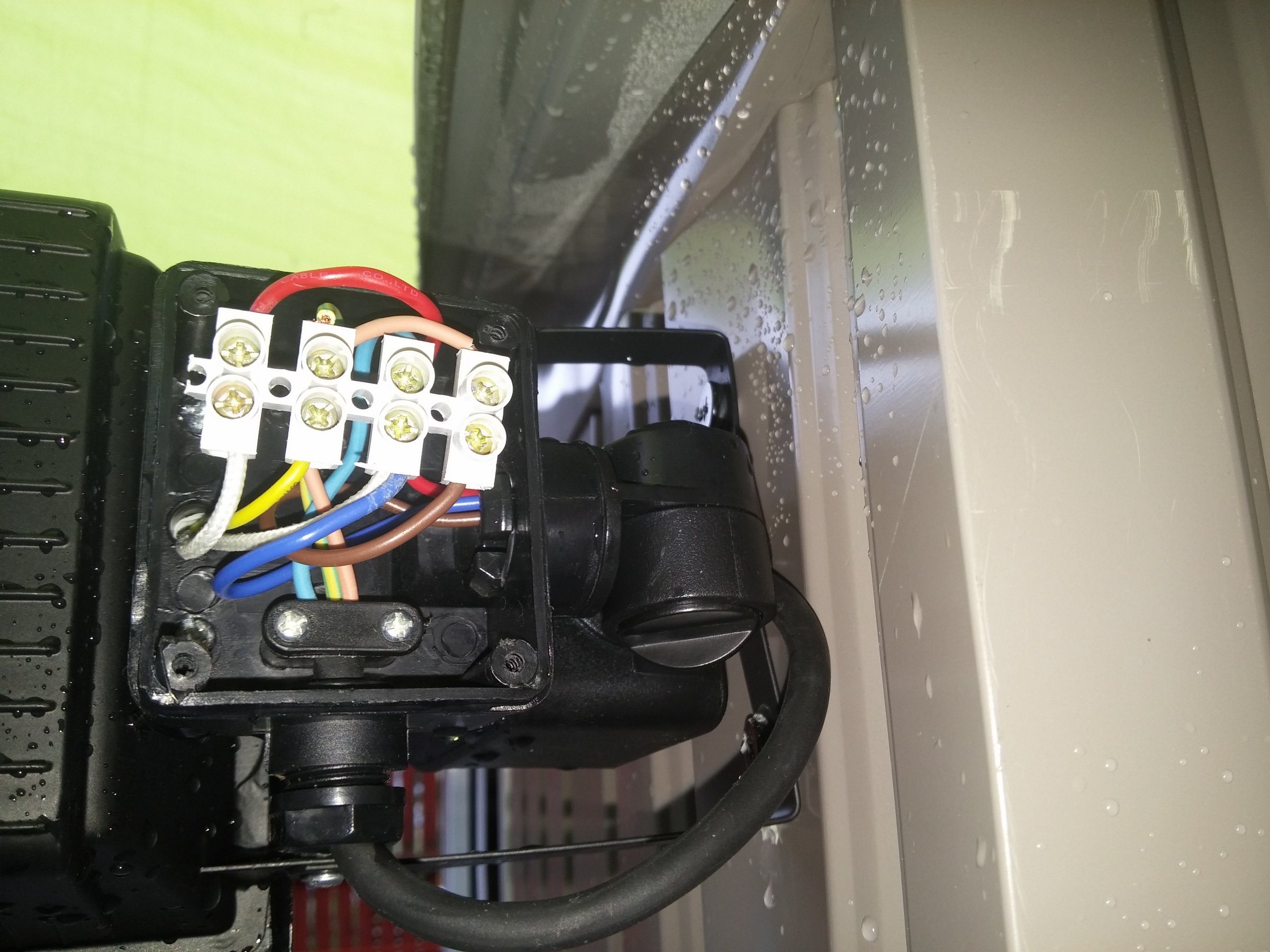

Floodlight
Hi, if you connect the live (brown) in place of the red that will bring on the lamp, that will determine if this the pir or lamp that's the problem.
Regards, DS
