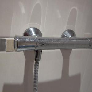

    shower mixer tap - too cool
    Hi Stem Thanks for the info and i think I have managed to attach the photo now. The temp knob is on the R/H side. There is a button on it you can press but this just locks the knob in the mid-position between hot & cold. With the temp knob turned fully hot and I reduce pressure with the other...
  17. M
    Stem thanks for the reply and link. Going by the picture it looks like the Duo DN 15 Ref 6209705-00 although I cannot be certain. There is no switch or button that allows temp dial to be turned to a higher setting. PS how do I attach a photo to this message? I can't find any info on this...
  18. M
    Hi Stem Thanks for the reply. I have uploaded a picture of the mixer and found Kludi engraved on one of the end, R/H side. I'd appreciate any info you can give to make the shower warmer. Regards.
