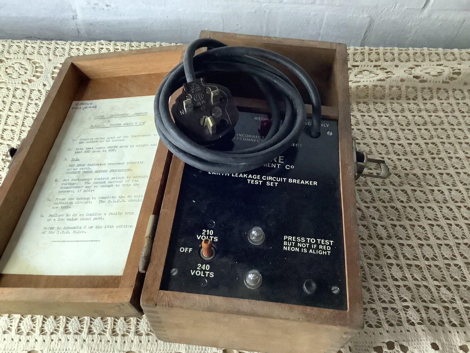

Furthermore, I came to work on a log cabin, and testing the RCD it failed to trip, and I found an ELCB-v in a stone cottage from where the log cabin was fed, the tester I should have used would have looked like this Clare ELCB tester3.jpg I have never actually seen one, only pictures, and one wonders how anyone tested them, we should do a PIR every 10 years, and simply can't see how we could have done a PIR (now called EICR) without the tester?
But dad's house would have had a metal water pipe supply, so the ELCB-v would have never worked, and until the water pipe was changed to plastic there was no need for the ELCB-v their life was very short-lived, came in late 70's and gone by early 80's, think I only came across them twice, the other time was a caravan site, with static caravans.
