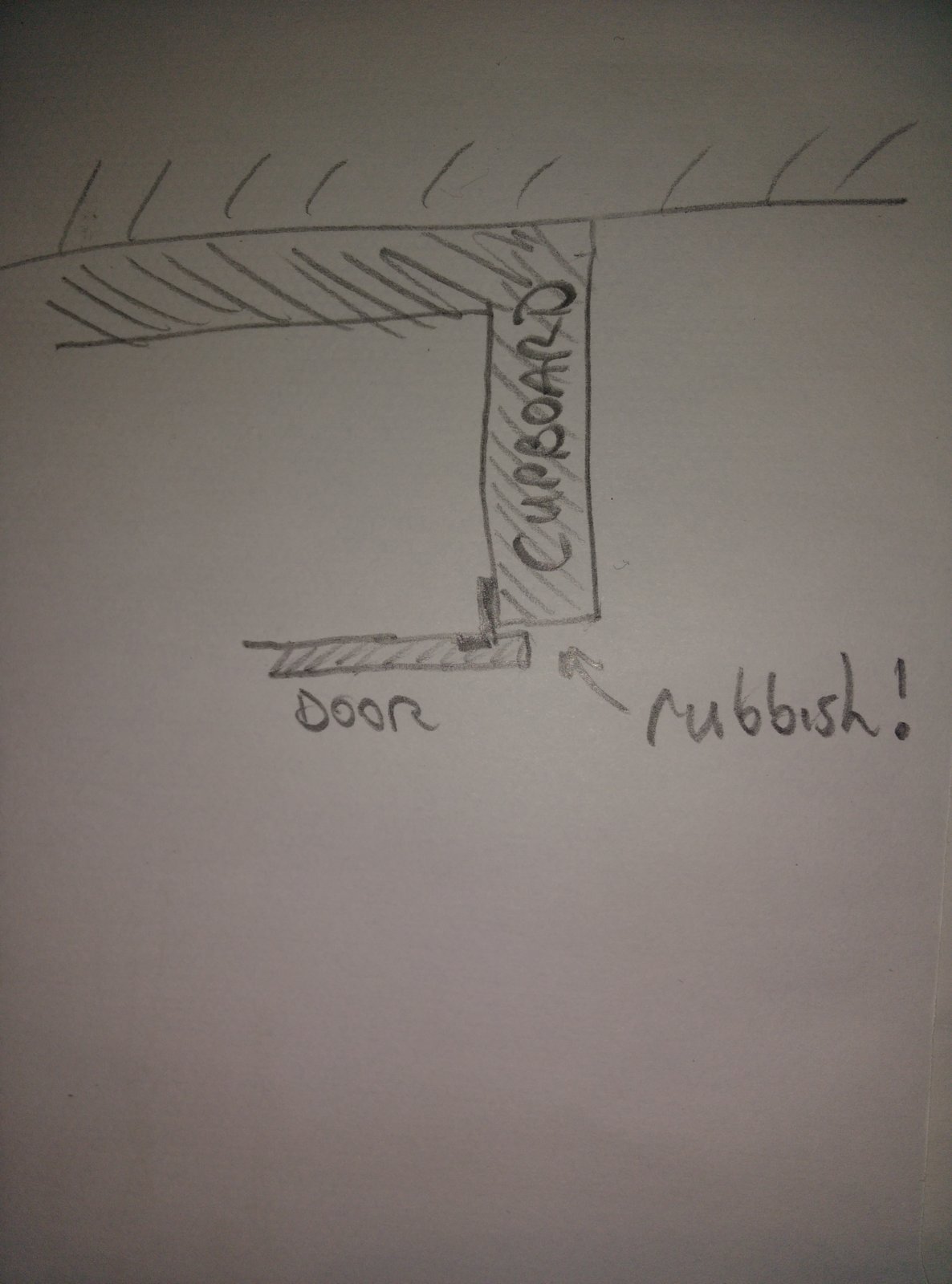

I want to add doors to some open cupboards in my kitchen (see picture) but I can't figure out how to do the hinges because the frame is quite wide. The usual concealed hinges would have the doors set away from the edge of the cupboard, which would look untidy. I could address that by adding some trim, but really I just want a nice clean line. The alternative would be to use simpler non-concealed hinges, but again, not such a great look.
Are there any solutions to this that I haven't thought of?

you could use butt hinges then, on the end of the side panel and the rear face of the door. Brass might look nice. The knuckle of the hinge would be visible.
I was afraid that would be the answer! I don't have a router and my chiselling is atrocious.
You could rebate the hinges into the sides to remove most of overhang , can be done with drill and suitable bit.
yes 2.5mm pilot hole no4 /3mm screws
if you use a power screwdriver do not overtighten
if you are not sure stop a couple off turns short and tighten with a hand screwdriver and you will be fine
Thanks! Pilot holes will help keep things true as well, and I've heard of people dipping screws in pva for mdf so I'll do that. Doors will be 18mm so hopefully enough strength there.
