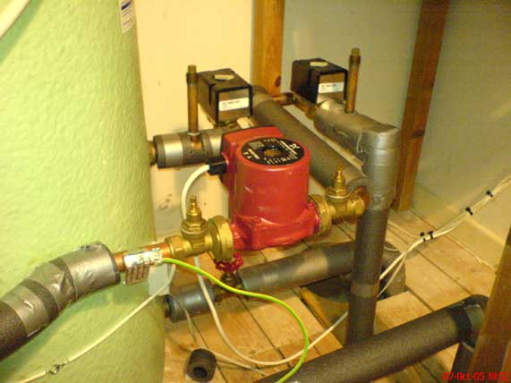

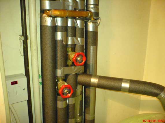

Maybe they are not cowboys but their after sales manager must be called Wyatt....Dahn from the smoke, are they :?: . You get a better service in E. Sussex. We`re just simple country folk. ;) Can you send a pic. of the layout in the airing cupd. pump, valves etc.
Pump orientation is wrong for a start.
Pictures do not help in identifying flow, return, vent and feed pipes.

Er, okay...I actually rotated the pump through 90 deg myself as it seemed to make more sense having the bleed valve at the top rather than on the side (with the speed switch on top)??. In Picture 2, the vent pipe is first to the right of the white plastic overflow pipe, and the feed from the expansion tank is furthest to the right (i.e. the two pipes that have been bridged). I don't even know what the 'three tee rule' is!
Rotate your pump back so the pump shaft is horizontal, terminal box on top. It won't fix this but it'll make the pump last longer.
