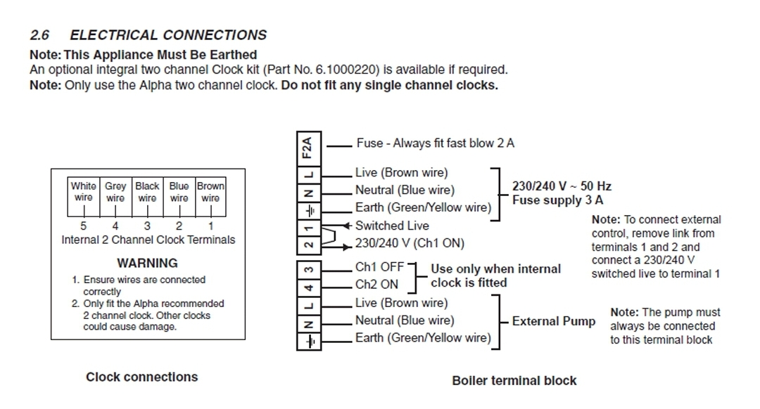

Can anybody explain what Alpha are getting at with the attached wiring diagram?
Where it says Note: To connect external control, remove link etc….As far as I can see, you could leave the link in and put 230V on 1 or 2 (from a stat). Or remove the link and put 230V on 1. It doesn’t say what the link is for. It suggests there’s a 230V output from 2, with the link in, but I can’t see why you would want that, and if you did, it’s available between the stat and the boiler.
I don’t suppose there’s a problem in practice, but it puzzles me.
If you left the link in place, the boiler would constantly be receiving a live supply from terminal 2 on its call for heat terminal 1, the heating would be permanently on (dependent on the built in clock).
Note the arrows on the diagram - terminal 2 is a live out, terminal 1 is the switched live return...
This would be the usual method.
You could use the 230V feed from terminal 2 to provide a live to power the thermostat (the neutral would need to be piggy backed on the boilers N terminal) - it simply provides a convenient extra L terminal to use.
There is also the possibility of connecting a battery powered stat, with volt free switching - terminal 2 would connect to common of the stat and terminal 1 to normaly open.
Yes, obvs you wouldn't want that. So T2 is permanently live (from an internal connection)? If so you couldn't leave the link in, as I suggested. The only time you'd want the link in is if you want to switch the boiler On/Off at the fused plug. And that wouldn't be right, as the pump stops immediately, losing the overrun feature.
That's a possibility, but I'd have thought more likely there's 230V avilable elsewhere, and just put power to T1 via the (external) clock and stats.
That's a good point.
Yes, although it appears there is the option to control it as a channel 1 out, but that would involve connecting the internal clock.
In most cases, this would be a permanent live.
It's considered best practice (and quite sensible), that the power for the stat is on the same circuit as the boiler - whether that be from the same FCU, or from a flex coming from the boiler itself.
In the case of smart stats, it makes sense and is least effort to run a short flex from the boiler to the RF receiver.
Being on the same circuit means at a boiler service, there is a single point of isolation; the internal circuitry of the boiler is completely isolated from the mains. If there were an alternative power source to the stat, a switched live may still be received at the boiler, with shocking consequences for the RGI!

OK, I take the point, if the boiler needs a permanent live. My whole system is powered from a 3A plug, but the boiler has no permanent live, just fires when given 230V.

Are you sure about that? According to the instructions there should be a LNE.
