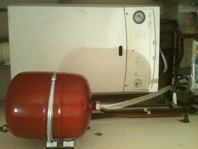

Hi, though that I'd post back the results of the work done on my CB24.

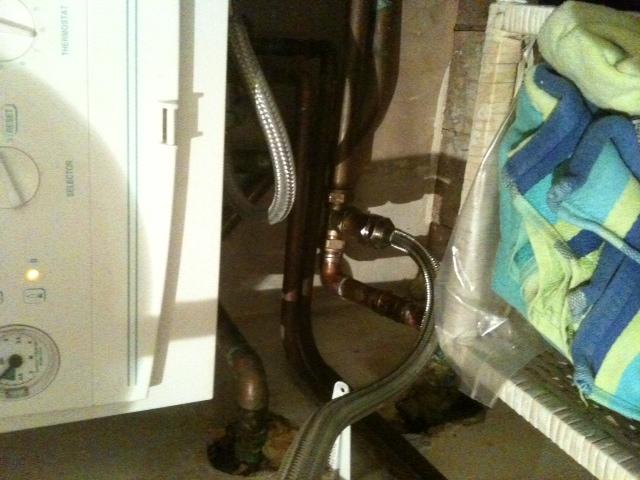

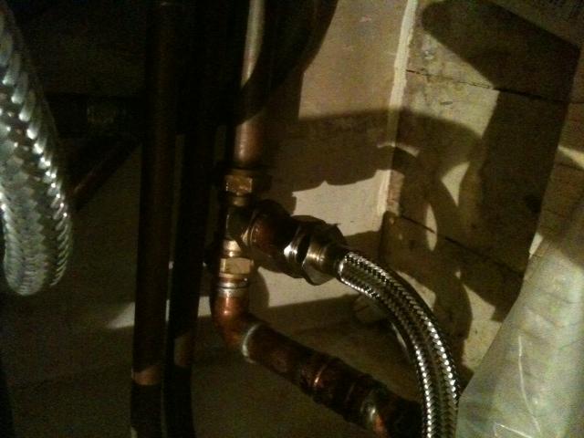

Eventually fitted an external pressure vessel bought from Screwfix (8 litre one) and fixing collar (all in about £37) Cut this in to the return of the heating system after draining down , fitted with a compression t joint with a stab of 22mm copper pipe sticking out and then bought a 900mm length flexi hose again with compression fitting onto the stab end of the t joint and then tightened straight on to the new expansion vessel. (flexi hose again from Screwfix at £5.00 - don't go to B&Q!)
Refilled with the filling loop, bled the radiators and it works at treat, no more lost pressure at all. Will need to add some inhibitor through the top radiator at some point soon though as I didn't do this (this is about £8 and can be squirted in with a silicone gun)
Hope this helps people along the way.....

You could have saved yourself a lot of expense and a lot of time if you had just followed the advice given to properly re-charge your existing vessel
A check of the pressure vessel had already been undertaken and showed that this was losing pressure from the 0.8 recommended in the user manual.
Cheers Ben
