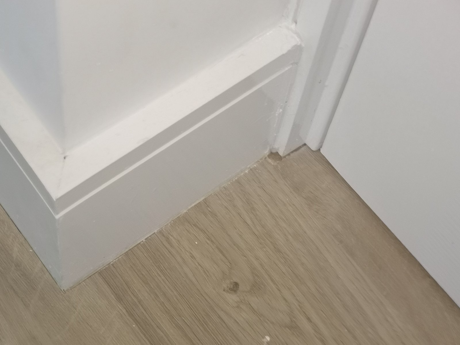

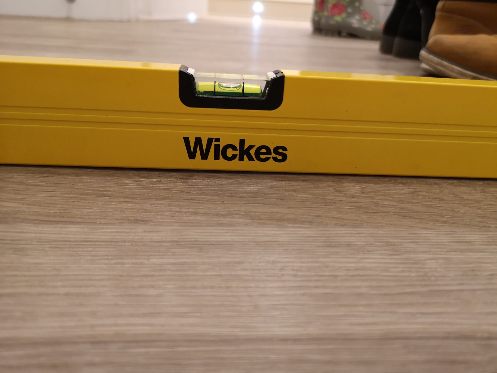

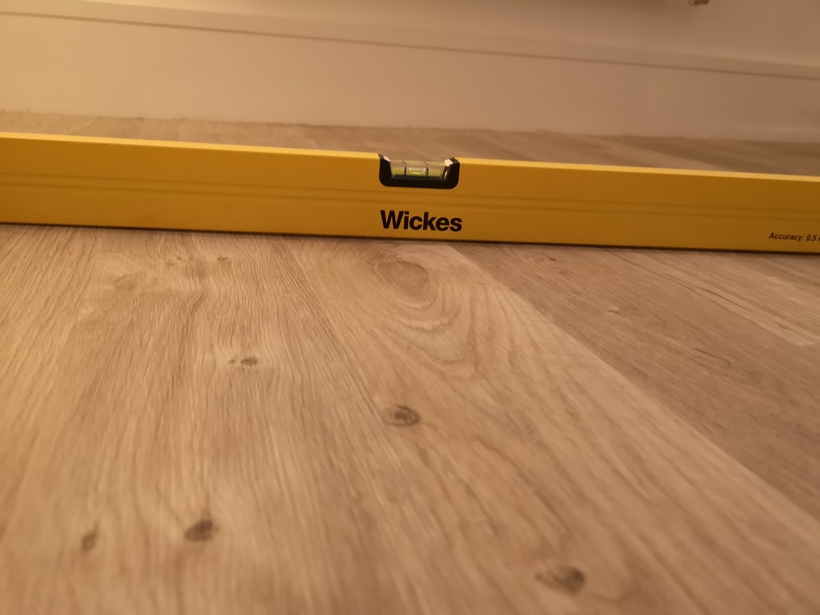

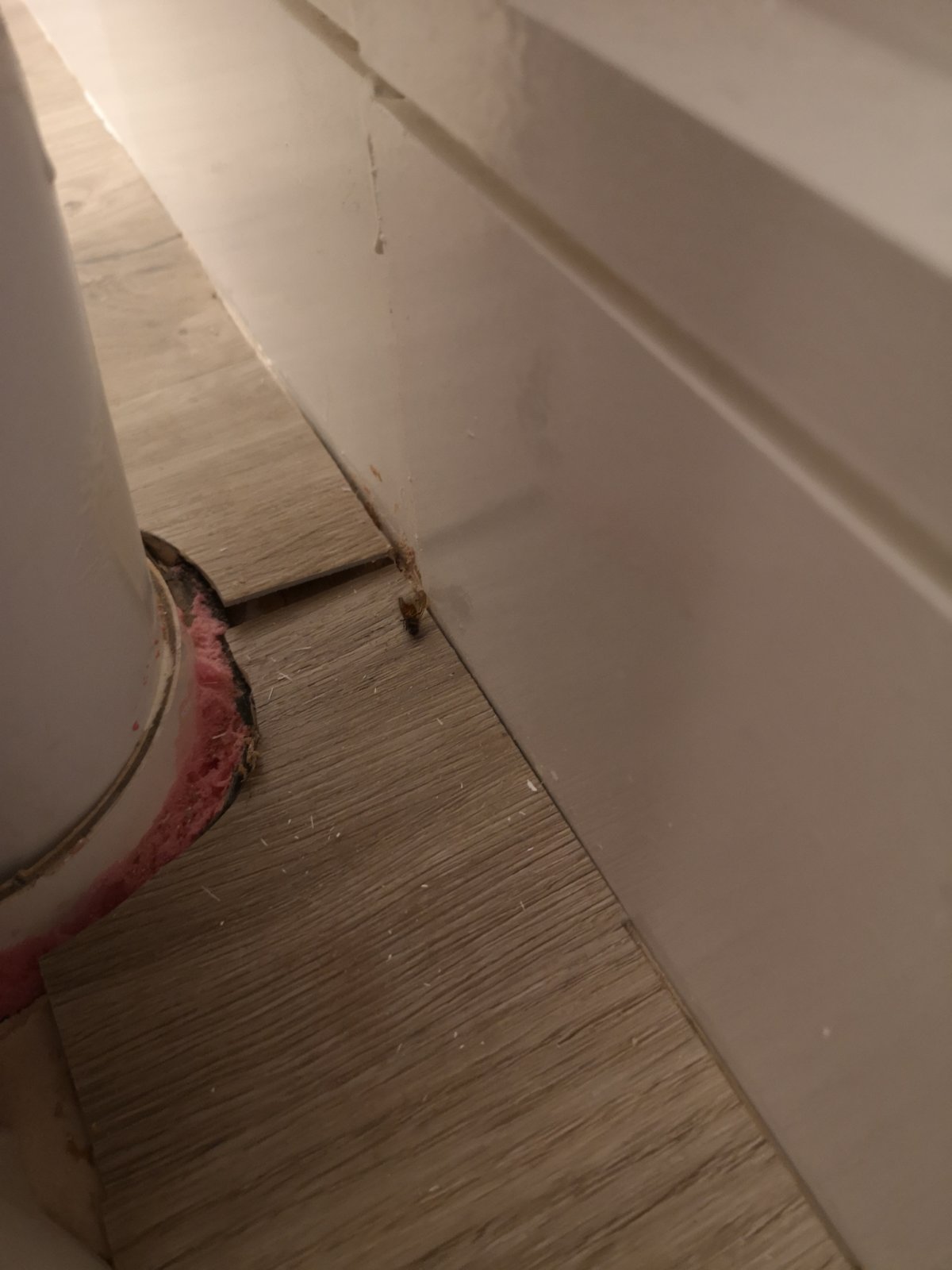

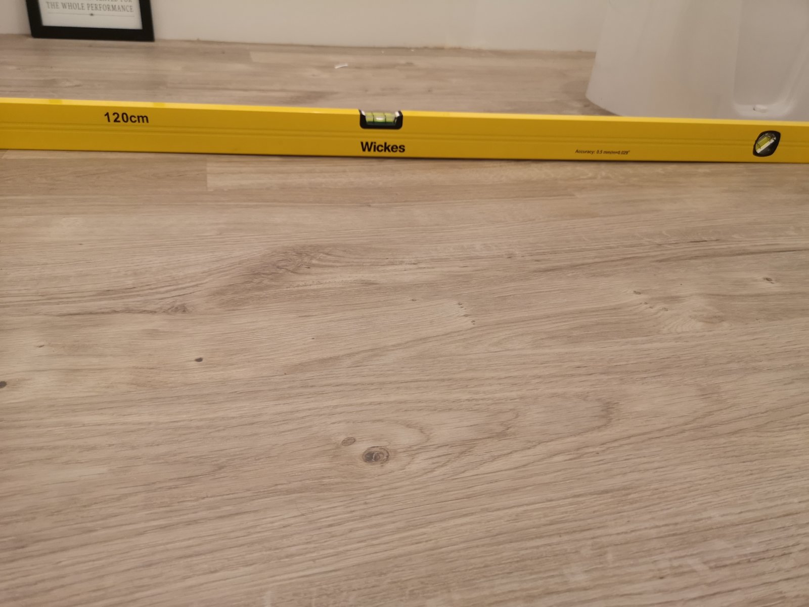

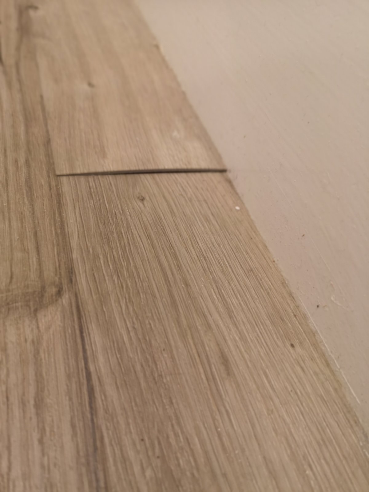

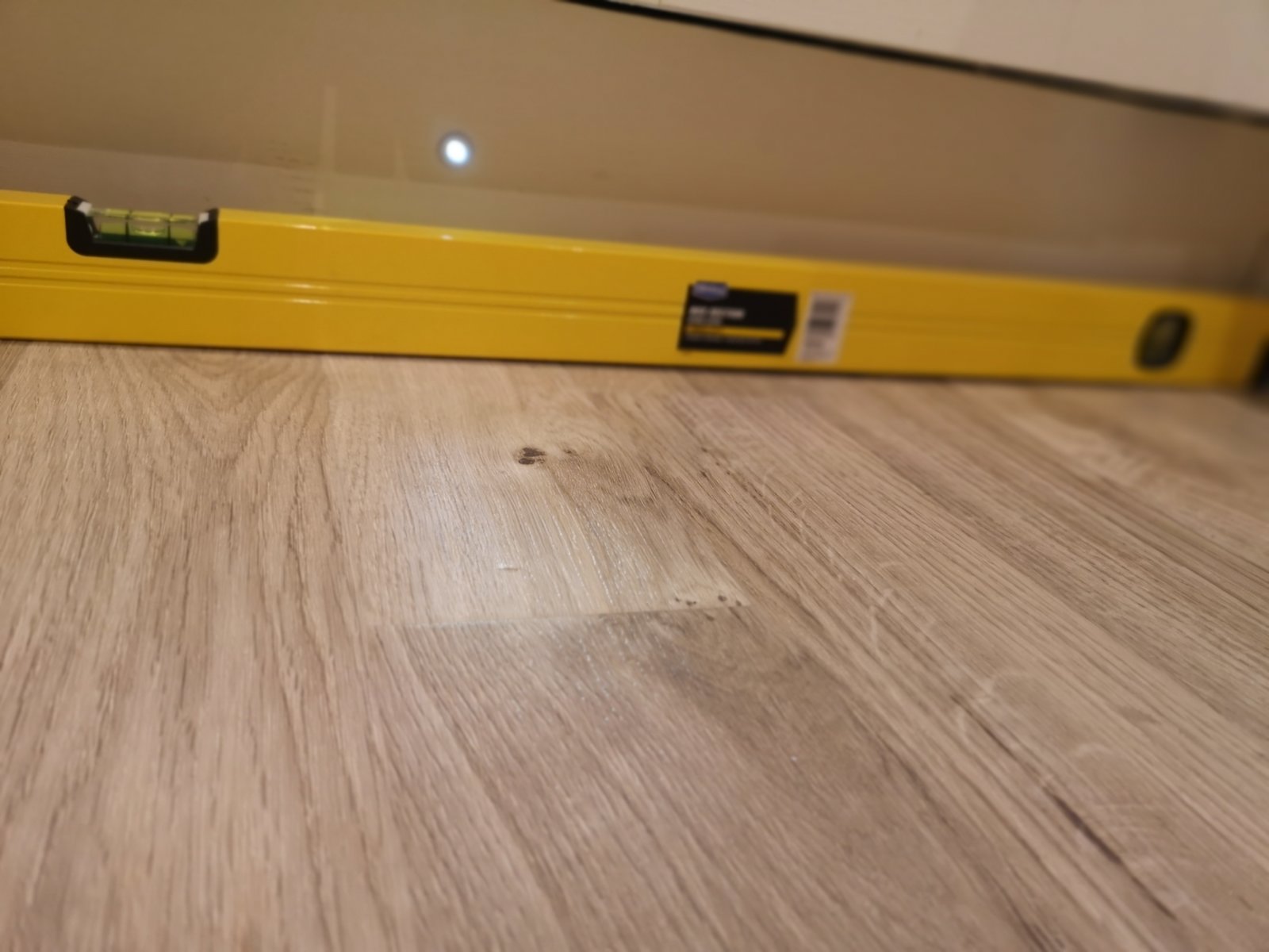

Hi all just moved into a new build about to have my 7 day visit and want to not if thay should relay the amtico flooring I think it's a very bad fit some of it is coming up it's uneven like lumps and dips and the border are bad as well pictures below

Anthony j, good evening.
If it were me, I would simply reject that floor.
From the images posted, the workmanship is best described as being called as "shoddy" and very poor.
Sorry but I do not know what the "7 day visits implication is" I have not encountered it previously? there are possibly others on the board that understand the "implications" of this terminology?
Ken.
Ken.
Hi Ken it's a 7 day visit where you can give them all the defects that you have found out and that should fix them but I know that will try not to from the pictures would you say the level of the floor is unacceptable as this is where I think thay will try not to fix thanks for your time
That’s the usually standard of a new build where the building company sort the flooring out. All done on the cheap and rushed.
