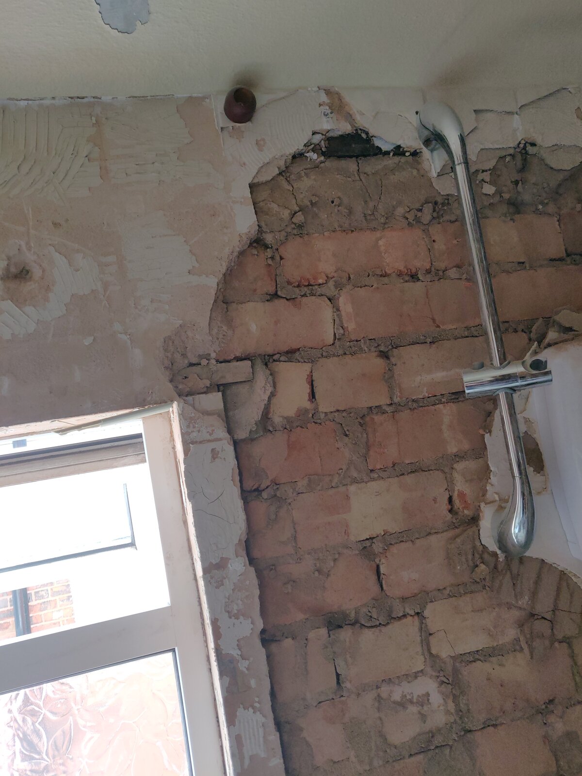

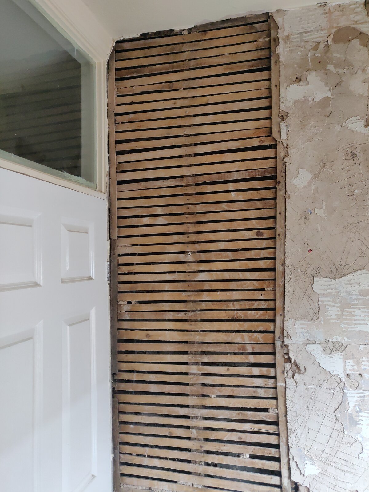

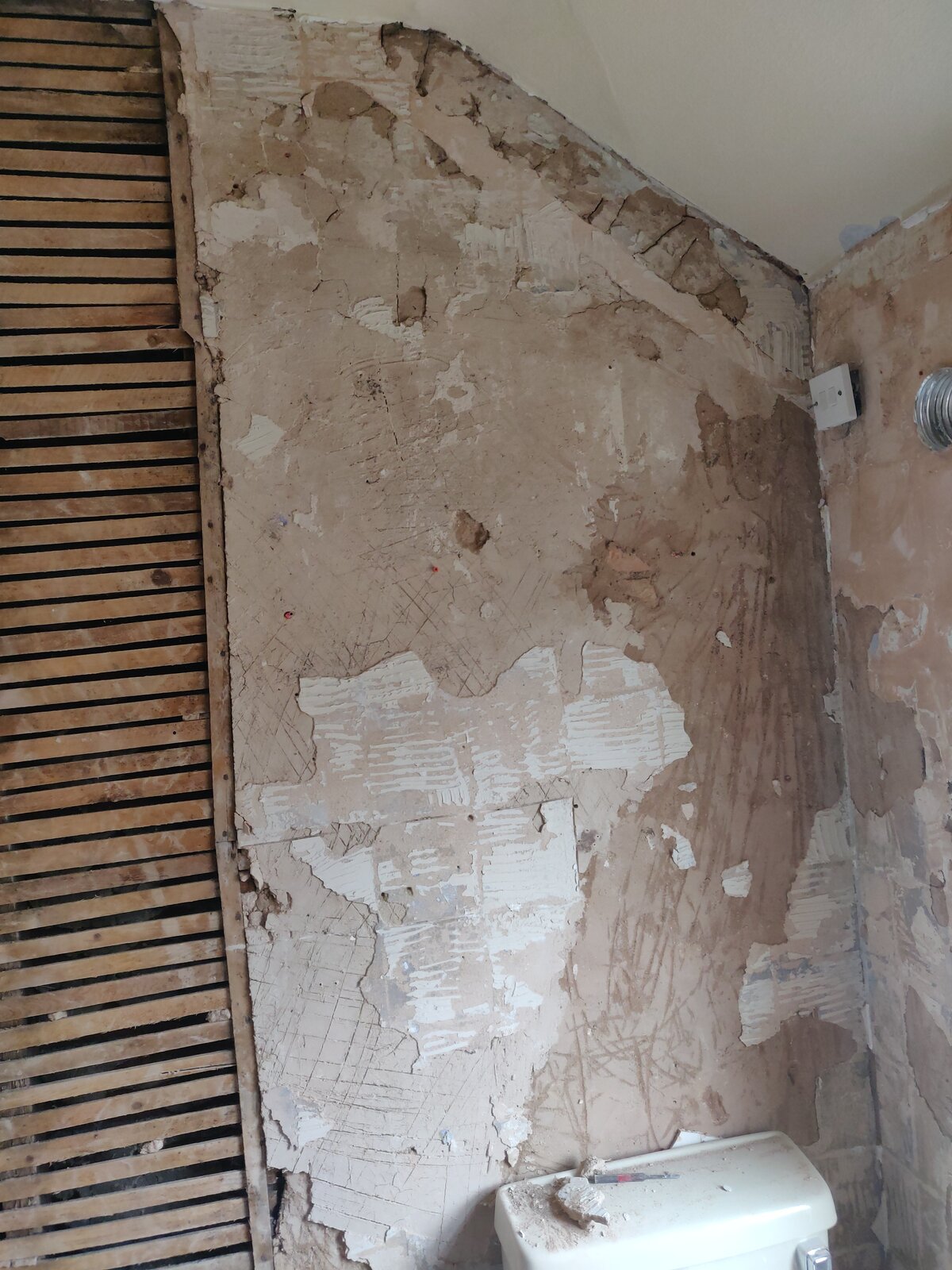

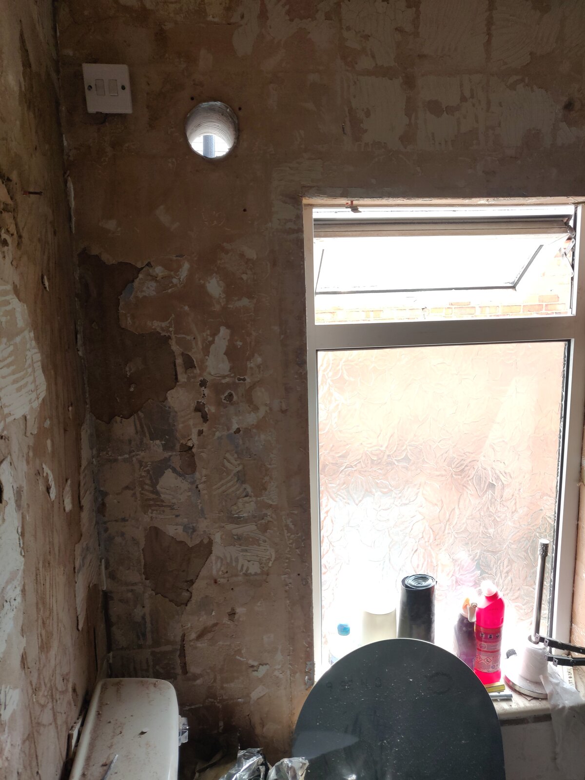

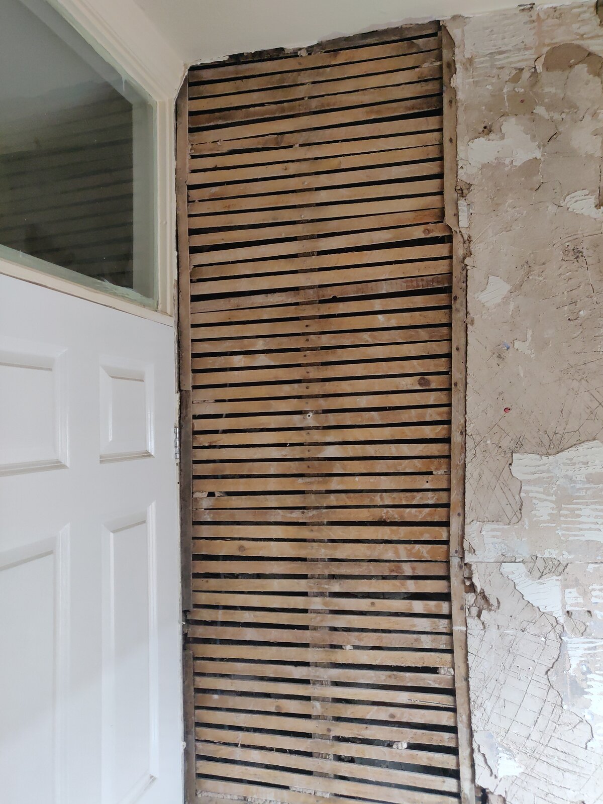

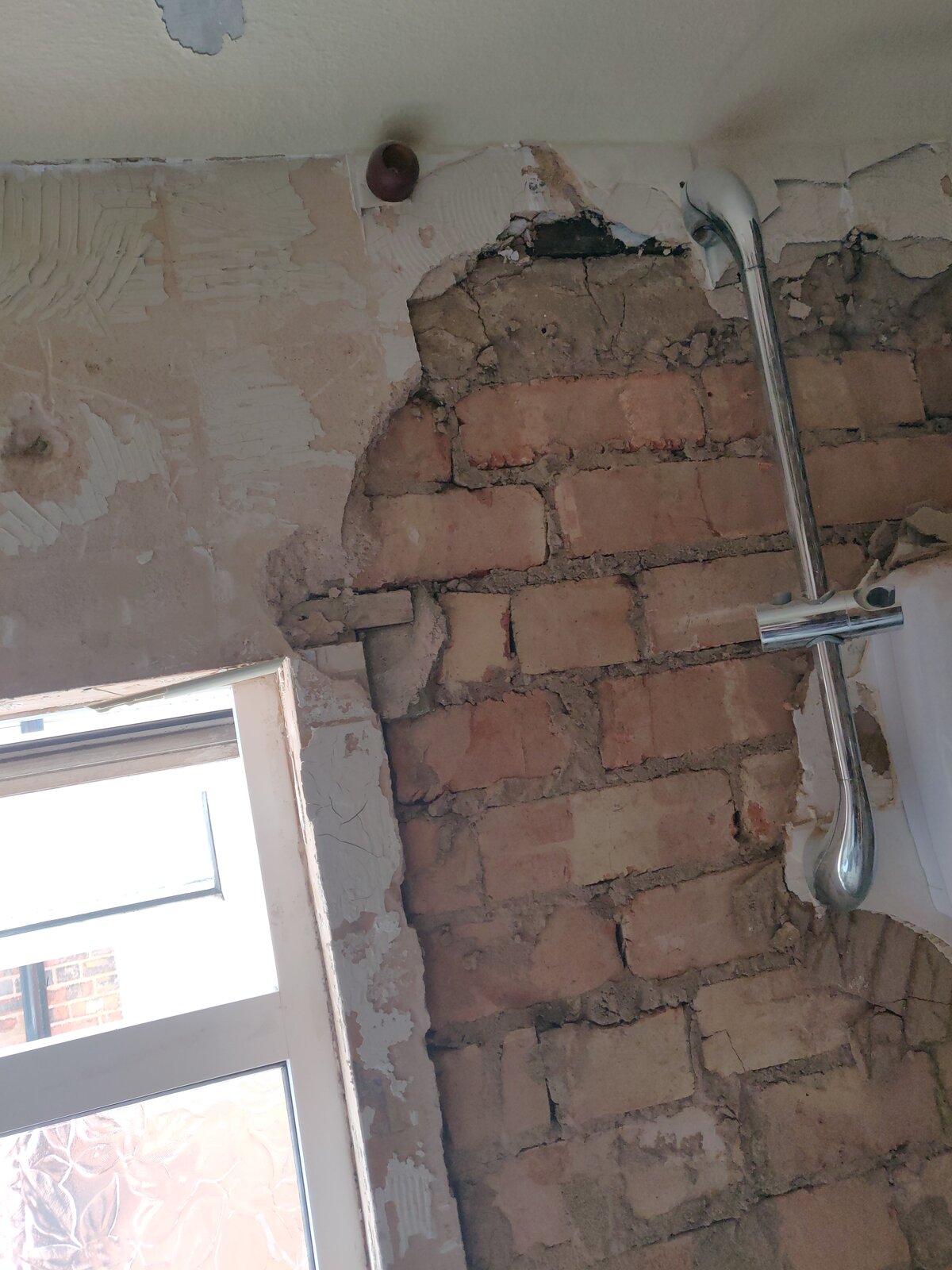

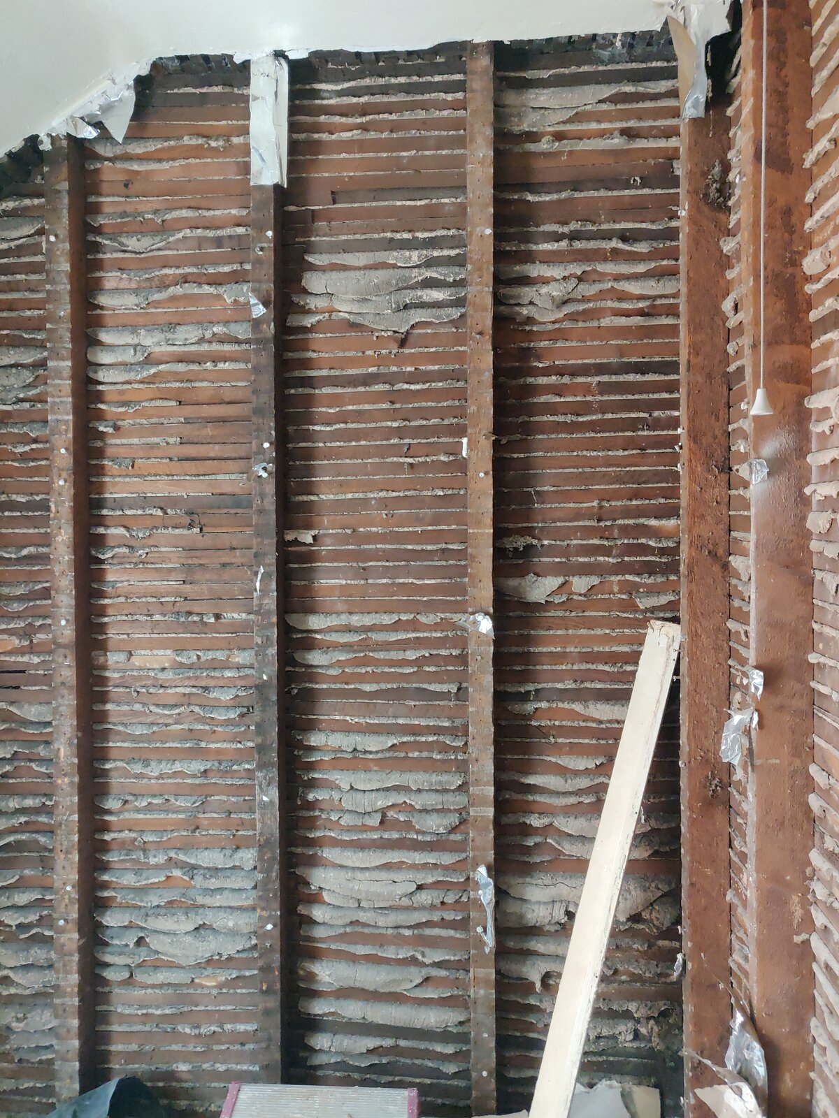

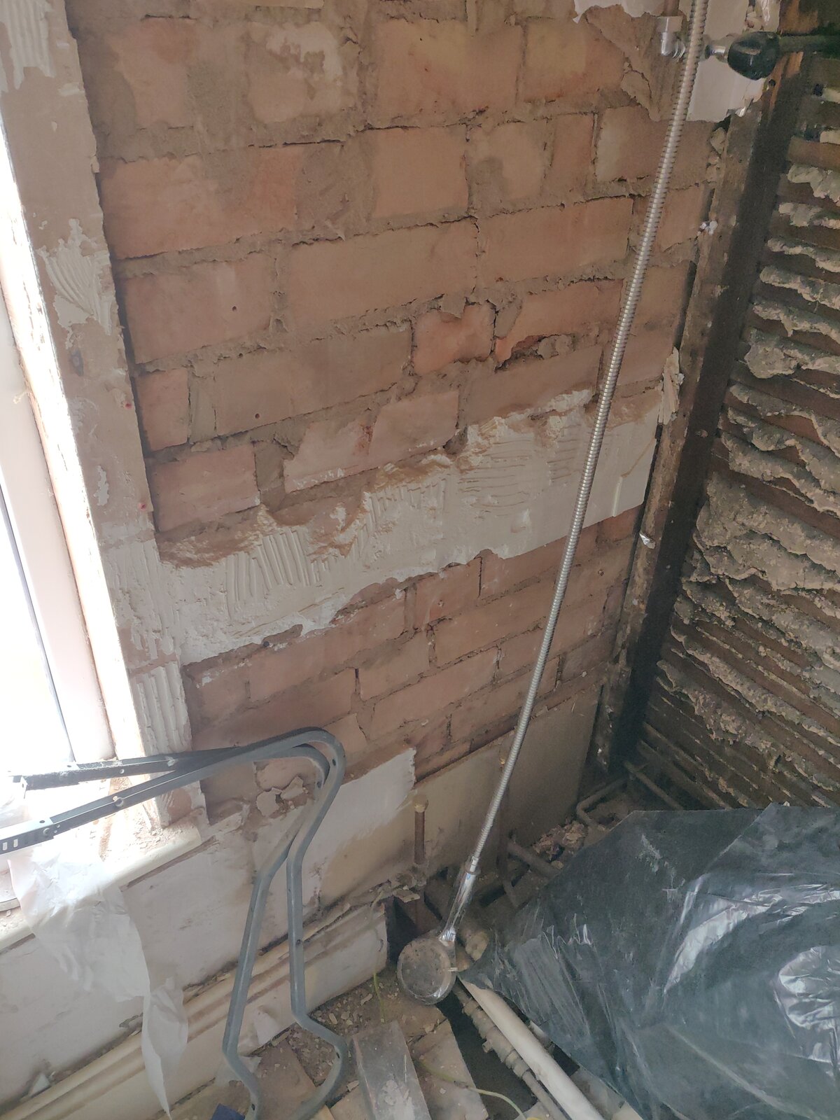

Just pulled down a load of tiles and plasterboard in the upstairs bathroom of my Victorian property. My goal is to tile it from floor to ceiling, replace the toilet, the sink and install a shower cubicle. I have in mind that I'm going to square out any non-level studs by planing off and sticking some wood onto the studs, then board up the bathroom with moisture-resistant plasterboard by staggering it on the studs (with screws) and the brickwork (dab) for strength/rigidity. I'll tape and joint the plasterboard, tank and prime it with acrylic primer, then tile over it. However...
Pictures 1, 2 and 3
One of the walls is partially studding (I've yet to remove the lathes) and partially brick - what's the best way about ensuring that the plasterboard is even considering there'll probably be a difference in depth between the two?

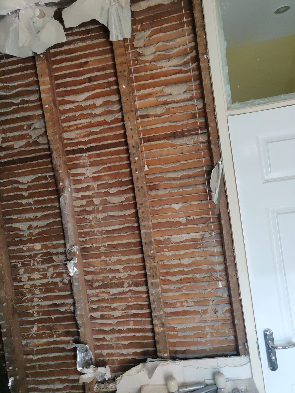

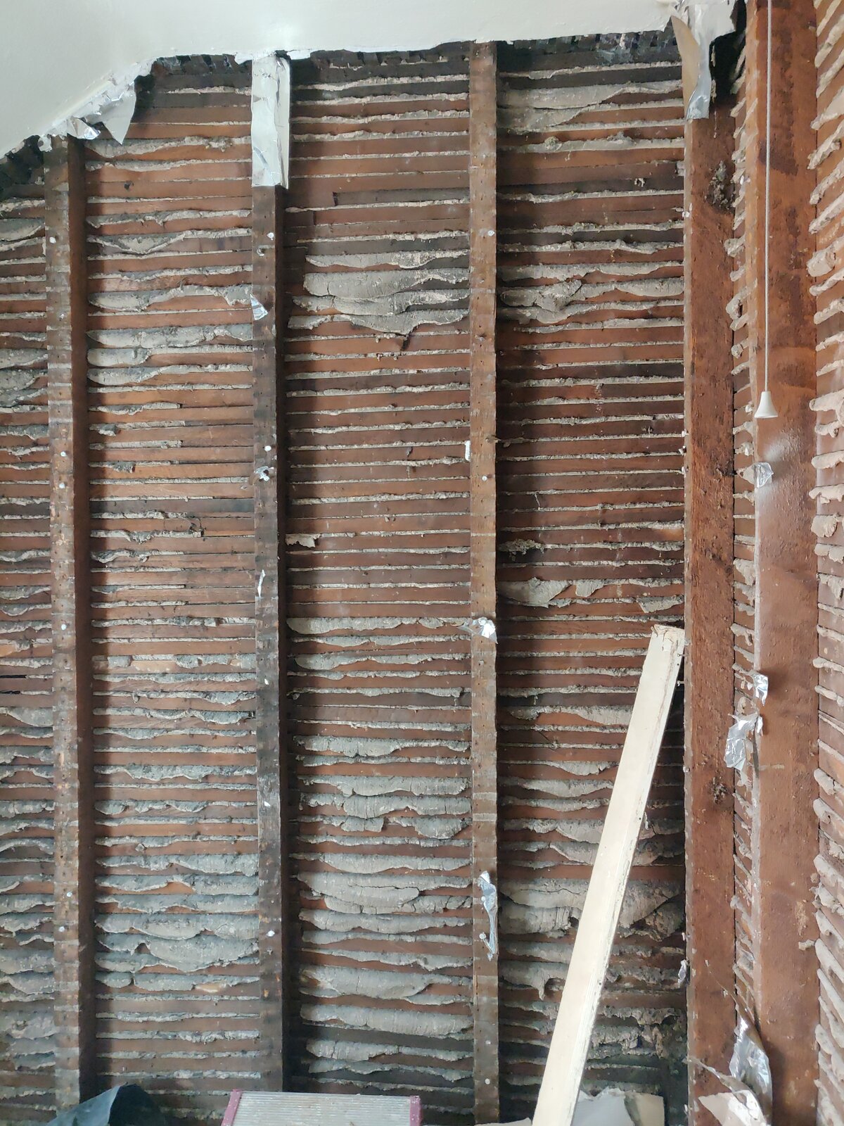

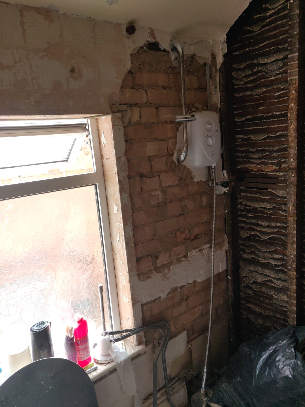

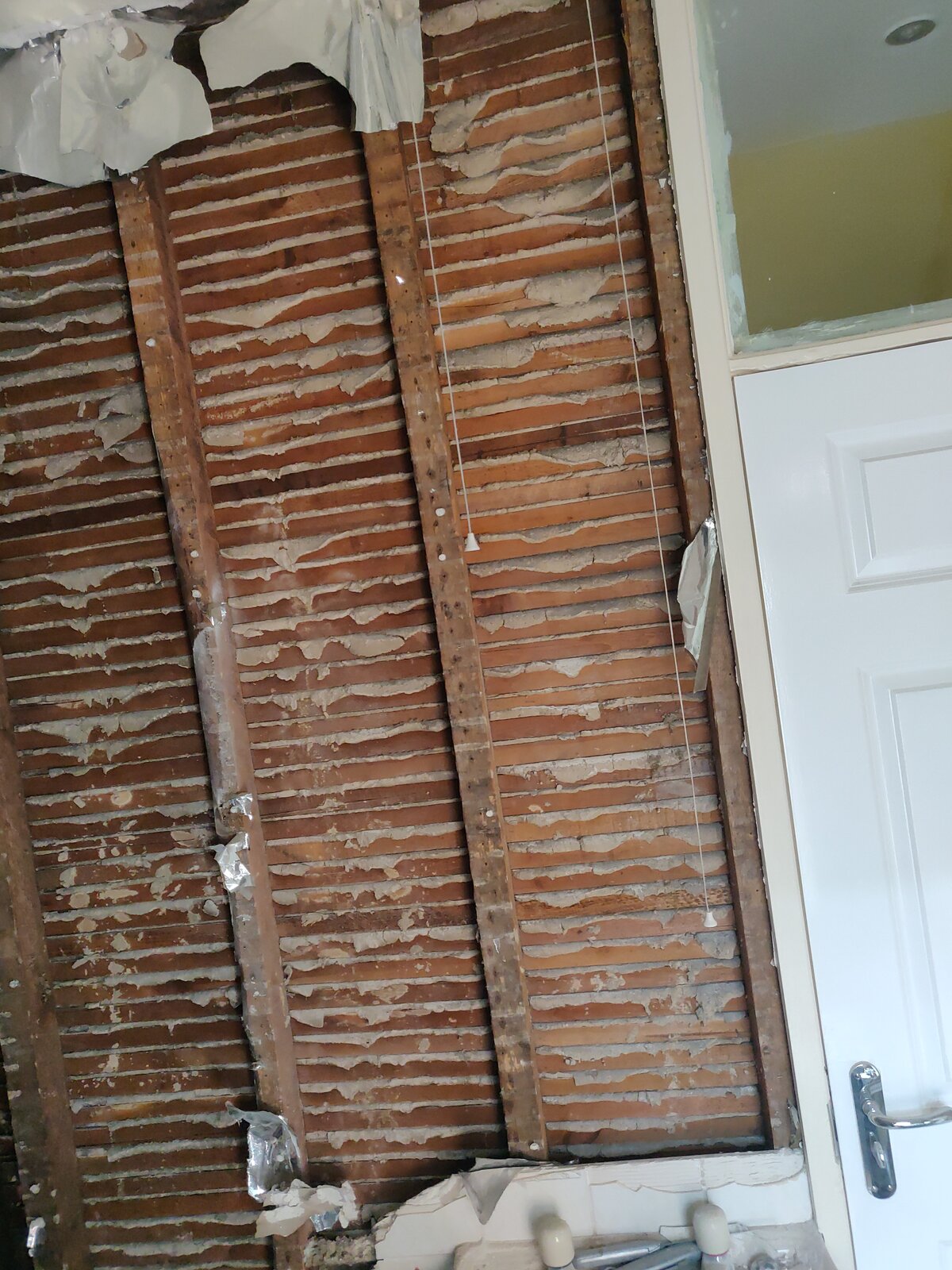

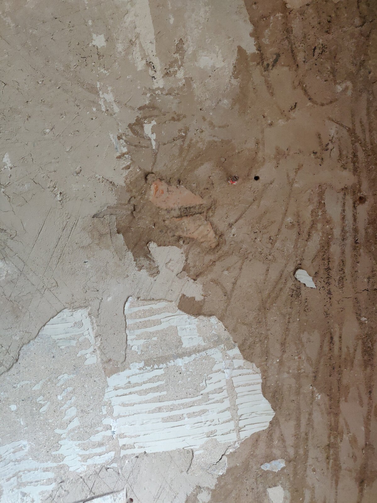

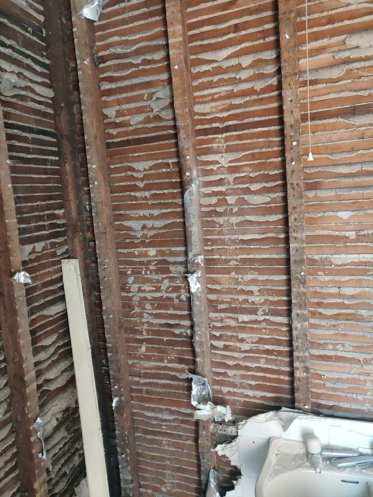

Pictures 4 and 5
I can't quite get some of the plaster off the brick walls. The other lot in picture 5 came off with the tiles - it was dead loose. But this stuff is stubborn. Should I bother removing it or can I get away with putting batons on the wall to bring the PB out in areas free of plaster?

Not a cavity wall?
Put string like across studding to find the level.
What about using elements board with foam, then screws through. Tile or plaster over.
Not a cavity wall?
Not a cavity wall no - two layers of brick side-by-side. Those element boards look decent but are far more expensive than green PB. I did consider aqualpanel/board but it's just overkill. Might consider AQ/AB/EB for the floor though. As for levelling the studs I'm concerned about differences in vertical levels between studs that would warp the plasterboard when I came to fix it onto the studs. Perhaps they all move together, however.
Fit some timber to the side of original timbers so plasterboard is vertical.
Stick board to the wood with a polymer grab mastic. Put 4 blobs on the vertical old wood to pack the gap. Add just a few screws (4 on each vertical) when mastic has dried.
I have a bit of studding roughly the same size as the bathroom studs leftover from another excursion but not enough to use entire lengths. Can I chop them up into smaller pieces and attach them to the sides of the studding tight with two screws each or do they need to be entire lengths?
