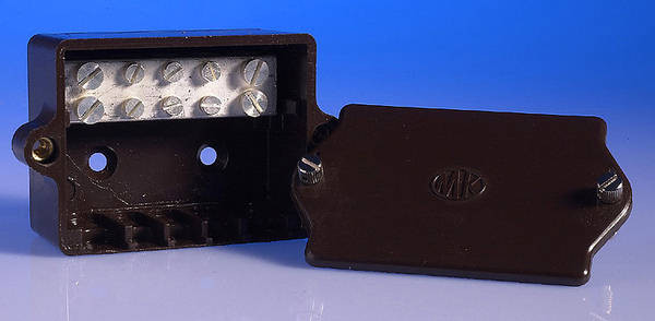

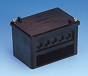

Actually, you can get them at B&Q (the big ones). They are also known as service connectors or service splitters.
They look like this:
Inside is 1 or 2 thick metal bars with holes for cables and screws to clamp onto same:
Single pole versions have 1 bar, and double pole ones have 2 bars - you will need either a double pole or two single poles, each pole able to take 3 x 25mm cables, which should be proper 6181Y meter tails:

b4 you go, make sure the "chappie" has company, you want 2 not just one
Better to buy a DP 'twin' block which takes both L & N for £10 'ish
