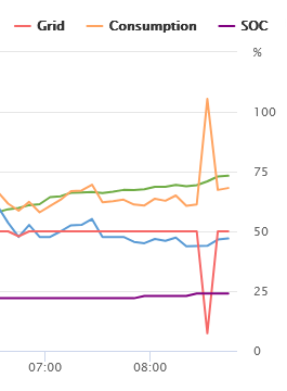

I could not tell you, when on holiday, what appliance is using what power. Total power used, yes, but just looked, 1745913081696.png and I can see something used 1kW at 8:32 am but not a clue what. Not even had a cup of coffee yet, and wife on holiday, and there was battery, so seems no reason for it to draw from the grid.

I could not tell you, when on holiday, what appliance is using what power. Total power used, yes, but just looked, View attachment 380255 and I can see something used 1kW at 8:32 am but not a clue what. Not even had a cup of coffee yet, and wife on holiday, and there was battery, so seems no reason for it to draw from the grid.
