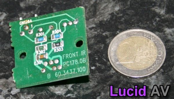

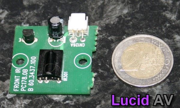

    Bearing in mind that the Beko TV is about 9yrs old, 4:3 ratio, pre-Freeview, and that a replacement new 19"~22" TV will be available for under £130 for Samsung or LG..... well I wouldn't be inclined to spend £50-£80 on a repair. If you are handy with a soldering iron and fancy having a go at repairing the IR receiver then the receiver part itself is cheap. There's no guarantee this is the fix, and it is trial and error, so you may end up stripping and rebuilding the TV a few times before you hit on the faulty component. The second bet is a bad capacitor.
    Here's a neat example of what's involved in the IR receiver circuit. This one is out of a projector, but the design principles are the same as a TV
    [​IMG]
    [​IMG]
