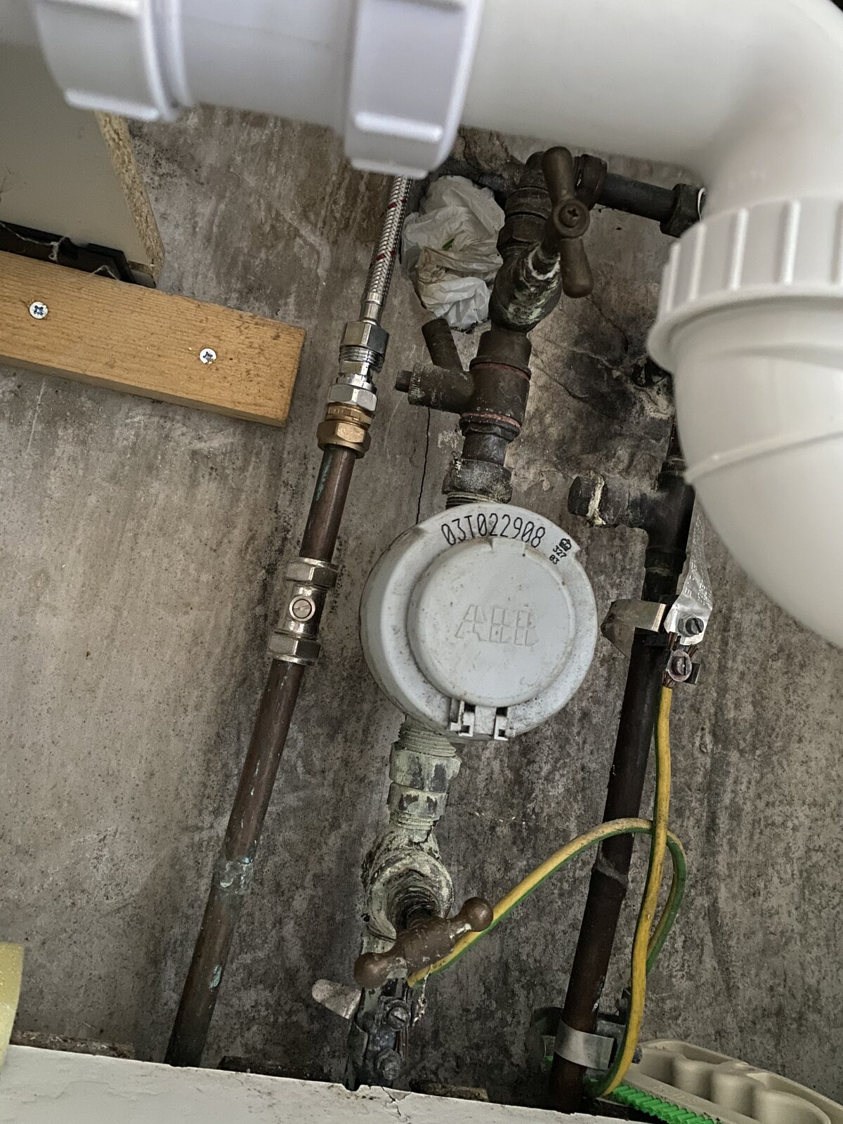

I’m assuming this is a 15mm supply but I could be wrong ! It’s clearly seen better days too.

Hard to tell from that pic, could be in 3/4" steel, doesn't look like lead. Certainly fairly aged but delivering that flow/pressure you may well find you get away with it. If replacing it with 25mm mdpe was relatively easy (no concrete to cut through) then it'd be worth doing mainly cos eventually that steel will rust out...if its a 2 grand job then prob leave it be UNLESS you still have unacceptable variations when running 2 showers (with upgraded internal pipework)
