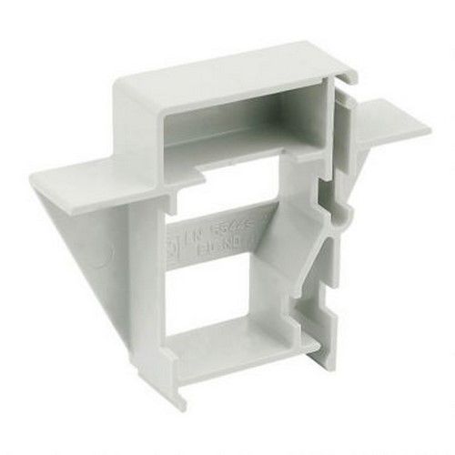

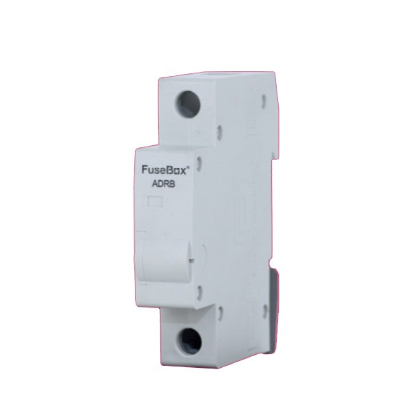

    I don't think this is a silly discussion. Blanks in CU can cause problems.
    Clip on ones are a C2 so the install would fail an EICR.
    And its a PITA when you find a CU with blanks missing, and you have not got anything in the van, its a revisit, because you can't leave a C1
    It would be impossible to carry around a din rail mounted blank for every make of CU.
    I generally have a few in the van, but most times you have to cut bits off because they seem completely over engineered
    and will not go over the bus bar. The MK one comes to mind
    The MCB type ones are good, and I don't worry about the make as long as they fit. I would not even give it a code.
    And Ive pondered, whats worse , leaving a clip in blank in place, or putting a metal twist in blank there (Plastic board), until I can return with a proper blank.
    Those plastic Twist in which EFLImpudence found, look good. Ive ordered a few, so should solve that worry.

    Is that not a matter of opinion (as per the discussion here).
    What if (as I believe is still the case with some) the 'clip on' blank is one supplied by the manufacturer of the CU for use with the CU in question - would you still give it a CU C2?
    What is arguably 'silly' is the drift/evolution in this discussion. It started with eric talking about the use of a blank (which I assumed to be 'otherwise acceptable') with which the only problem was that it was 'of the wrong make' (not 'type tested'). How would you code that? As you go on to say ...
    ... but, provided it was dimensionally compatible, would you see a problem in using a DIN rail-mounted one which was of the 'wrong make' (and, if so, how would you code it?)?

    Country:
    No problem , No code. Its just a lump of plastic

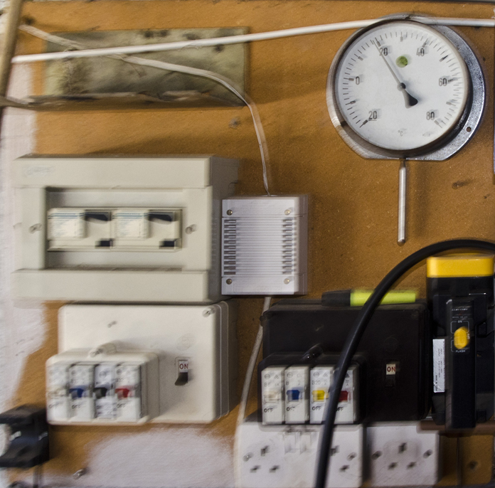

    Sorry what I was saying is if I felt the blank could be removed without a tool, then C3 rather than C2, but the old Merlin Gerin boards had switches for the MCB's so even with no blank there were no live parts to IP2X all the blank was for was aesthetics, as to if any consumer units like that not sure, even the old Wylex fuse board had blanks, but the base for the MCB was considered good enough, and when fuses were used, we could remove the fuse without a tool with a thumb screw on many covers.
    I had never considered this Wilex-board-with-RCD.jpg as potentially dangerous, even though I had not refitted the covers over the MCB's there were marked sections to knock out so they could be refitted, but most times they would break if you tried removing the section. I did not feel this upload_2021-5-3_8-15-59.png presented a potential danger, and what is assessable with MCB removed clearly has a bearing on code given, if any.
    To use metal blanks the problem is how to bond them, if a wire was to come out of the neutral bar, it could touch the blank and make it live in many cases, so in the main the metal version is out, and I am really not sure I could remove a plastic blank without a tool or excessive force. Yes blanks can be pushed in, but the whole plastic consumer unit could be smashed with ones elbow, so some reason must be used, I seem to remember the test finger to establish if IP2X does have a limit as to pressure? Seem to remember one newton or around 3.5 ounces? I can't see many blanks being pushed in with 3.5 ounces?
