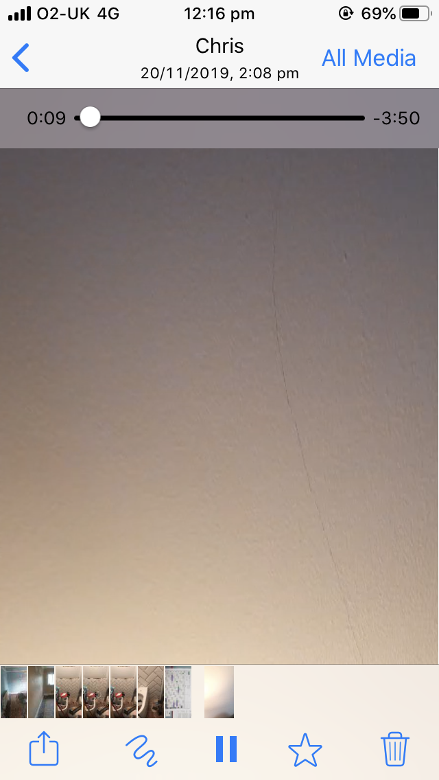

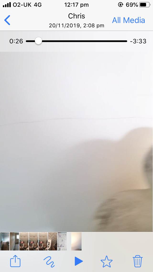

    Ive recently re skimmed a wall for some one and the backing was bonding on brick its now about 2 months down the line and its started cracking do i need to hack it all off and start from scratch or will a skim with tape over the cracks be sufficient enough

  14. roughcaster
    roughcaster
    Joined:
    2 Aug 2007
    Messages:
    4,752
    Thanks Received:
    638
    Location:
    Moray
    Country:
    Hard to say what's caused those cracks.
  15. bobasd
    bobasd
    Joined:
    2 Dec 2017
    Messages:
    2,368
    Thanks Received:
    435
    Country:
    are the first two pic cracks vertical and is the last pic crack horizontal?
    fwiw: thats a very poor skim finish.
    • Like Like x 1
