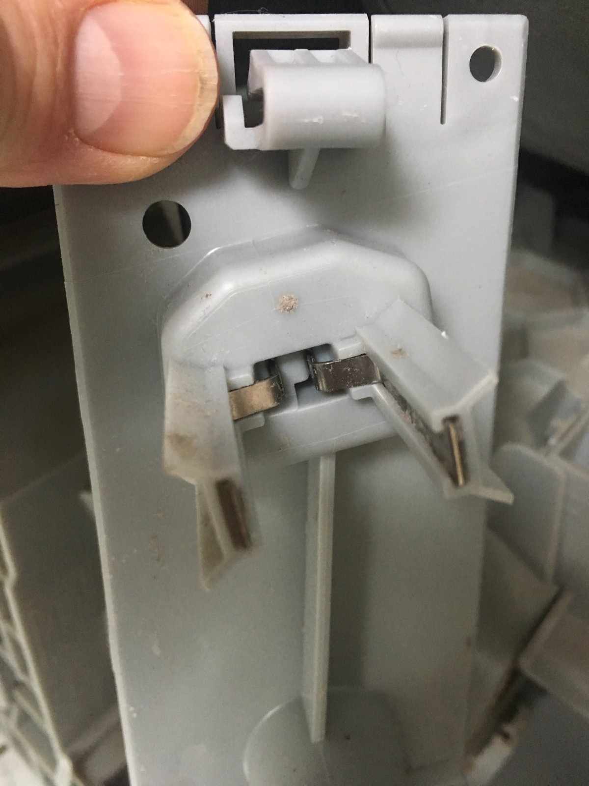

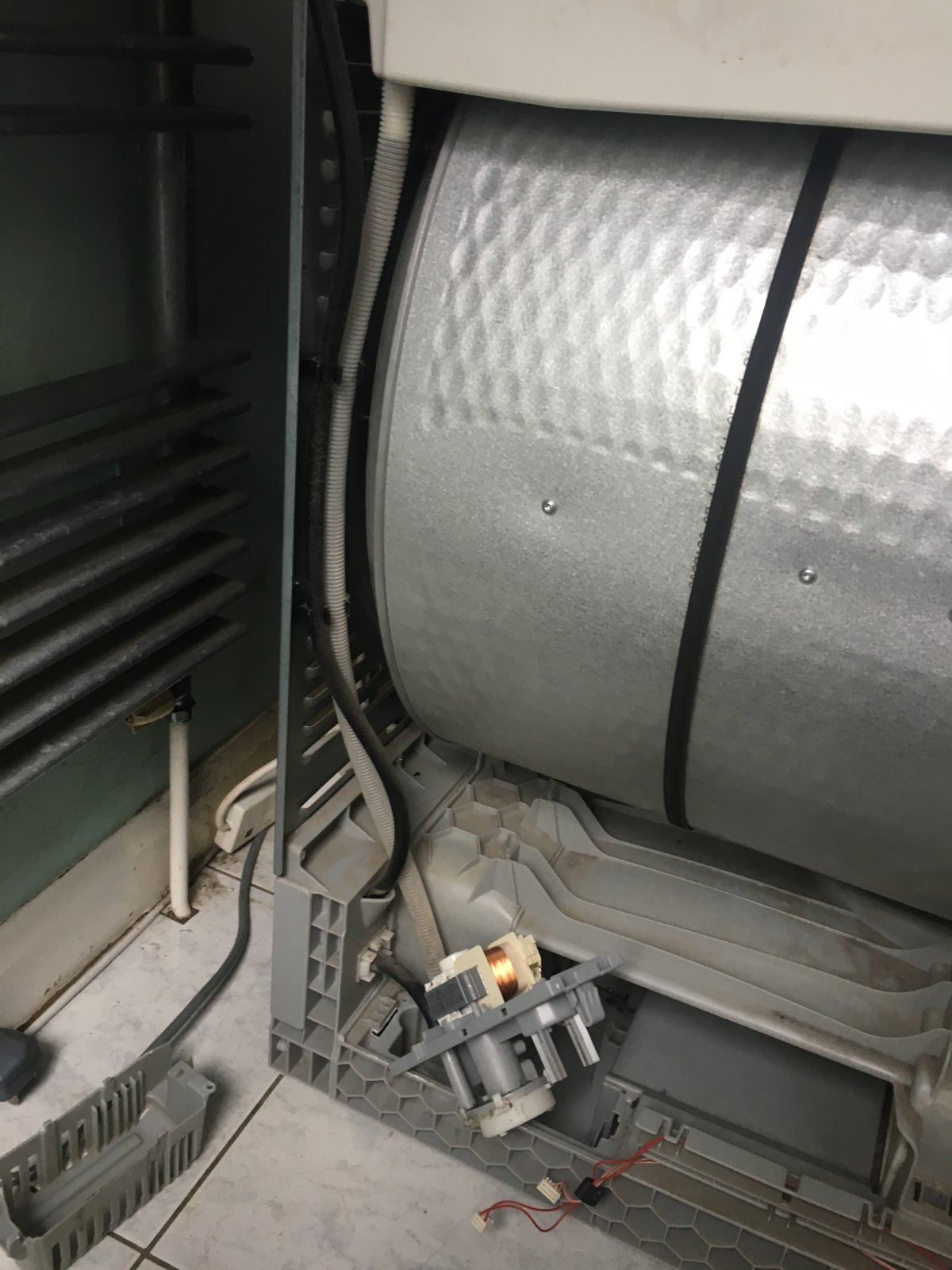

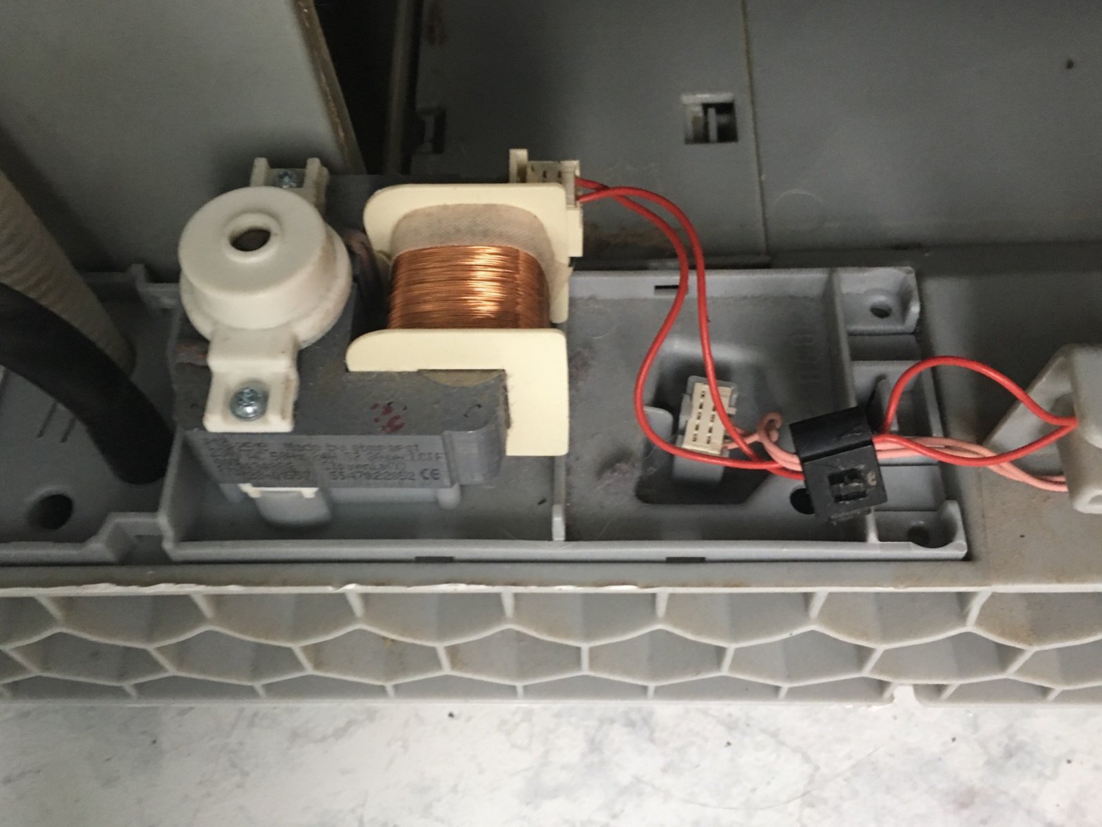

Had the same container light problem. Found the secret flap under the condenser and cleaned out the sump but the problem persisted. Solved the problem in the end by cleaning the metal prongs that extend into the sump. These has become gunked up with sludge and we’re making an electrical connection between them that made the machine think the sump was was and therefore the container was full. Had to remove side metal panel and unscrew a plastic cover over the pump to get at them which took about 30 minutes. I have attached a few photos of the location and the prongs that needed cleaning.
