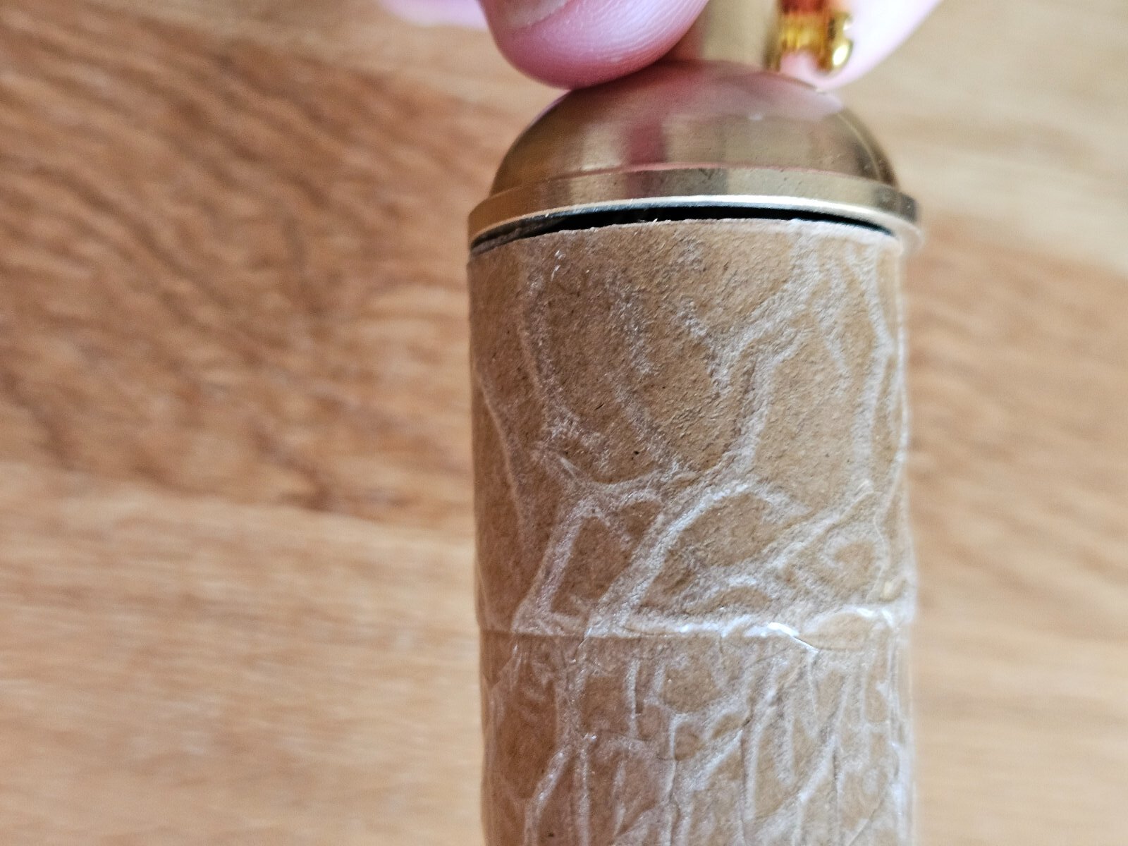

Bought a light - Does this look safe?
20 Apr 2021
55
2

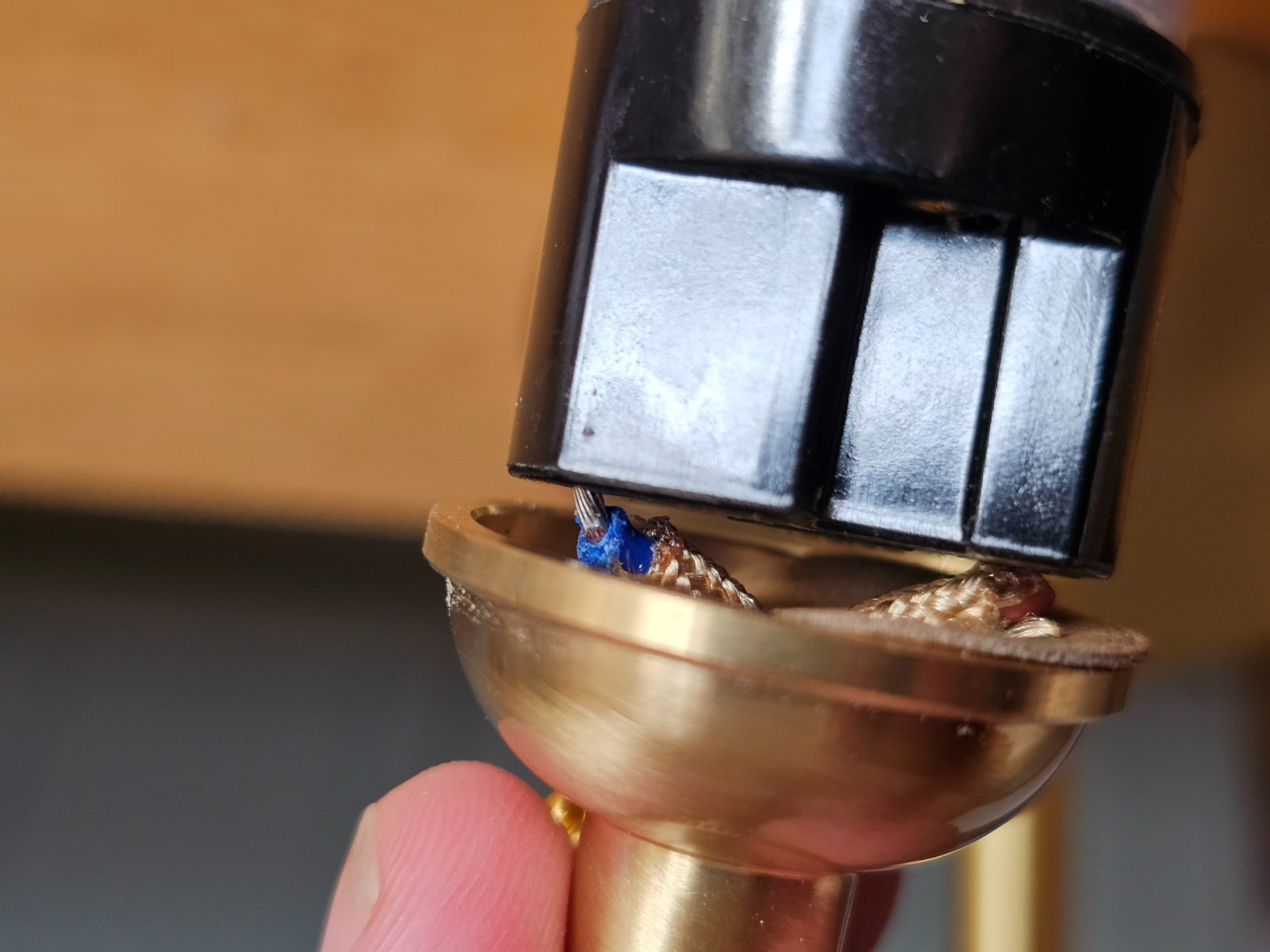

I know *nothing* about electrics.

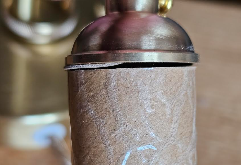

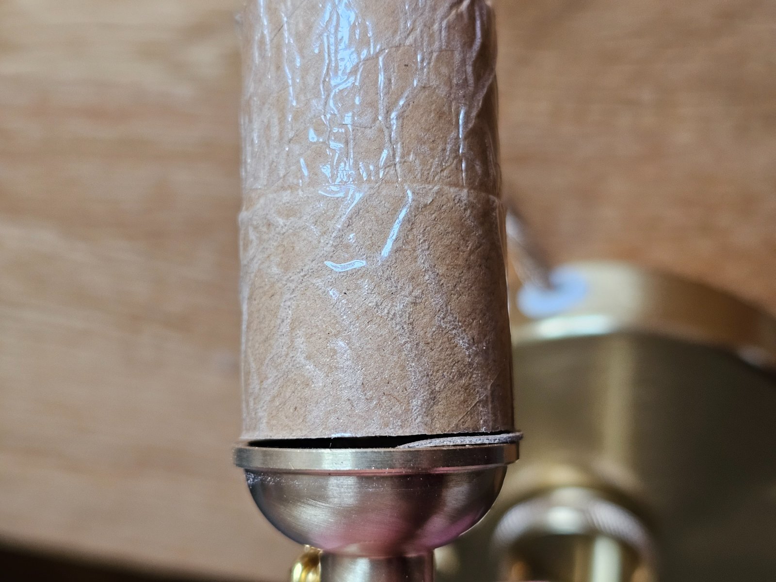

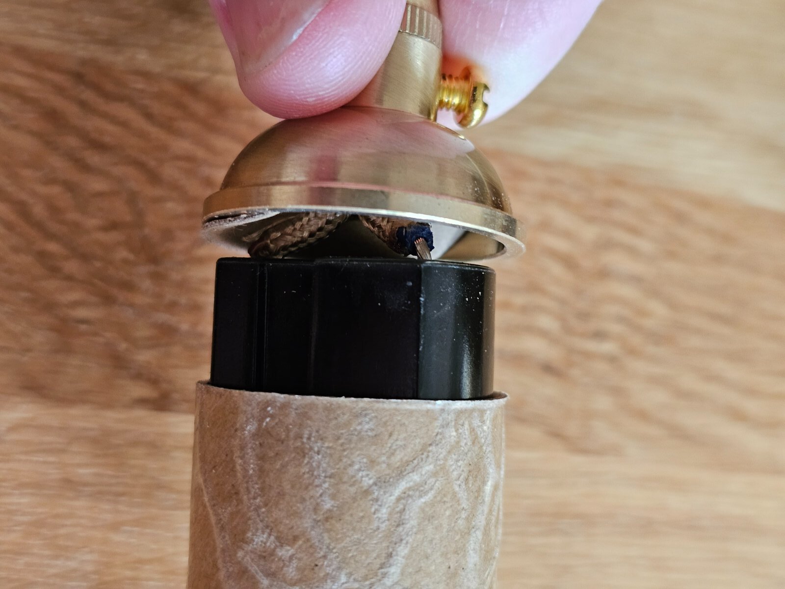

I bought a plug-in wall light. While I was attaching the shade to the lamp holder and screwing in the bulb, I noticed a cardboard tube. I assumed this should be removed, but second guessed myself when I seen the wiring and thought it might be there for a reason. This is a metal body light, so I would assume the connections would need to be kept well clear of any metal.
Does this look safe to use, even with the tube left in? Am I just being paranoid, or is it actually cheap, poorly made crap that will zap me one day when I'm switching it off?

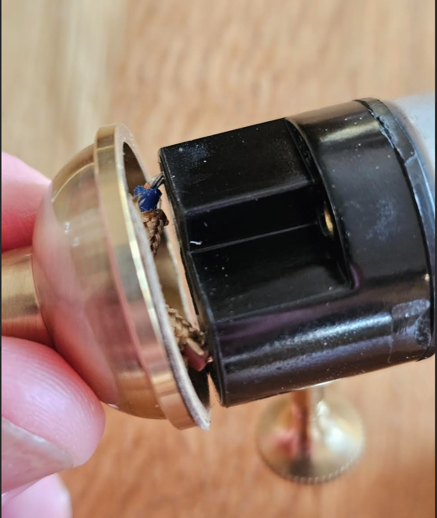

Is the cap of that lampholder make of metal? or is it plastic that looks like metal?
If the former than that construction looks like an accident waiting to happen with half-assed wire terminations only millimeters from a metal part!
Yep, that's metal. They expect the cardboard to keep the wires and metal separate I expect, like this:
But that just looks dodgy to me - hardly precision engineering.

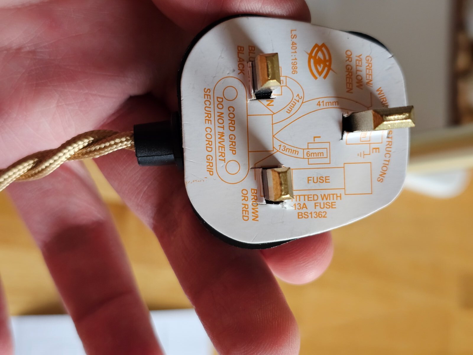

Send ot Back or bin it, crappy connections and a metal fitting with only 2 cores coming out the plug.
Purchased from Amazon:
Sent from an Amazon warehouse, but actually purchased from
Yes.
Return it as defective. Also ask them for the UKCA and/or CE Declaration of Conformity - which either won't exist or will be a pack of generic lies.
It's already failed just because of the paper label on the plug stating a 13A fuse is fitted.
a cardboard tube.
Cardboard is still used on certain light fittings, mainly USA affairs rated for 120V where product standards still contain what most of the world got rid of decades ago, quality control involves sending a few specially prepared items to UL, and consumer rights regarding defective products is non-existent.
I would say it's a battery lamp someone has stuck a plug on.
That's exactly what it is, they sell the same item as battery powered where the lamp is rechargeable and the switch/lampholder/cord are decorative only.
