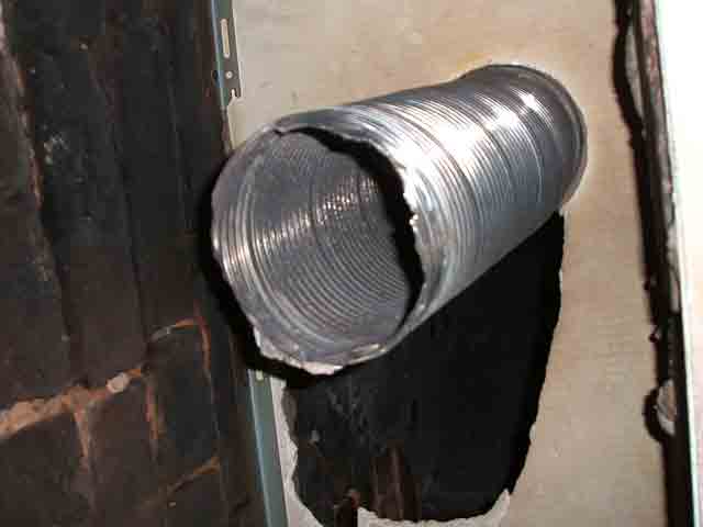

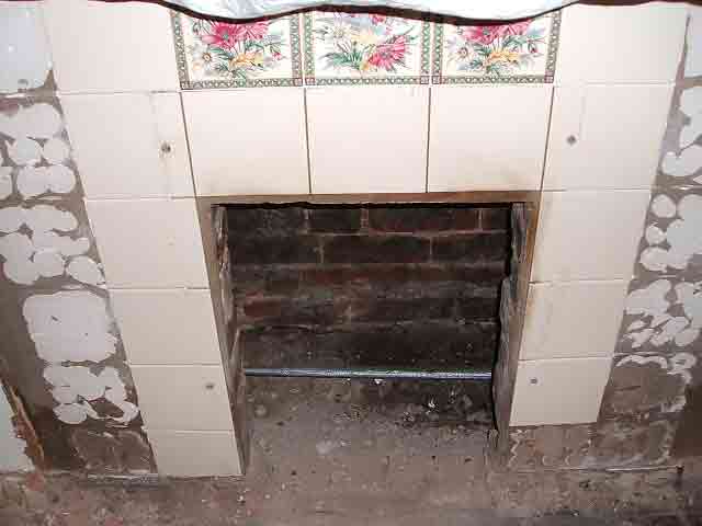

pic 1 shows the open fireplace
pic 2 shows the inside of the fireplace pointing upwards showing the flu liner
pic 3 is the TV I want to put in there!

Judging by the 2nd photo you should be able to shine a torch and check if there is an original lintel in there and if so it could be possible to widen the opening.
I'm not sure about this because my TV instruction does say the TV should be 12" away from the back of the wall (not sure what gap on the side of the TV) to prevent overheating. I thought I mention this to you.

You should be able to see the lintol, in fact, is that a steel edge i can see on the right hand side of pic 2?
Now you no longer have the "borrowed "heat from the flue liner you should vent the flue top and bottom and at any c/breast in the room(s) above. This will help prevent sulphurisation damage to brickwork and plaster.
Sulphurisation can often be seen as a sooty flue outline on the gables of old houses and your flue is soot encrusted.

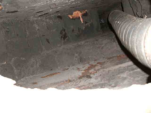

Tuck the flue liner up above the damaged closure plate, dont cut it. A new plate will be reqd. You will also have to remedy the sooty fire back etc. or the TV area will be contaminated.
Please see pic 4 above........
This was taken through the crack of the closure plate, I can't see any lintel I don't think!
