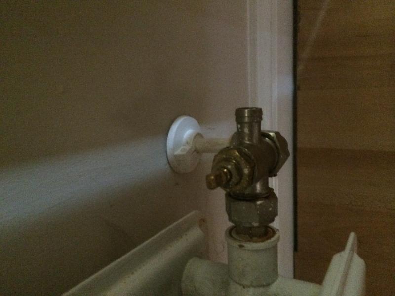

Hi All,

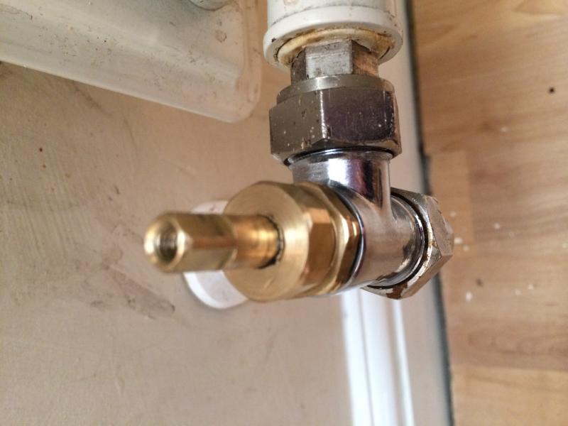

The lock shield was leaking on my rad and was not heating up, had BG out today and he replaced it, can the new one BG installed still be turned off like the old ones ? or have they gone cheap on me and I'm unable to turn it off ? the new one has a screw on the top of the plastic that I've removed but then it looks like it's just a stem coming up that can't be turned to turn off ? or am I wrong ?
I've taken a pic of the valve that was on there as it's all other rads, on the new one that he's replaced it with , the rad is not getting hot and he said they want 1K for a power flush but if I go for the 1K power flush they will throw in a free hive, one other rad is not working but he wouldn't even have a go to get this hot as put in down to sludge and it's not covered in the service contract, after saying that was a crazy price he dropped it to £850 with a free hive but that's still way out of my price range.
I was going to take the 2 rads off that are not working and take them in the garden and hose them through but he said that would not change a thing as the blockage was in the maniflold, this could be BS but I'm going to give it a go. I need to take the rad off that he installed the new valve to blow this through, but am I correct in saying this now can't be turned off and the system has to be drained to take that rad off ?
new valve looks like
old looks like
Thanks in advance for any help

If the 1st pic is the new valve, then remove the pozi screw, which will allow the plastic to be removed, whereupon you will see the brass valve, which you can screw down.
The drain off point on the 3rd picture is on the system side of the valve, so you couldn't drain of just the rad from that, anyway.

Rad was not heating up prior to valve change, on the old valve there is a flat part at the top and if I turn this with a spanner this stops the flow into the rad...
But on the new one fitted today I remove the pozi screw and then the stem that sticks up is nothing like the previous one, there is no flat part at the top to get a spanner on to turn off, see the pic
So am I just being stupid and it is possible to turn this off ? or is it a valve that is constantly on and you can't stop the flow ?
Two second fix.....BG lockshields come with the option of either a blank cover like the one on yours or a handle type that can be used to turn it on or off. Would be ****ed off for the recall but call them back to get the other type.
Why cant he just use a spanner to shut the valve off ? he wants to remove the rad it does not need to have a different handle type.

yeh sorted with a spanner, thanks all for your help guys
