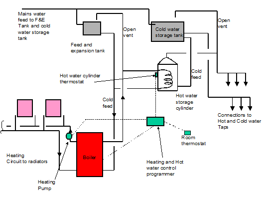

Hi, looking for some advice please, my hots water copper tank has burst last night, my insurance company aren't interested because there is corrosion at the bottom pipe. I have drained the water from the tank through little tap and the header tank is empty now.. my question is do I have to drain the water from my 5 radiators (single storey bungalow) or can I leave them, many thanks in advance

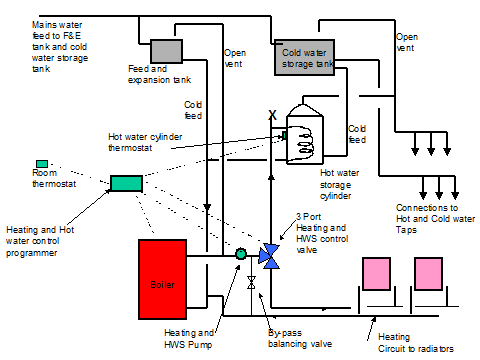

Hi Harry I have a back boiler so my radiators are connected, so that means yes I need to drain them does it?
The water from the big cistern in the loft, feeds cold water into the Hot Water (HW) cylinder, that is one system. The HW from the back boiler, that heats the Central Heating rads (CH) also feeds up into the coil in the middle of the cylinder, that then heats the cold water in the cylinder for the HW. That is the second system, they are separate.
To replace the HW cylinder you need to isolate and drain both so you can disconnect the cylinder fully. 1st system drain's the cylinder itself, 2nd system drains the cylinders coil so that can also be disconnected
With a back boiler then there can be 2 different systems that the CH uses to get the HW up to the cylinder, either gravity or fully pumped.
TBH, unless you are familiar with these types of system and have experience with them then you may find it difficult to get the work done properly. It really would need a relatively advanced DIY'er to get it right, even some pro's wouldn't be able to do it.
