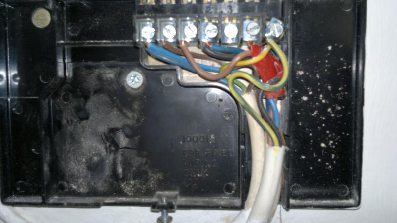

old wallplate (sm300) in situ

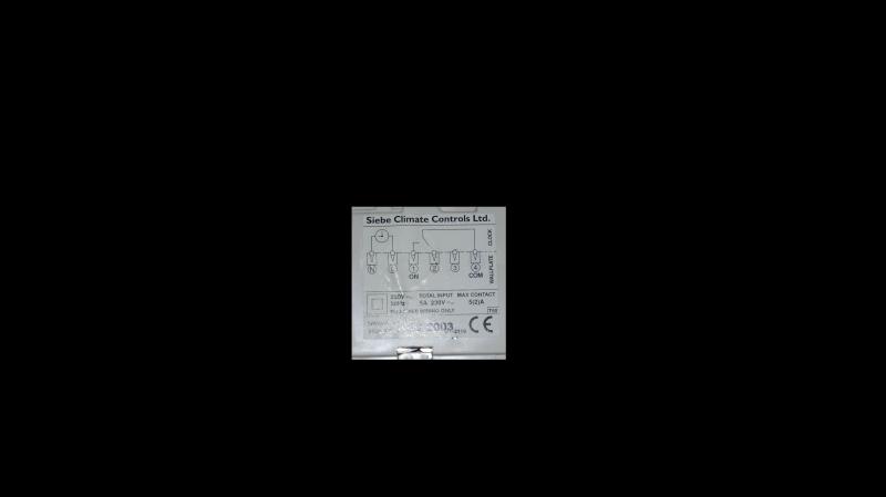

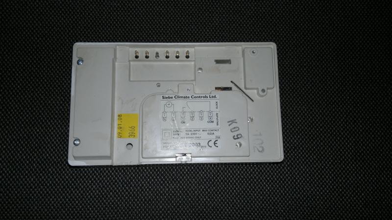

SM300 wiring diag

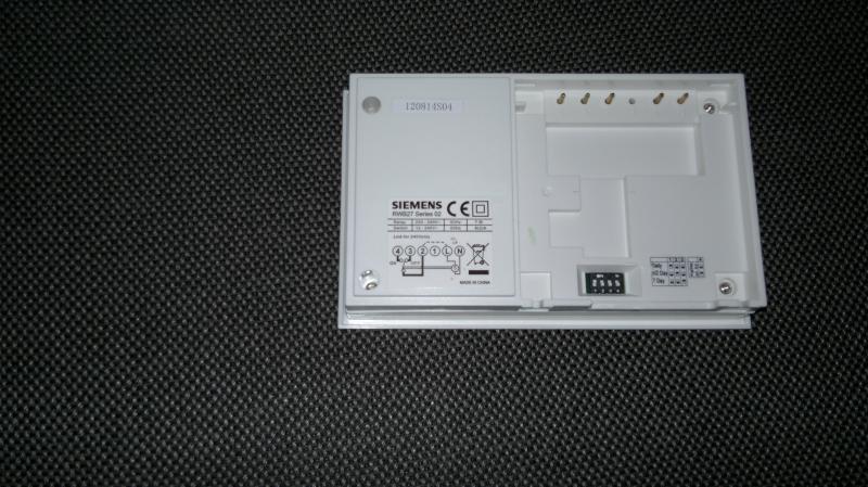

RWB27 wiring diag

Cable 2 blue (with red tape on) goes to No 2 which is a spare (no pin on back of sm300)
and the Brown goes to No 4

The terminals on the switch master are
L & N
4 Is common,
1 is on
Terminal 2 is being used as a connector
Your RWB27 terminals are
L & N
2 is common
4 is on
So just follow DIA's earlier post

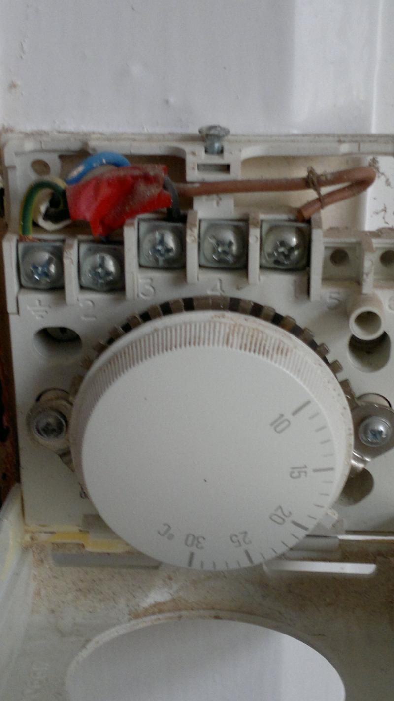

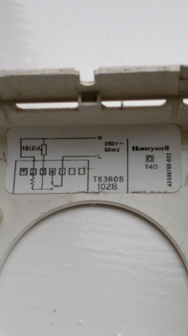

The cable in the Honeywell Room stat is 4 cores which presumably means its Cable 1 as there is only one 4 core cable at the SM300 timer switch and it has the same colours. Inside the room stat the Blue is on No 2, the Black (with Red tape around) is on 3 and Brown on 1 (which is actually 5th screw from left) then there’s the Earth.
The connectors in the stat, from left to right are: Earth, 2, 3, 4, 1 . . . 5 and 6 are empty.
wiring diag inside stat lid

Cable 1
Brown to 4
Black(red tape) to 1
Cable 2
Brown to 2
Blue to 1
Cable 3 L&N
Just follow the above.
The blue in cable 1 goes to N as before
Or if it's easier.
The old 1 goes in 4.
The old 4 goes in 2.
The old 2 goes in 1
L&Ns are the same
