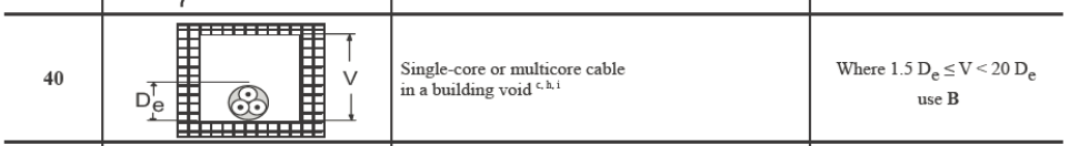

Does that mean that you think that a stud wall qualifies as a "building void"?
If so, then most cables in a stud wall would satisfy those figures for Method B - but that would mean, for example, that the CCC of 2.5mm² T+E in such a location would only be 20A. Do you really believe that? (as I've said, I've also presumed Methoid C, hence 27A)>

Only if the dimensions are smaller as those given.
What I was meaning is that larger dimensions do not mean Method B so what else is there? Method C or E?
I'm not sure what you mean. I don't know what to take as the 'diameter' of 2.5 mm² T+E. The (my :-) ) table in the wiki says that it's about 10.3 x 6.0 mm, so let's take the average, 8.15mm. That means that the stated conditions for Method B would be satisfied for stud walls with 'voids' anything between about 12.2 mm and 163 mm - which I imagine would encompass virtually all stud walls.

Put some numbers in for me in case I have it wrong. Assume D = 10mm:
with D= 10mm, the 'void' would have to be between 15mm and 200mm wide
Not wide but high. There is no mention of width. ..... Would a stud wall not have more than 200mm. between noggins?
Ah, we were interpreting differently :-)
It doesn't actually say whether it's talking about height or width, but I suppose the "V" is a bit of a clue! I was assuming that the cable was travelling vertically, not horizontally, and the "V" was therefore width!
In that case, the question is answered, isn't it - as you imply, a cable in a stud wall would never satisfy that requirement, so we seem to be back to my original point - that, seemingly amazingly (for such a common situation), the regs seem totally silent about the CCC of a cable in an uninsulated stud wall.
That being the case, I'm inclined to stick with what I've always believed - that it is Method C. It's almost 'in free air' (E or F), so assuming it to be Method C may well be a little'conservative. What do you think?

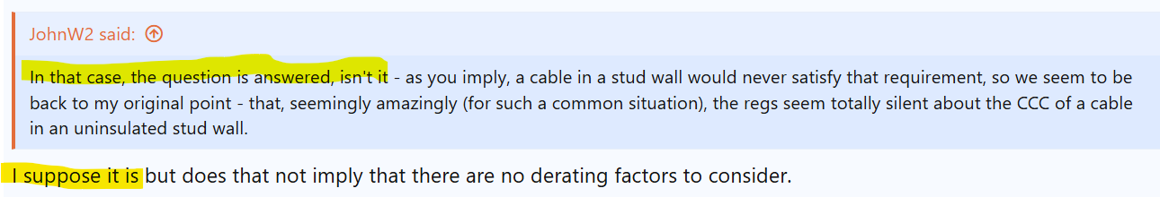

I suppose it is but does that not imply that there are no derating factors to consider.
What is it that you "suppose". If you're talking about the stud walls (without insulation) I'm talking about, I think it pretty unlikely that any 'derating factors' would often apply, isn't it?

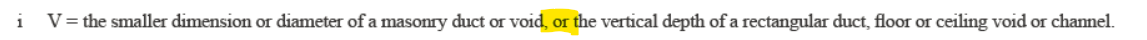

Having said that, I don't really understand the definition of V:

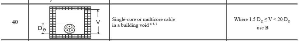

As I said, I misunderstood and, as you have pointed out,Installation Method 40 clearly only applies to horizontal voids/ducts, that 'V' is a vertical dimension and they don't mention (horizontal) 'width' - so 'narrow enough' does not really apply.
What I don't understand about Installation Method 40 is that is says "WHERE <dimensional requirements> use B" - so, even if it is a horizontal cable run, what Reference Method does one 'use' if those dimensional requirements are not satisfied?
Well done for finding that (I didn't, but will look!) - but, again,it clearly only applies to horizontal cable runs.
