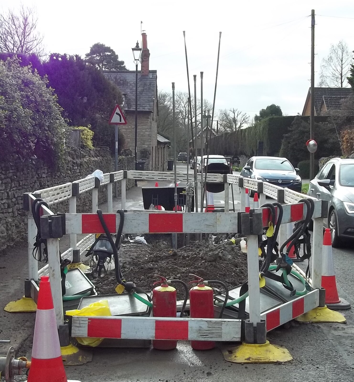

    I had believed natural gas was heavier than air and thus would settle in the bottom of a trench. But no I am corrected.
    But even so when gas mains are being replaced the safety vents for any gas leaking from the work are much higher than the road surface.
    Also comms engineers ( OpenReach etc ) are required to have gas alarms in place when working at a 18 inch deep inspection chamber even when the chamber is fully open to atmosphere.

    If it always rises then the vent pipes need not be so tall. ?
