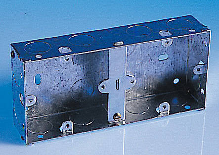

You can compose an item such as you describe from accessories already available and put them side by side in 1G boxes.

Or even in a dual box
but then you've got to get 3 fat cables into the outlet plate..
Oh! Your famous steel dual box!!
You would probably need a 47mm box for the cooker, yes. In this instance, single boxes come into their own.
Anyway, you can't call them fat, you have to be PC!
How about pleasantly plump?

Didn't think about the depth - you're right - it'd have to be two singles.
