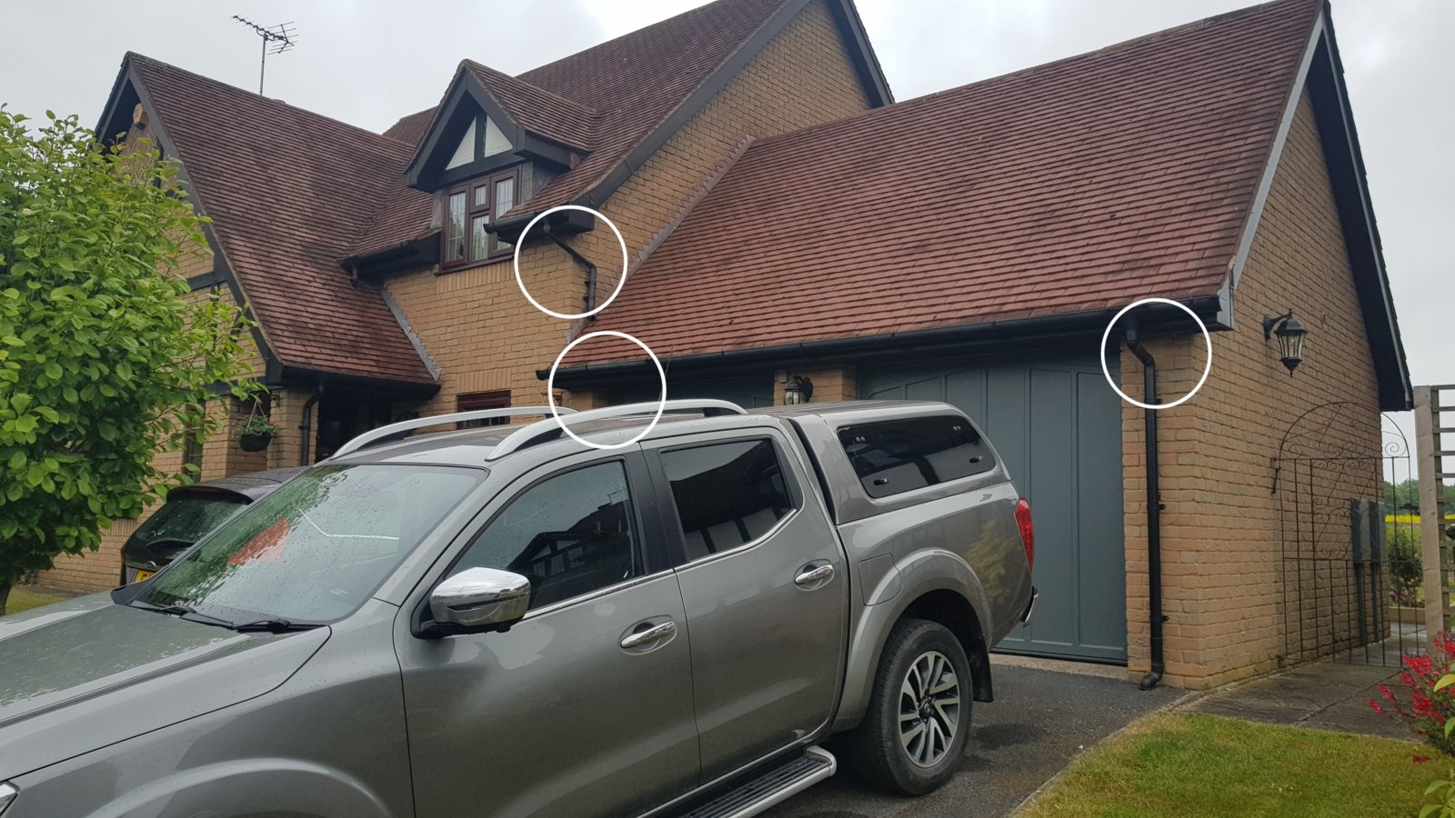

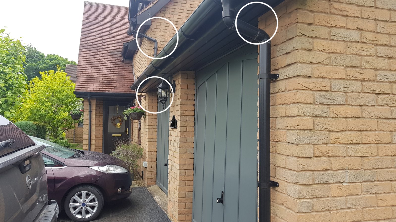

Any chance of some camera suggestions to cover this scenario? The idea being to cover the garage doors...
Possible side of house or garage sofit?
