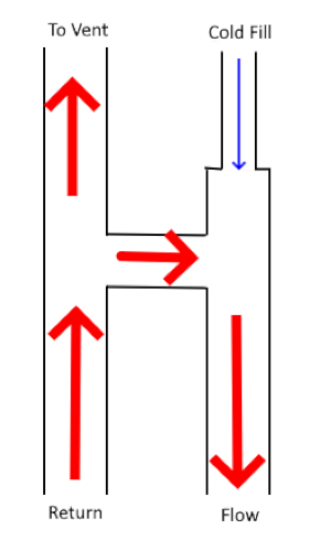

Put photos on showing your existing setup.correctly piped it should not have the issues you are describing.

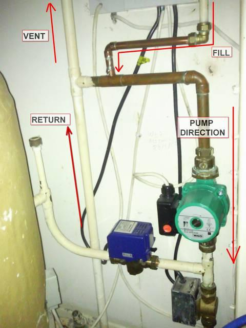

Is the pump downstream of the deaerator?
This is on the LHS of our airing cupboard on the first floor. It's about 30cm below the ceiling, and is the highest point in the system.
1) From the boiler.
2) To the vent above the F&E tank in the loft.
3) To the pump. About 30 cm down the pipe.
4) From the F&E tank in the loft.
Circulation is clockwise in this, so the AAV is upstream of the pump, which I gather is a bad thing.
Was installed around 1990 using cheap parts. Boiler and pump have been replaced in the last ten years. Everything else original as far as I know.

Just so I'm clear, we're talking about this when we say "H section"?
Vent goes up to above the F&E tank and bends over, so air gets out there, and so does any water if there's a problem? Fill comes after the vent, but before the pump? Am I getting it?
The space is a bit limited and I don't really want to do the whole airing cupboard. Would this work if I made it out of a couple of 22mm Ts, a short length to get the crossbar spaced properly, and a 15mm reducer for the fill? Distance from return to flow pipe-centres is about 5cm.

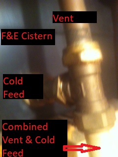

As one lager seller famously says, probably, its a true H.
But I've seen cases where that very accepted close coupled setup still gave problems with pump over/air ingress even after all new pipework like yours was installed, no idea why, and was only cured by converting exactly to my over 50 year old system with some rads > 40 years old., its the combined vent and cold feed but combined high up just at the F&E cistern,
Have to say while that's obviously fine on your system its certainly not a universal cure.
I've seen many system with that arrangement some are very clean others some of dirtiest systems you have seen.
I've seen the tee blocked with debris.
Also notorious slow refilling system.
