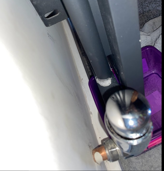

I ran the heating system today just to circulate the cleaner one last time but then one of the rads sprang a leak at the bottom (I had turned the water temp on the boiler a bit) one of the vertical riser pipe weld joints, it looks like a pinhole and the paint had bubbled off (Ill try and get a photo)
It was leaking in a stream rather than dripping, only luck that I saw it!, its isolated now.
So it seems the corrosion has done this (in my mind too much coincidence to be a fault)

difficult to photograph but where the paint has bubbled off is where the leak came from. (vertical rad, bubbled off on rad itself at the weld junction of the riser pipe, a few inches from the trv)

The supplier I spoke to will replace the rad, if they dont want it back will cut it open to see what its like inside (I know the guy who is local and never heard of them failing and sells them every other day )
My main concern is the fact that others may follow and Ill end up with a severe water damage after just finished doing everything.

If it was neutral then it probably isn't aluminium corrosion, so it must be quite severe corrosion in the radiators, it needs to be pretty bad to create that amount of hydrogen.

Your leak though may just be down to poor manufacturing, a lot of these bespoke rads unfortunately are imported & made from low grade metals and inferior construction/quality control.
