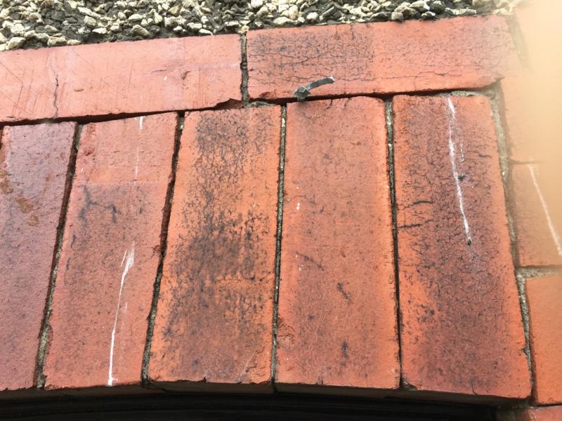

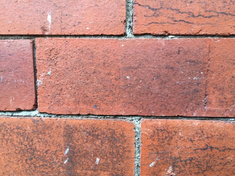

Hi Guys got a band of 2meters of engineering bricks at the base of the house and I want to clean them up and make them look great and red again.
1 Should i use brick cleaning acid first with a stiff brush or wire brush
2 should I use boiled linseed oil to then rub into the bricks and should you dilute the linseed oil or use it neat.
3 should I bag rub it instead of using the linseed oil and when bag rubbing what mix should I use to get the desired affect
Thanks for your help
Cheers Phil
don't use a wire brush, you will scratch them. Careful repointing will improve the look a lot.
They are quite a nice brick but I think not engineering bricks.
If you come across a loose one (during building work, perhaps, or from a similar neighbouring house) see if there is a name pressed into the frog.

We don't see them much down here, though Staff blues are often seen on railway work. A harder brick generally has a harder mortar, and at a previous house I had, of that era, the original was lime mortar with cement pointing, but people argue that it is not right and some would not believe that my family had lived there for four generations and it was original when exposed. I don't know about linseed on bricks.
