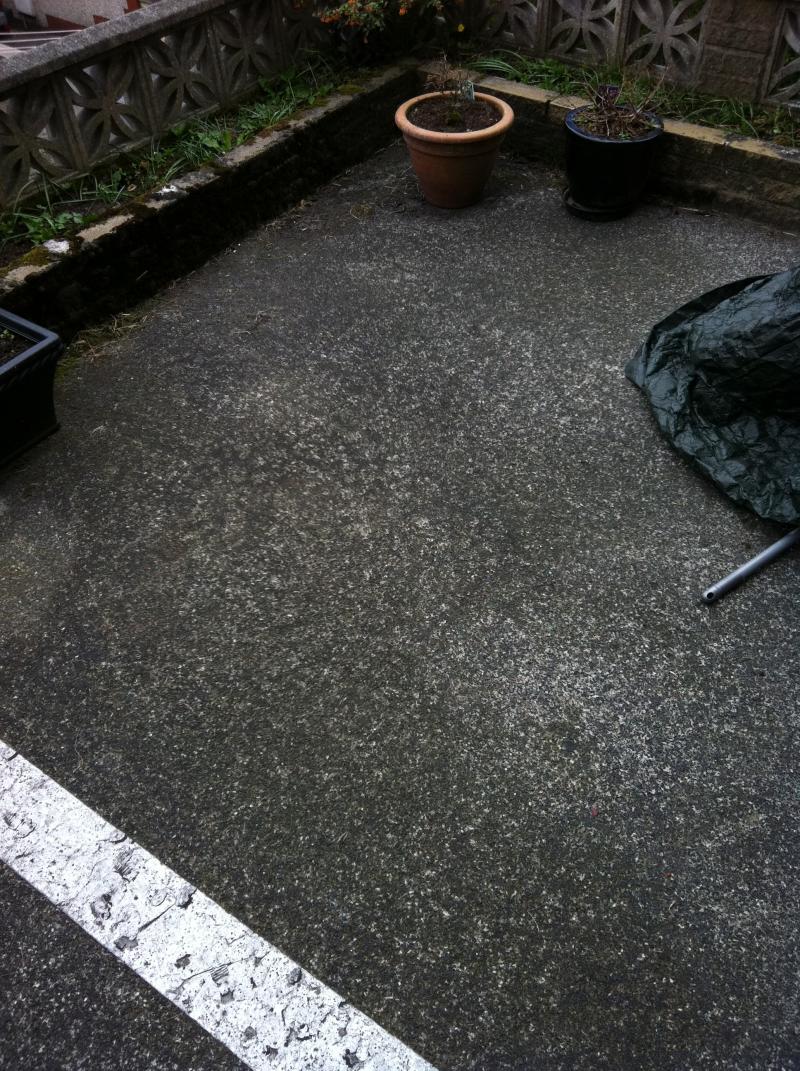

Hi,
We have a garage attached to the rear of our house. The roof is used as a balcony. The garage is brick built with a concrete slab roof.

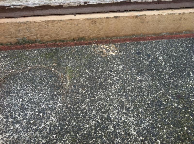

Since we bought the house last year, the garage gets wet on the inside of the walls. I'm pretty sure it's the roof that's leaking but i'm not sure what the covering is on the roof - i've attached some pictures if anyone can help.
So, how do I seal the roof bearing in mind it's used as a balcony so needs to look tidy and be able to be walked on. Also, do i need to remove the covering that's already on there.
Cheers
Rob
It looks like some kind of asphaltic coating but judging by the exposed timber and the gap between it and the mastic I would say that should be the first thing to remedy.

DIY job - use some Acrypol and cover with a Diy decking :idea: - Contractor have it re done and Promenade Tiles fixed
The surface does not seem that bad, in which case check the edges and upstands
