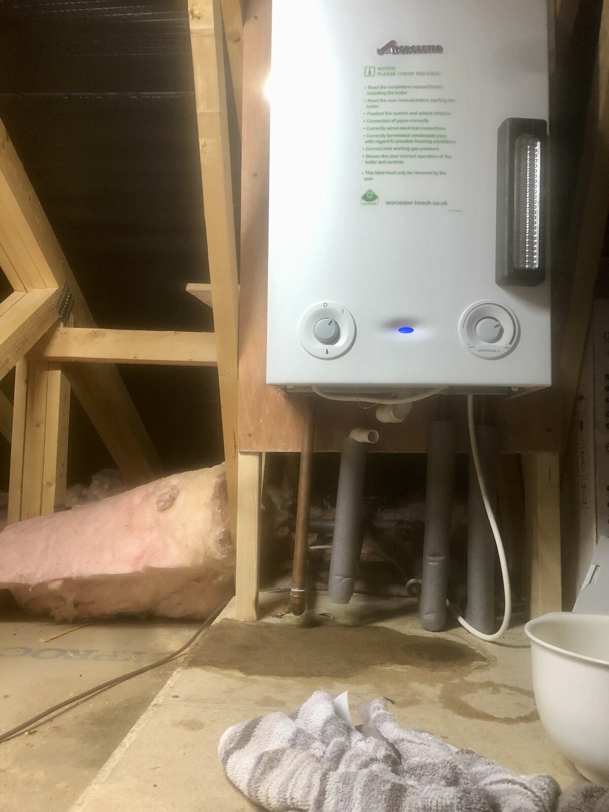

Hi, I took a random trip up to my attic today to check on mouse traps....only to find the condensate pipe was disconnected on the boiler....
Luckily, there was a bowl positioned directly underneath which took most of the water, but there was some overflow....
I re-connected it, however, I am not sure if a plumber needs to look at this to make sure everything is okay, does anyone see any possible catastrophes here?

A bit of history would be useful. Who set it up like that? Does the re-connected pipe discharge to somewhere appropriate?

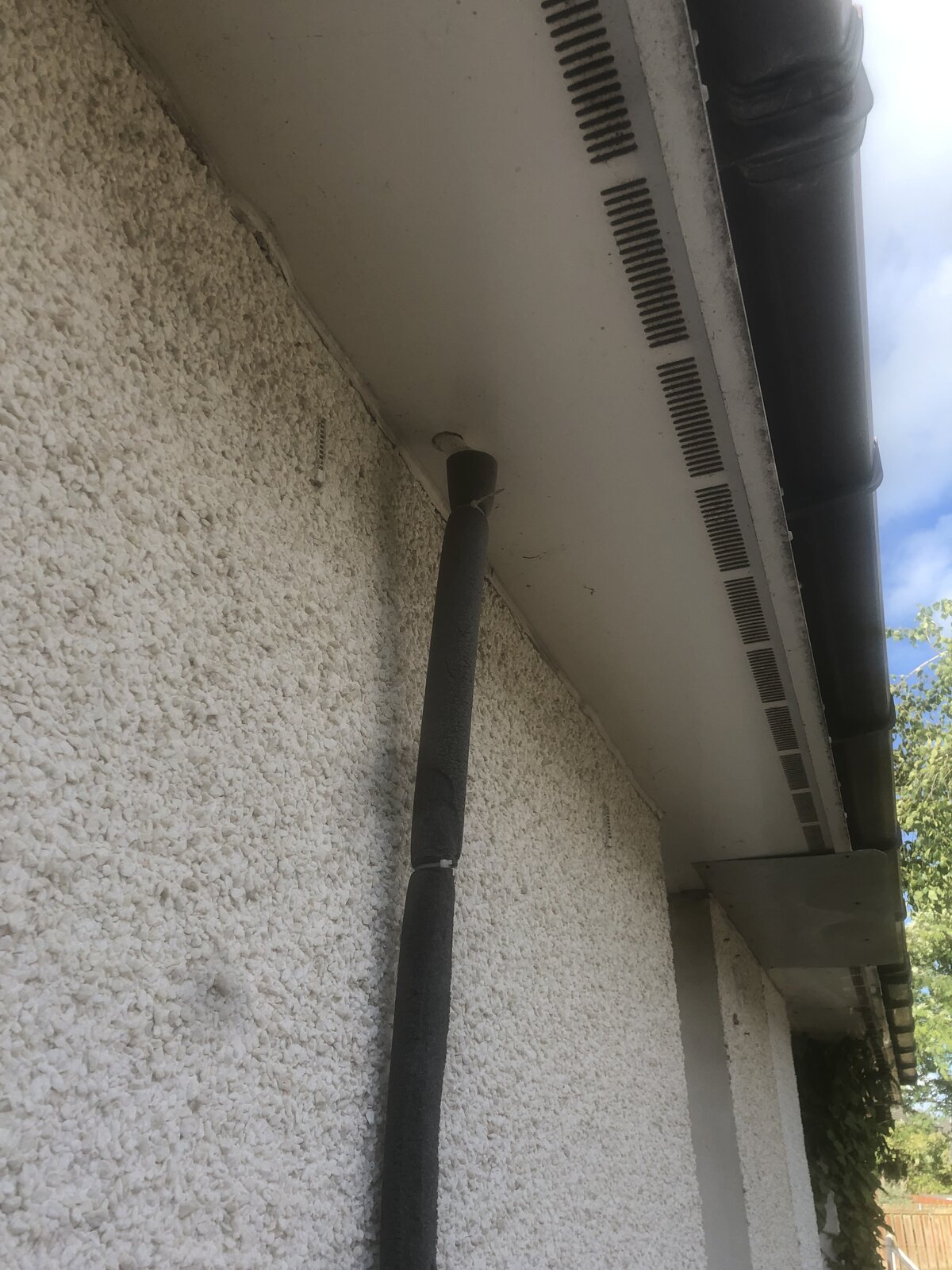

A plumber installed the boiler into the attic when we had an extension, the old one was previously in the kitchen, a new boiler, a new location up above....pipe runs outside, down the wall and into the ground..
I'd be looking to clip/support the pipe so this cant happen again, something the installer should have done at the time of fitting.

Should be OK as long as it falls continuously and it's lagged where outside
Usually with that connector it would be either glued in place or if it's a soft connection a jubilee clip would be used to stop it coming apart.
Is the external pipe larger, say 32mm and does it drop into a soakaway?

the condensate is slightly acidic and will erode concrete, mortar and limestone, so should not just be dumped beside your house.
If you happen to have a bathroom, kitchen or other drain nearby, that would be preferable anyway

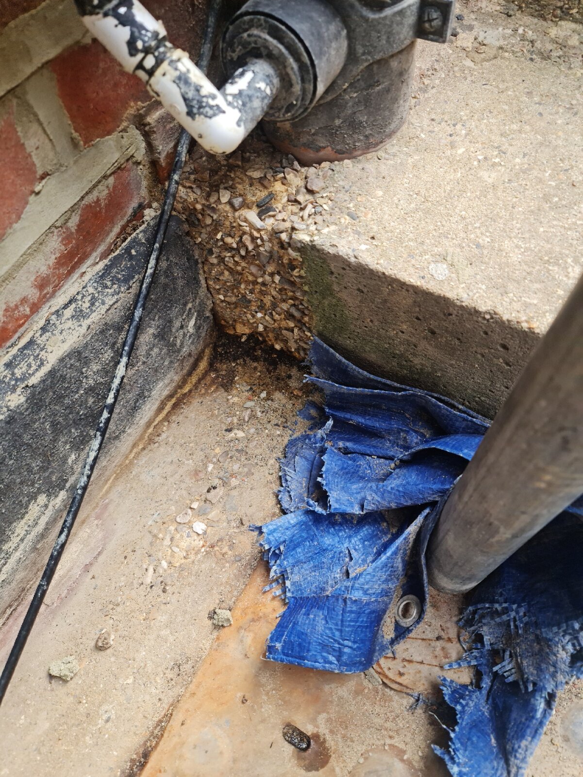

The following image is from the house I have been working at. The elbow nearest the soil pipe had a very slow drip. You can see where it has started "eating" the concrete. I used some CT1 sealant around the joint to fill the tiny hole.

Yes, I used to have a neighbour whose flue tilted enough to let condensate drip onto the paving in his yard. I noticed it ate a saucer-shaped hole, with bits of gravel remaining in it, where the concrete slab had been eaten away, similar to your pic.

I only posted the image to show the corrosive nature of the condensate.
