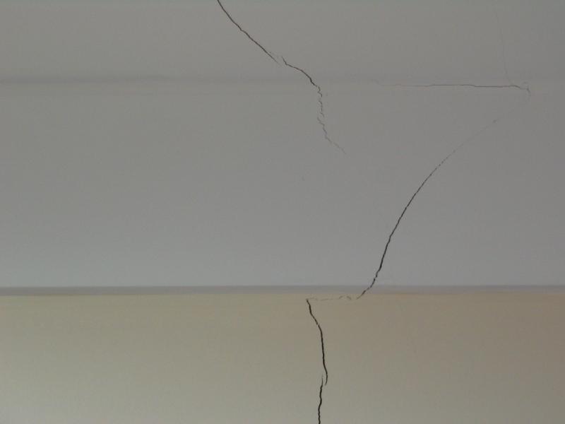

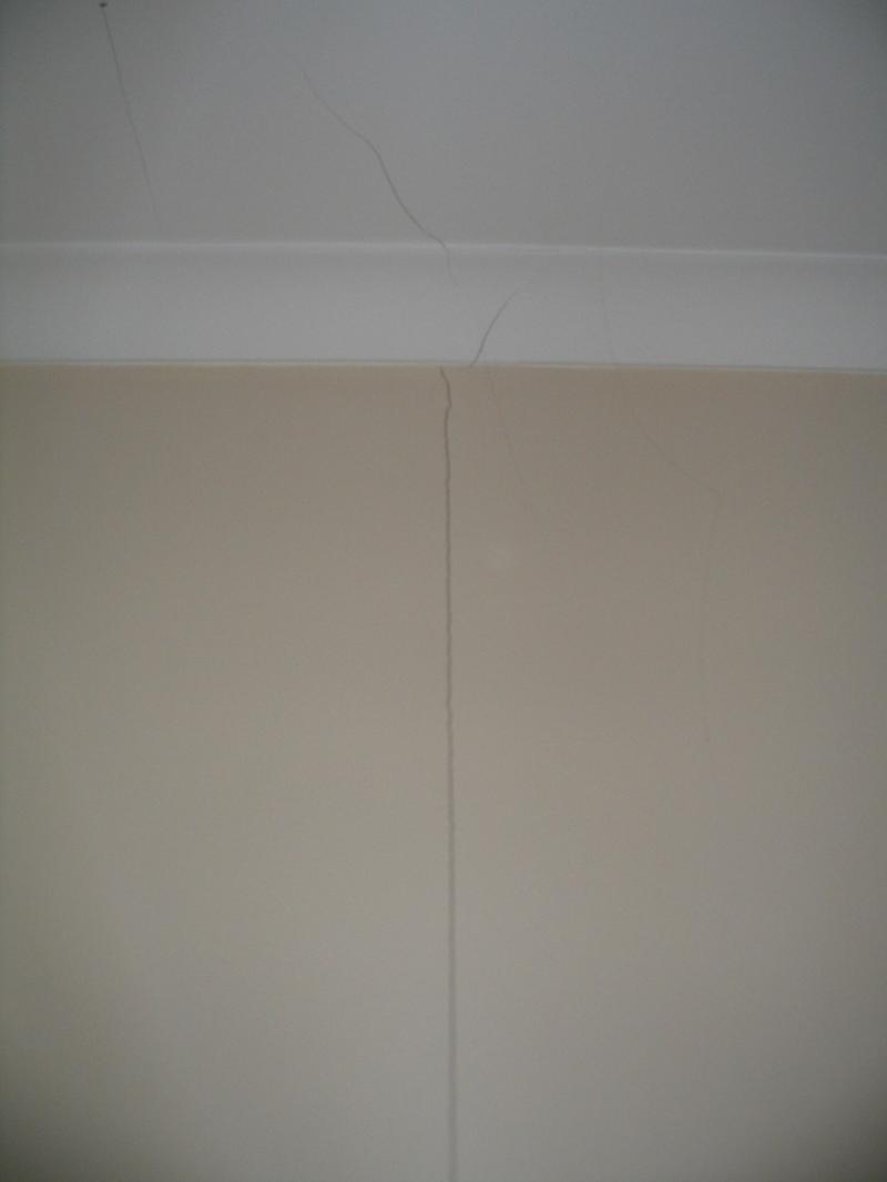

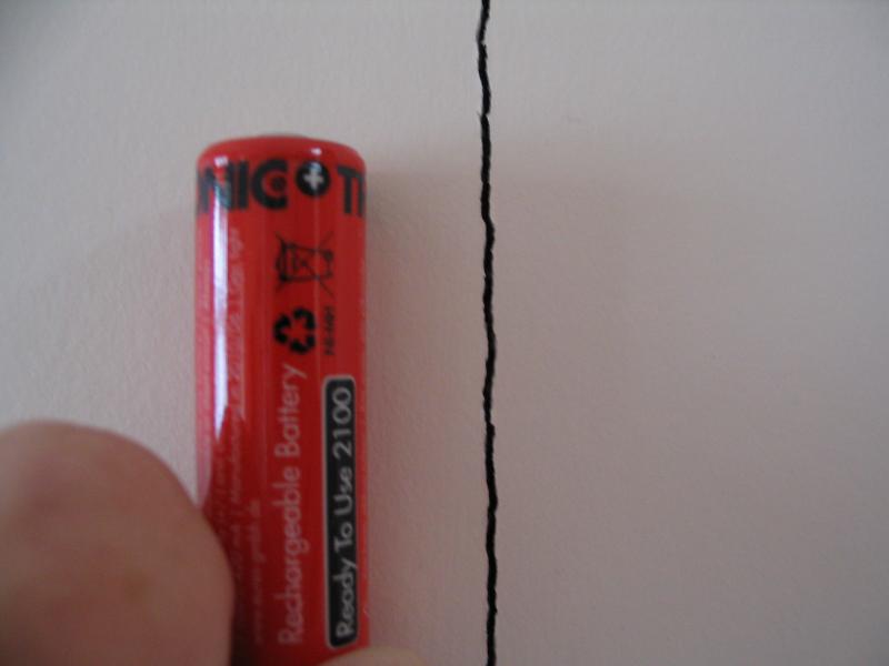

2 1/2 years ago we had a 11m x 2m singe story extension built, but around a year ago I noticed a vertical crack and now there are 2 cracks. The widest is 2m from one end of the extension wall and the lesser crack is 3m from the other end. The extension is split into 2 rooms - 9m x 2m + 2m x 2m. I enclose 3 photos, the battery is an AA size next to the widest crack for scale purposes.

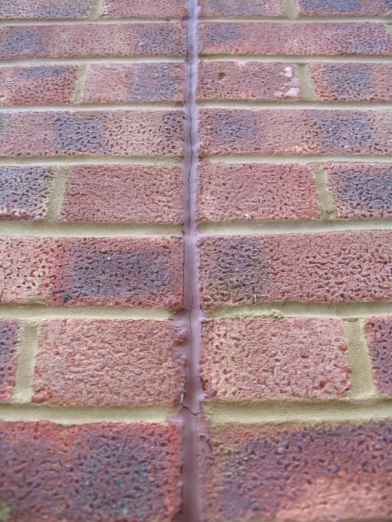

I was thinking of filling the cracks and painting, but a friend has told me the crack would just come back. He is a very good DIYer and got me to take the pictures I have posted. He pointed out that outside there is a 'movement joint' halfway along the brick wall that has come apart slightly at the top, and he suspects there are 2 more movement joints on the inside leaf of the wall which are made from grey blocks.
He went onto say the grey blocks have probably shrunk and the 1st movement joint perhaps should have been incorporated at the extension internal wall junction and the 2nd joint disguised by a dummy structure on the wall and ceiling half way along the 9m run of the longer extension room.

I see on the second photo that the coving has cracked as well as the plaster. What type of coving was put up? It's either something like Gyproc plaster coving or one of those foam filled lightweight type. If it's the plaster coving, I'd be worried that this has cracked. Perhaps time to get another builder or surveyor in to advise. As for your original builder saying that you painted the walls too soon after completion,, I've never heard of this causing cracks as straight as those .
11m long is enough to allow significant expansion and contraction. Sounds like your extension was designed for this externally but not internally. I would check back with your drawings and specification first of all to make sure there wasn't an expansion joint somewhere in the plaster that was omitted by your builder.The cracks are most likely cosmetic (i.e. due to lack of expansion joint) so I wouldn't get over concerned at this stage.

Thank you for the replies so far. Just to be clear the outside brick wall is split into 2 walls by the brown mastic joint so there are kind of 2 x 5.5m walls if that makes sence.?
It's not clear where this joint is, and that will determine the type and function of it - ie a movement joint for the extension, or an expansion joint for the wall

Subsidence or settlement would be indicated by some rotational movement. That's to say the crack would be wider at one end than the other. Are your cracks wider at one end or are they parallel?

In answer to jeds question about the width of the crack - The 2 cracks are covered in places by very hard to move furniture so I cannot see their entire runs, but I believe the main cracks are constant width along their respective runs.

OK, its hardly brain surgery, the solution is to ensure the external movement joint goes all the way through from outside to the inside.
So, hack off plaster internally, determine if a MJ has been installed in the inner skin. If not it needs to be retrospectively installed. Once that's done a new MJ can be applied in the plaster internally. Re-plaster up to MJ and repaint. Then fill his cracks with some polyfiller and repaint.
