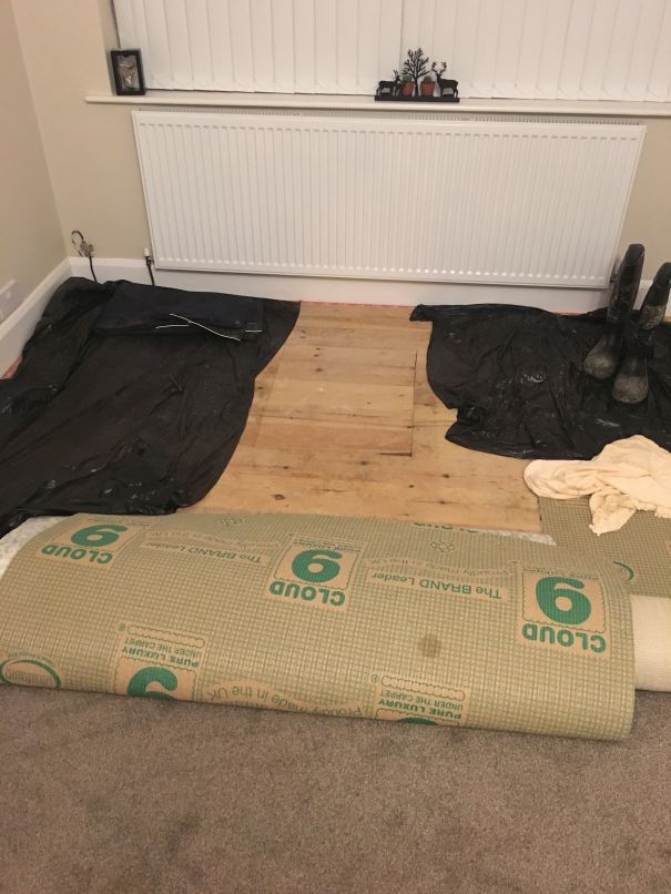

    So we have the carpet in the living room. Problem is there's a hatch towards the front of the house in the living room floor that it looks like we're going to need access to once per year.
    I don't want to have to go through the faff of moving what we've had to move this past week again and certainly not on a regular basis.
    I imagine if you cut a big square in the carpet it's going to look awful. I'm just wondering if that's all you'd do or is there a way of getting it to look a little better?
    We could rug it, maybe. I think it'd make the rug look a little random, unlike a rug in front of the fireplace, but i don't really know the best way of approaching this.
    The hatch has already been in place. It does squeak but 1) we know roughly where it is when walking so tend to try and avoid it if we can and 2) it's not in an area of high traffic. You'd only really be walking in that area of the living room to either A) open the blinds or B) listen in a little better on next doors latest argument
    So yeah we can't do much about the hatch tbh as it's already there. As you can see in the thumbnail it's between the black sheets.
    As for what's underneath - unfortunately water, and a sump pump - hence the need for the hatch itself.
    So just wondering how you'd cut access to this?

    a skilled carpetfitter could probably cope, especially if you have a mottled, unpatterned carpet. They often put doormats into a carpet, flush, and, in offices, there are little lift-up trays for power and comms cables to be plugged in.
    i have an idea they call the mat-tray a "well" but I might be mistaken

    Seriously, if it’s only once a year, I’d invest in a carpet kicker and roll it back each year for access.

    It’s close enough to corner to allow access by pulling back the carpet , no other work required .
    Or install floor socket over position which will create a removable hatch in itself which can be carpeted .

    I did wonder if they'd border off a square somehow rather than just cut a square and do a runner. I've got to find myself a carpet fitter. I'm hoping for one who's done a fair bit of time so may have done something similar.

    Floor box for power https://www.tlc-direct.co.uk/Produc...TUdgQrsut_KDm76ntOucZSzQPoVM6bkRoCiusQAvD_BwE
    Top insert holds carpet to match and you can give yourself extra sockets.Entire box can be removed to give access below in about 10 seconds .

    I'm sorry but i'm not sure if that would work.
    Access would be needed to the subfloor (which has a 1mtr drop btw) to replace/service the pump. So whoever is doing the job would A) need to fit through the hatch and B) be cable to get in at the pump down there to do whatever it is they're doing.
