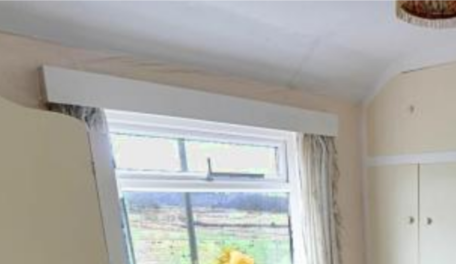

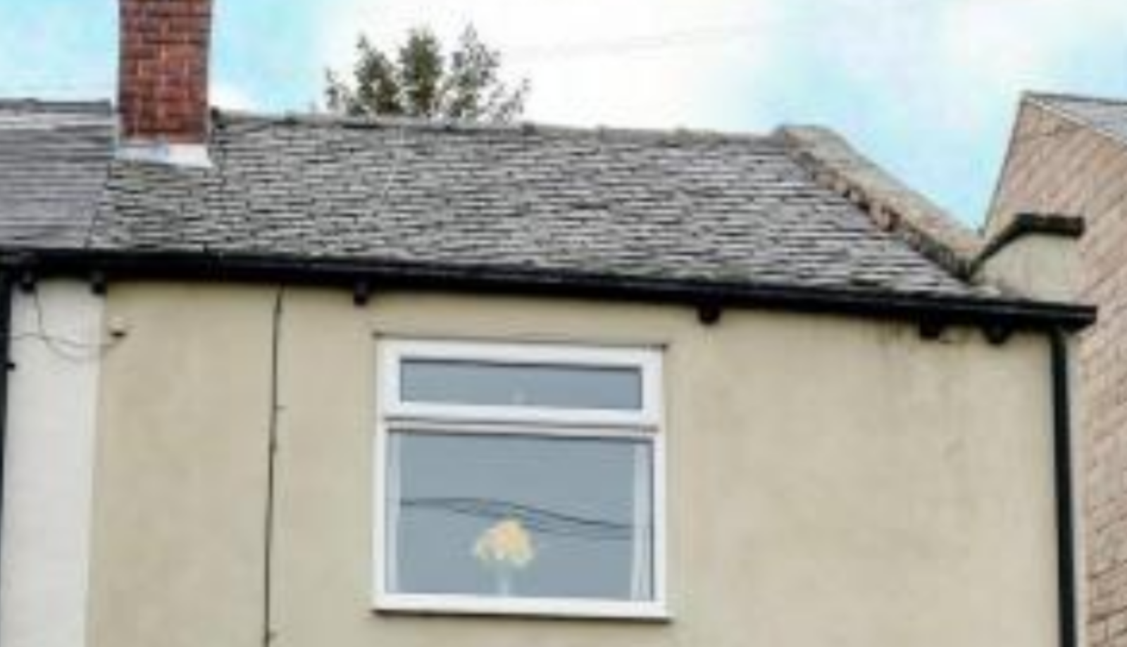

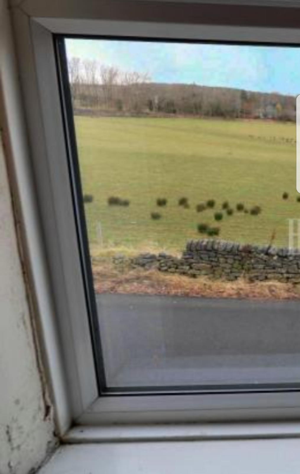

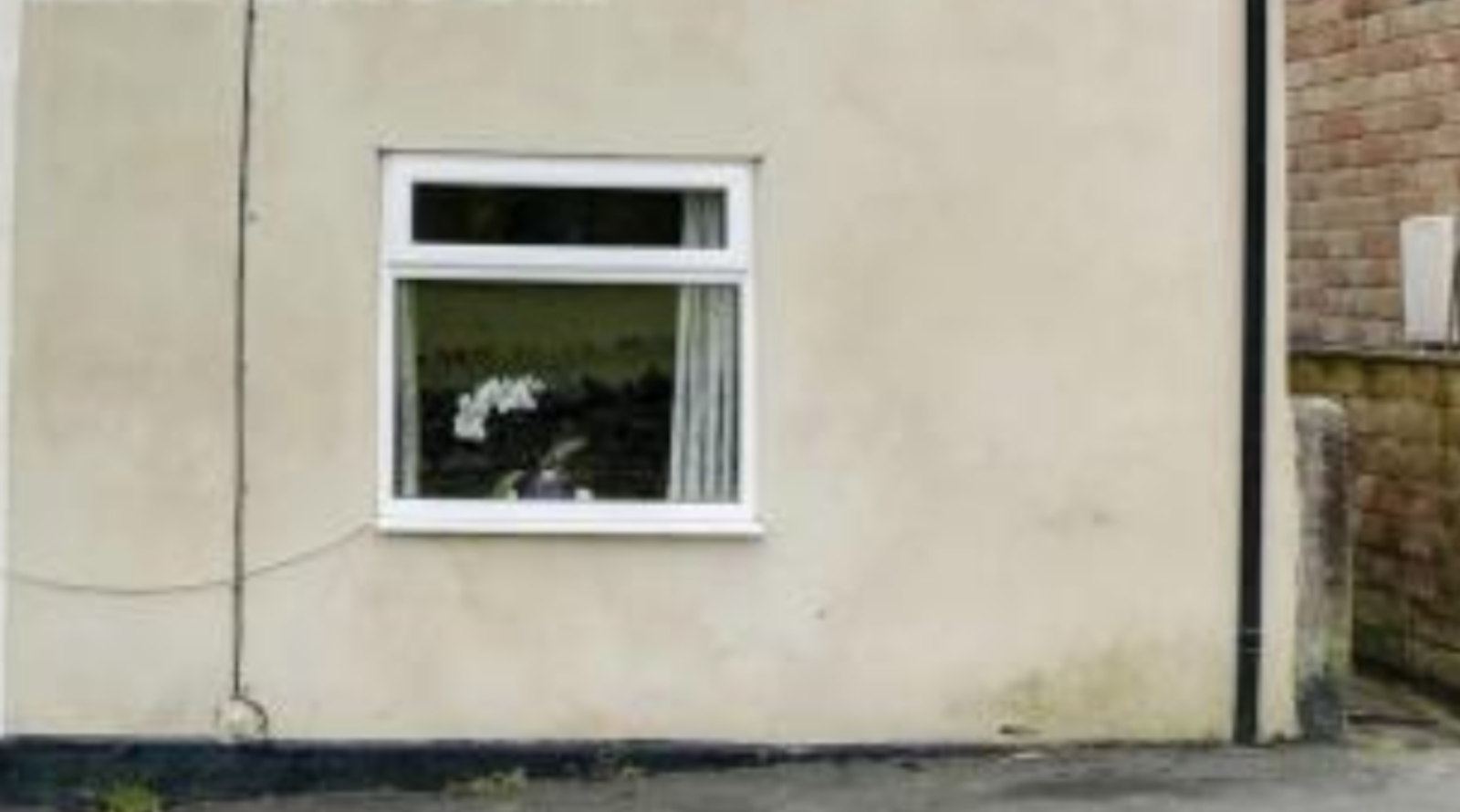

to much stuff to give you a proper reply.why dont you post lots of pictures of the outside and the inside.are the floors solid or suspended
Hi bobasd, thank you for your reply :-)
I've not got very good pictures I'm afraid, I've tried to pick out some parts from the brochure. The most affected parts seem to be the north facing side (the picture at the front) and the west (down the side path) if that's any help. One of the worst damp parts inside is under the ground floor window (the one pictured on the front - I haven't got a good internal picture), where I think it would literally fall off with a little pressure as the plaster is totally bowed out from the wall. Guessing that's the rising damp as there seems to be no protection from it at all looking at the road. I haven't looked under the carpet, but as it feels quite uneven I think its a safe bet that it's a solid floor :-/

your pics are not up to much so still cant help you much.
you probably need a priced inspection or survey.ie a list of items with prices to make good. from what i can see there are a few issues.

If you look at the first picture you will see a black line on the building. It looks like the path may have run level with the line at one time. And over the years it looks like the path has been built up! Are you getting damp low down at floor level in that area? I have an house with 20" walls and I had rising damp all around. I hacked all the walls back to the stone work on the inside and I mixed up a sloppy mortar mix with W/Proofer in it and "splatter-dashed all the walls with it. I put soon insulation board behind a 3"x2" frame work in front of it. Then plaster-boarded and skimmed all the walls.(There are pictures in my albums showing how I insulated the bed rooms..
