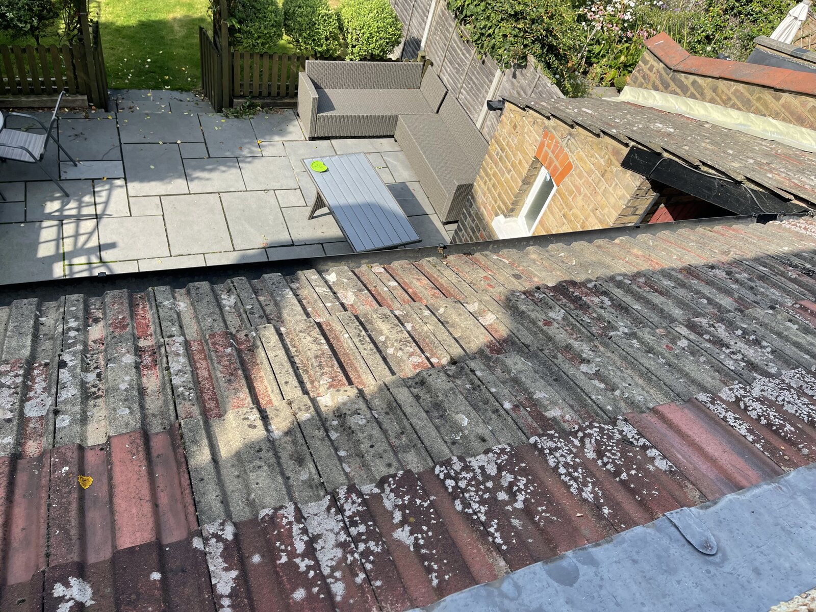

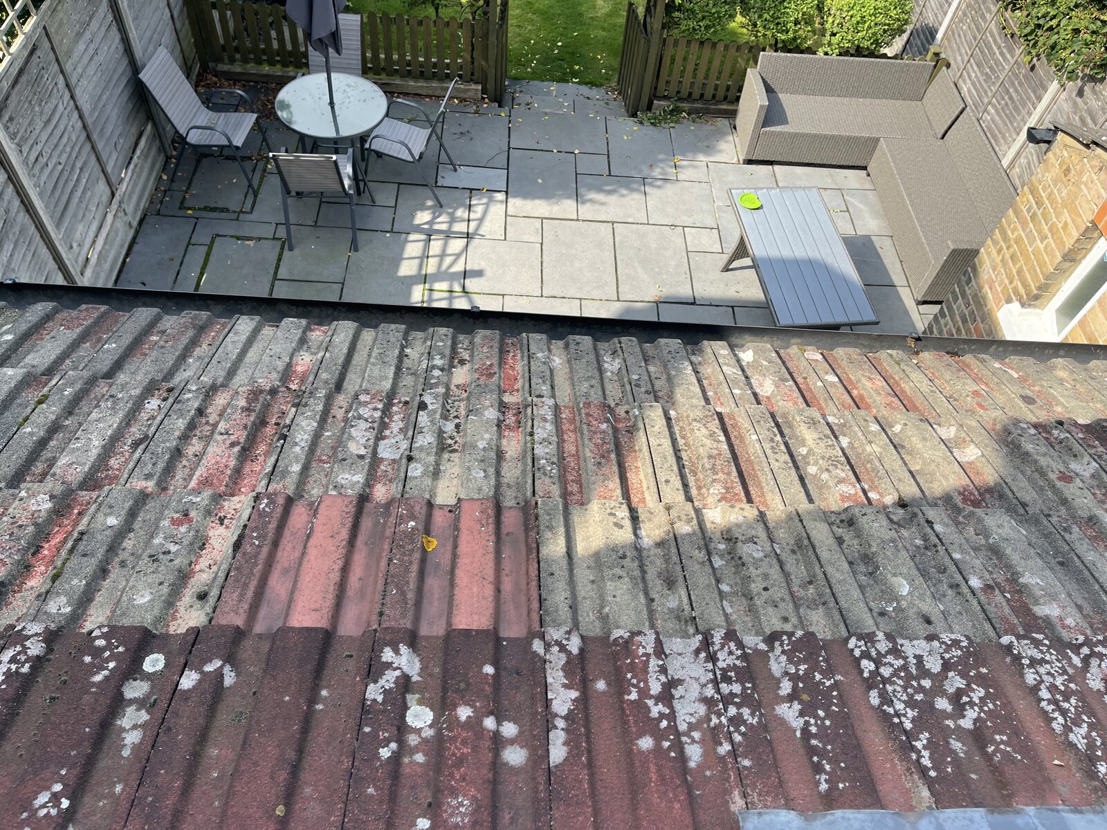

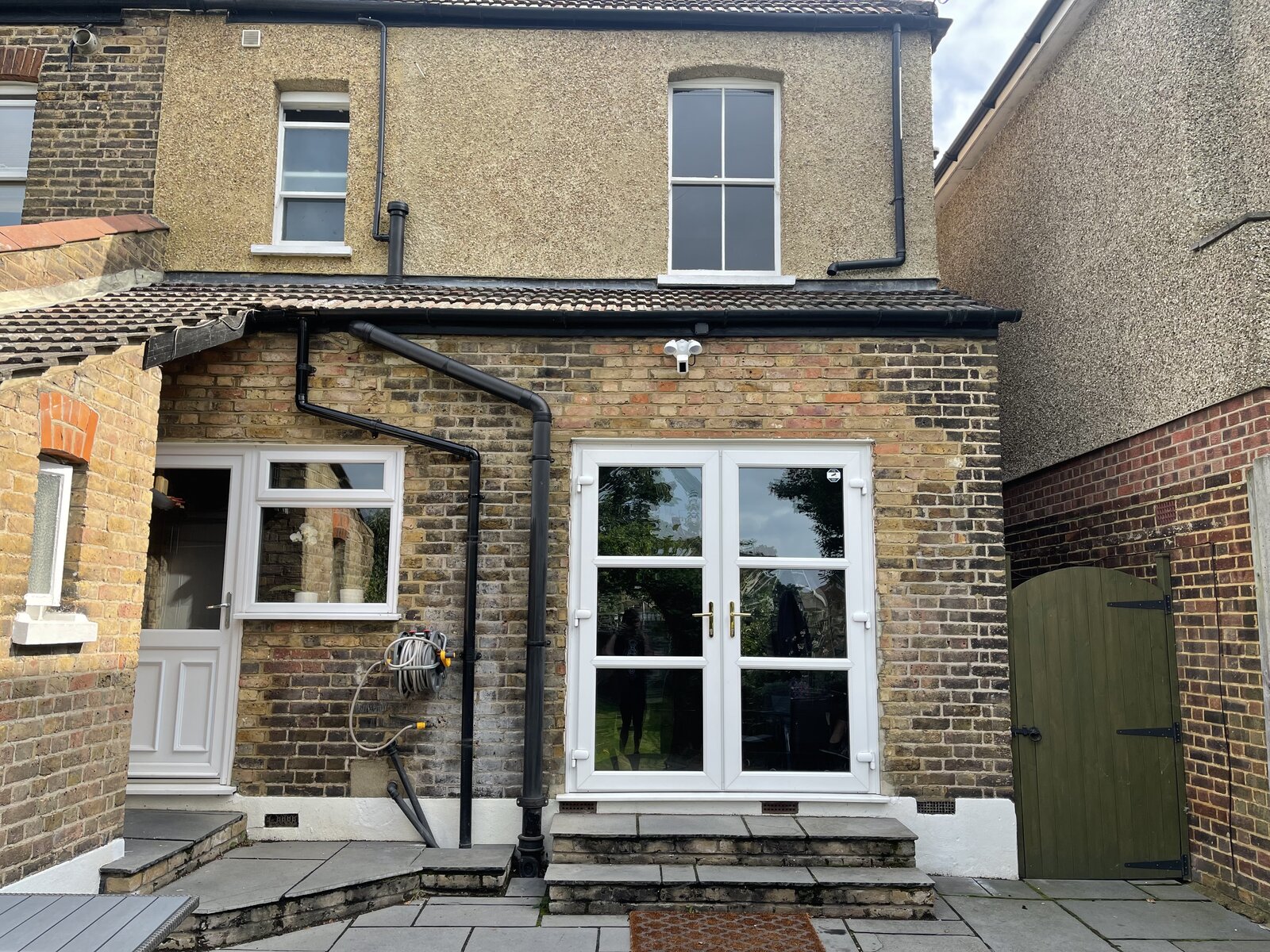

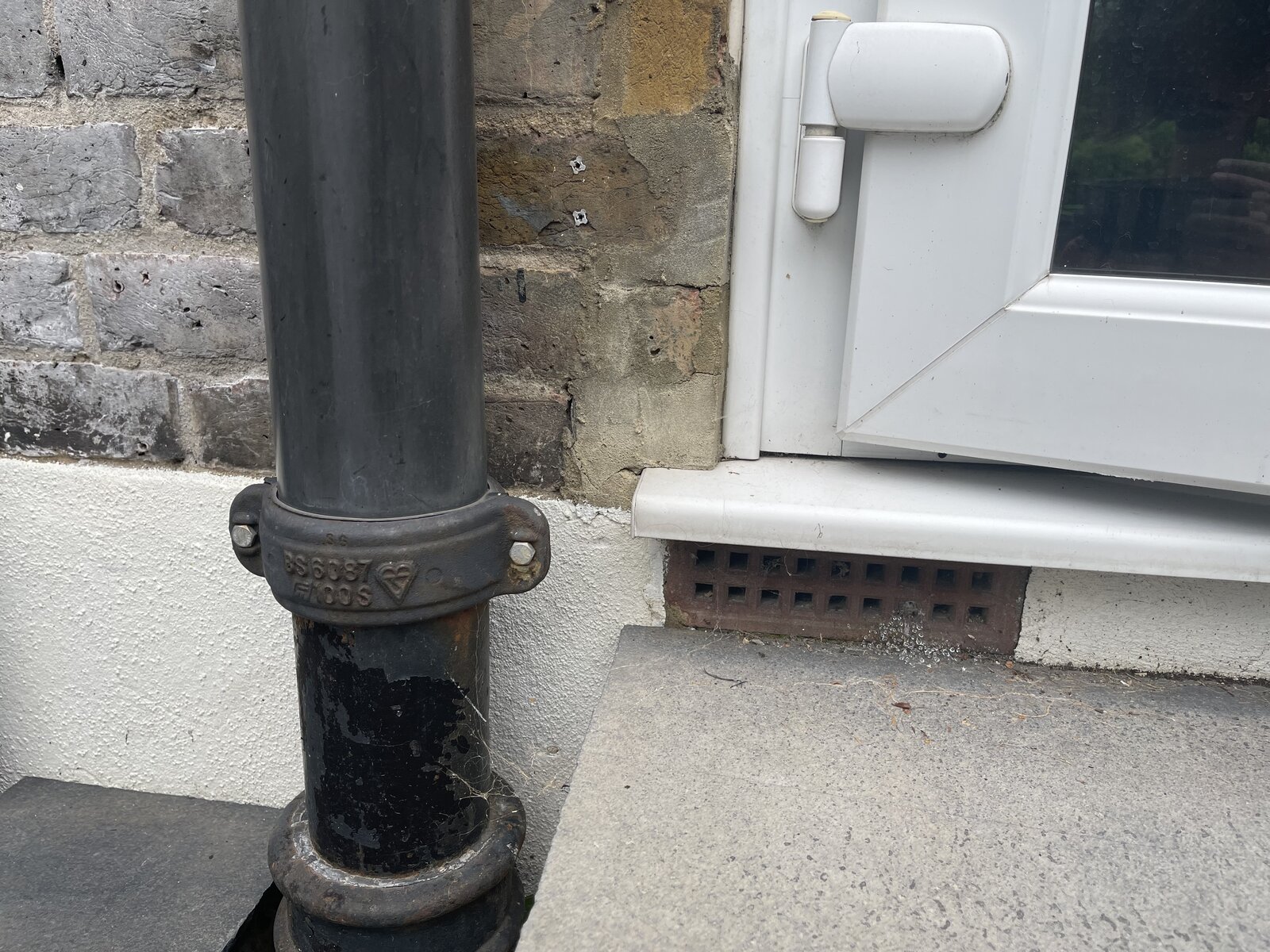

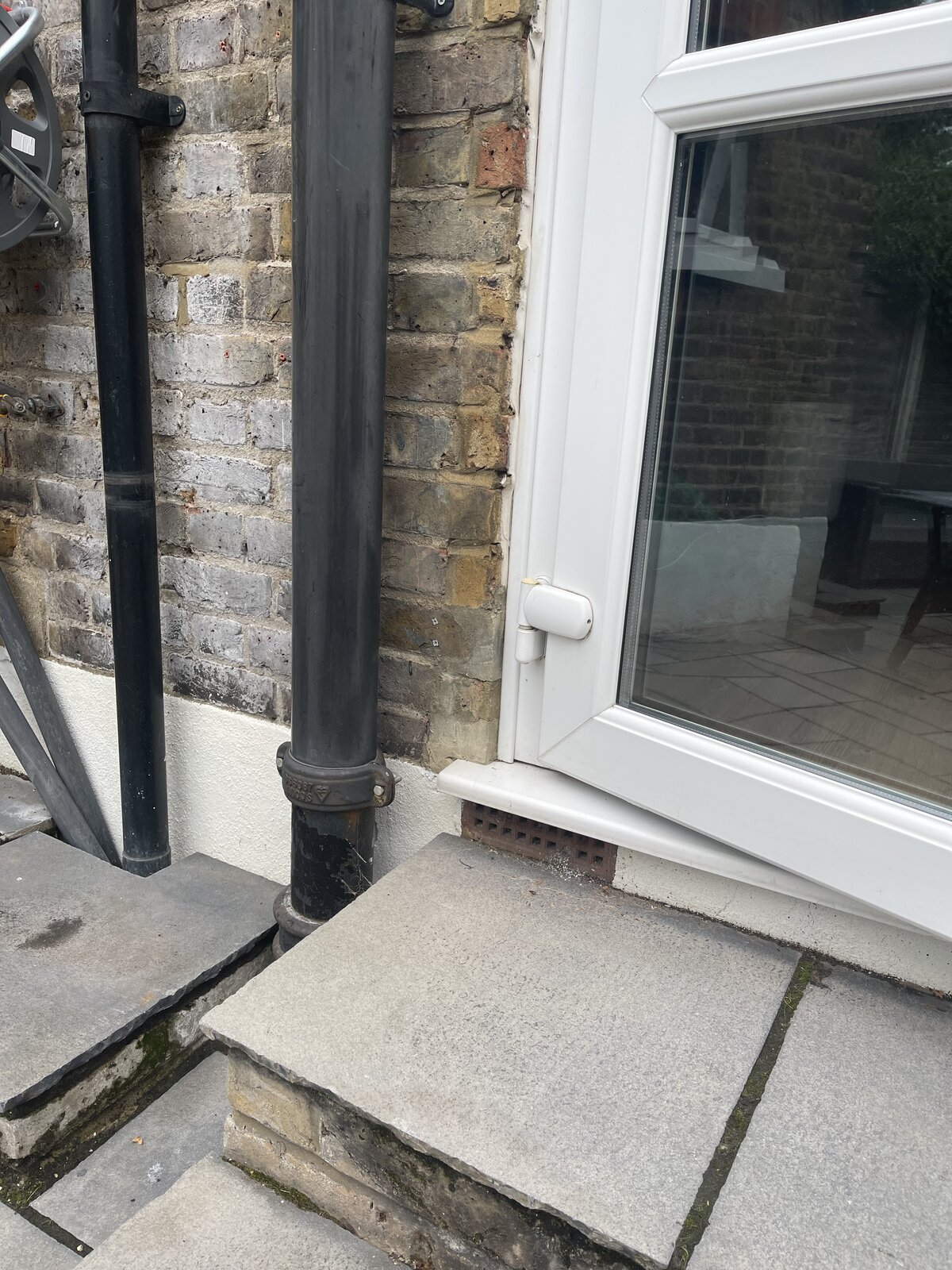

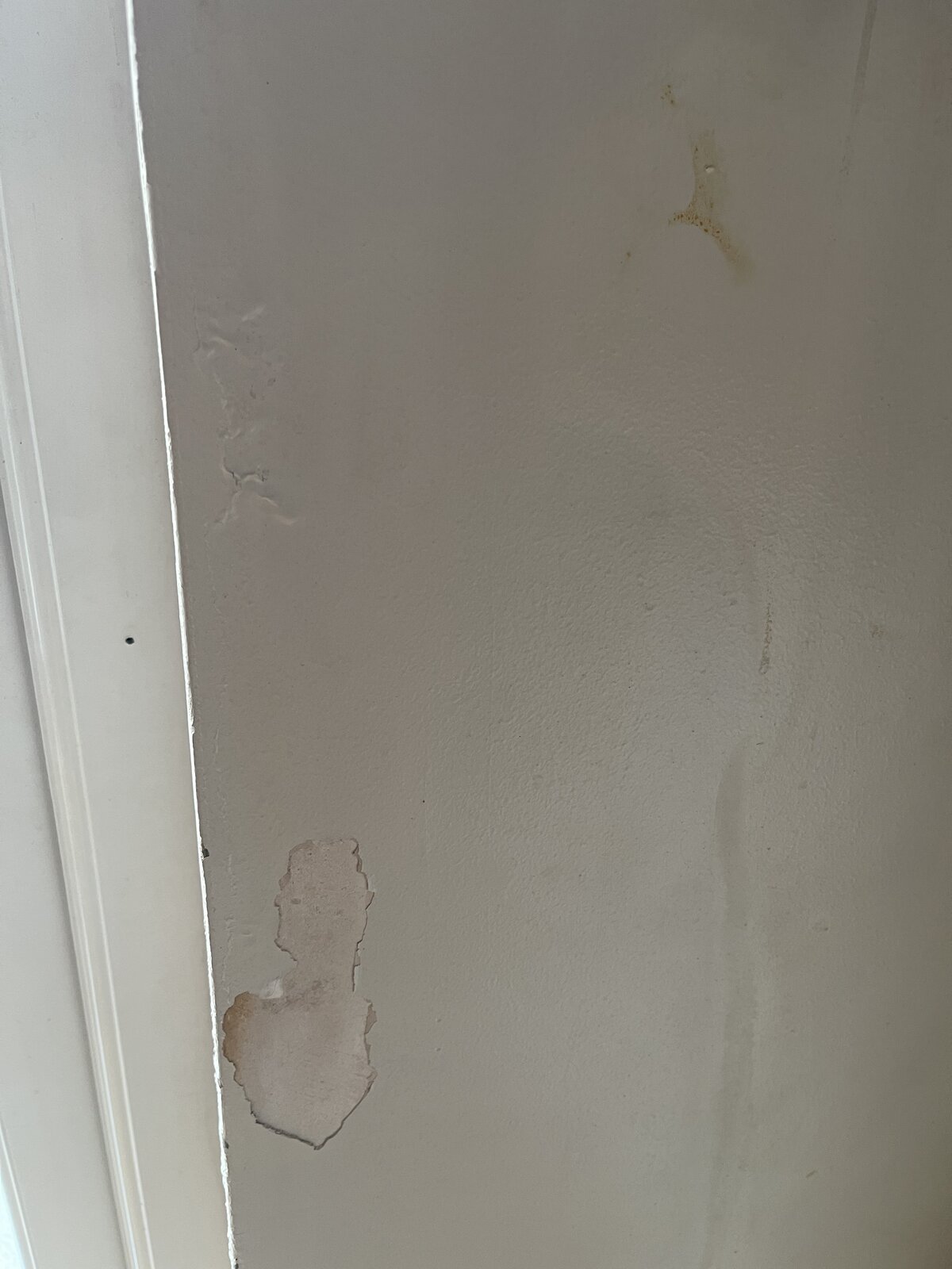

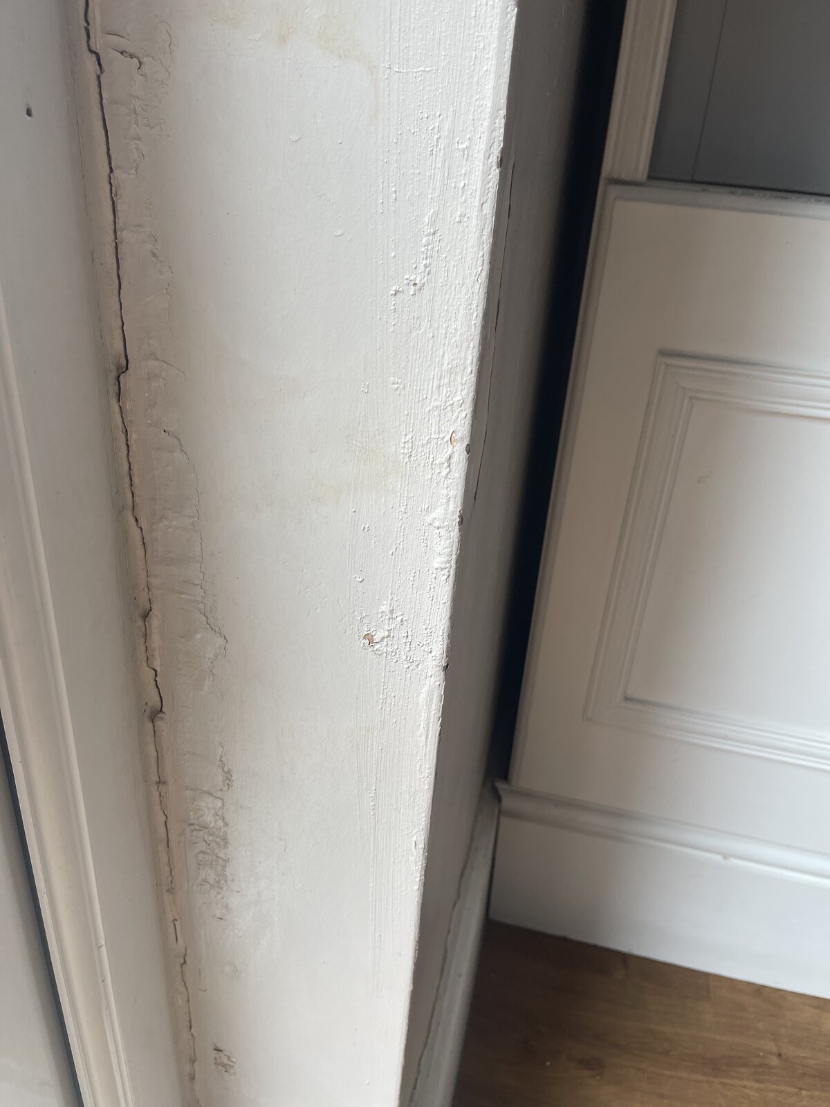

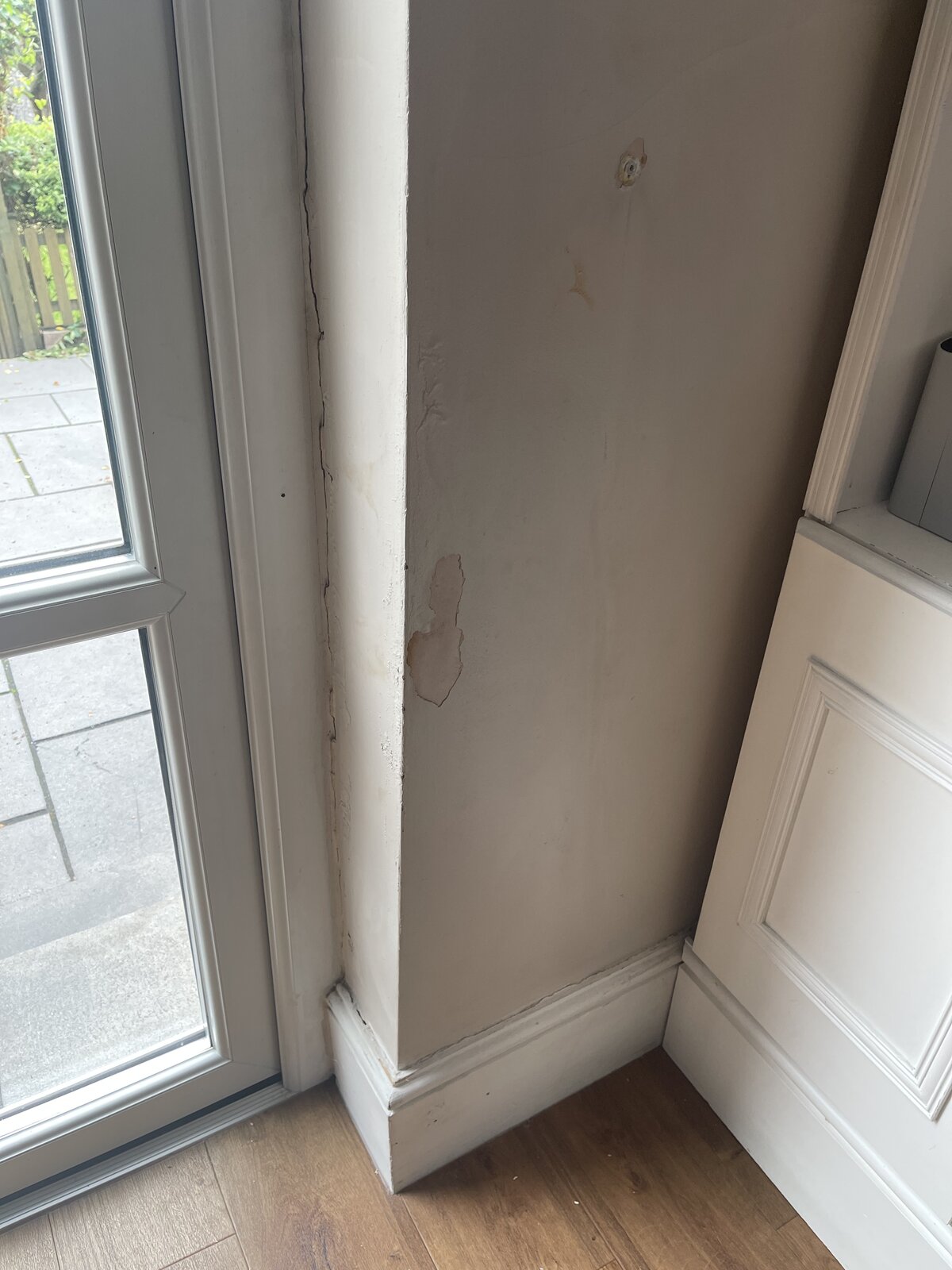

Hello,
I've just moved into a new house and found the paint around my patio doors is bubbling. The floor is suspended and the patio doors are not original to the house (it was built in the 1890s). Does anyone have any suggestions as to what might be causing the damp? I've attached some pictures. The humidity in the room tends to stick around 65 - 70 % depending on the outside conditions. I have a dehumidifier running which has dried out the paint and stopped it bubbling.
