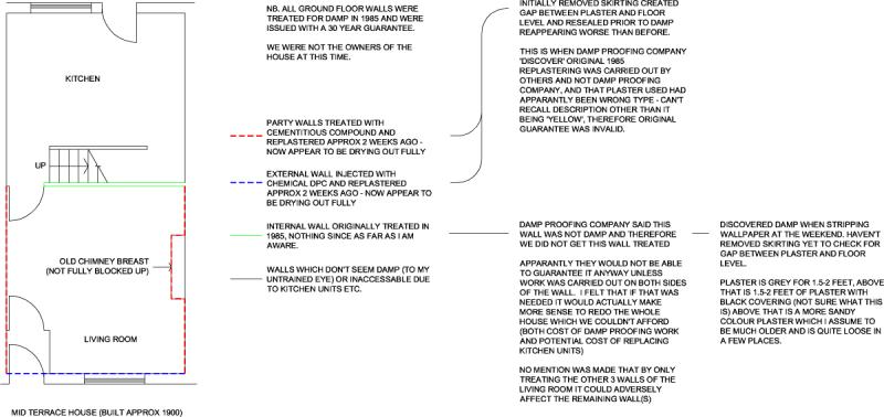

    I think that there is some confusion (probably not helped by my long post) - it is not the walls which have recently been treated that are damp but one which was not treated. I have made a diagram with the information to try to clarify the situation.
    It is the wall highlighted in green which now seems to have a damp problem.
    I hope the diagram below clears things up a little...

    your bottom half or first meter of walls should of been chopped off and rendered with sand & cement + waterproofer
    this meter of wall should be very hard and if applied right its a right pain to chop off.
    the grey first two foot of that wall should be hard render that was put on with the damp proofing last time. should of been a meter.
    now the 2nd 2 foot of wall I'm guessing the black covering is where the plaster was renewed before then it was tanked or if you like
    painted with rubber bitumen to seal the wall before skimming, above this the could be the original plaster,
    if you have done a lot reading on here then you might of read about injecting a ( think it was a cream ) if you have then using this might
    be your best option and treat that wall yourself.
    I'm surprised no one else has posted back yet although this thread would probably get more response in the plastering section,
