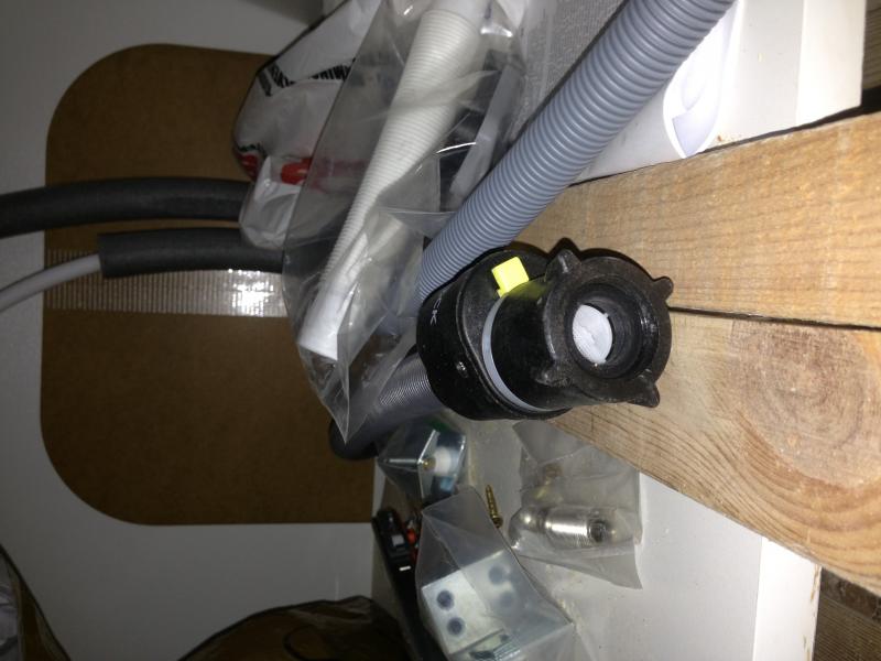

If you are allowed to plumb in. Be aware some dishwashers have leak protection this warrants a 'valve' at the water pipe connection.
Probably best to have a connection tap/valve with vertical outlet connection.
Do read this :- http://www.whitegoodshelp.co.uk/aqua-stop-hoses/
We have Neff stuff, both washing machine and dishwasher incorporate differing 'Aqua-Stop' kits... The wash m/c only on fill pipe, the dishwasher incorporates inlet and drain pipes to the 'aqua-stop' valve and hence from valve to sink drain pipe.
Believe me, you need (as in pix) vertical valves AND a good 12 ins clearance below the valve thread - if for example fitted in a cupboard or near floor.
Best get a look at the fittings on your desired machine at a local showroom before altering any plumbing.
My advice? Keep clear of the kit using these ridiculous large tube accessories - waste of time, money and above all space !

Perhaps the Ikea jobby has an Aqua-Stop valve for cold in, and, as with my washing machine, a standard drain tube?
This is a view under my sink, busy and murky, stained pipes from using sprays to free up isolation valves. Note the size of the convoluted pipe from the dishwasher to the Aqua-Stop, wouldn't want to be too constricted for depth under isolators.
