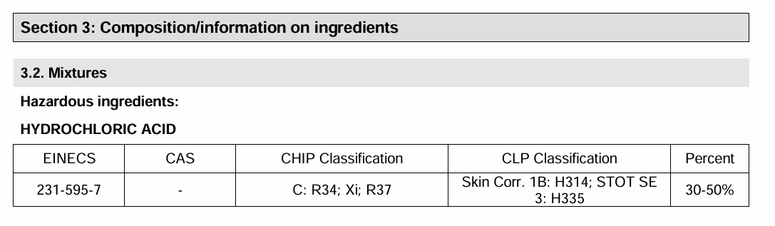

HCL has been used for decades as a system descaler , though typically it's "Inhibited". Something else to look up.
Most but not all strong plumbing acids are inhibited.
Oh look it took several seconds to find one uninhibited by the looks.

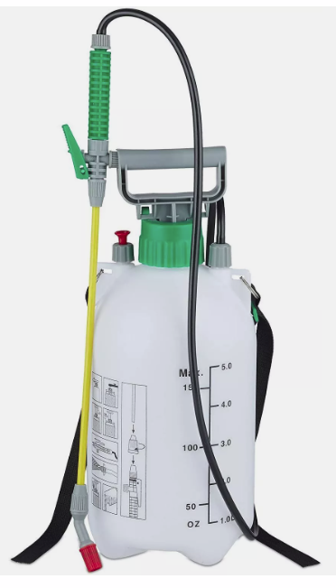

Acids etc are a bit of a pain to introduce - I had one of these
which came with an 8mm aluminium tube - so I used fittings to get up to pipe sizes. You can circulate with that and a bucket.
Put mother in laws' cheap aftershave in it and you can tell when it's got through.

Citric acid is available in the supermarket I see. Those garden spray devices are under £15 so may indeed be useful. We may already have one. A good thought.
