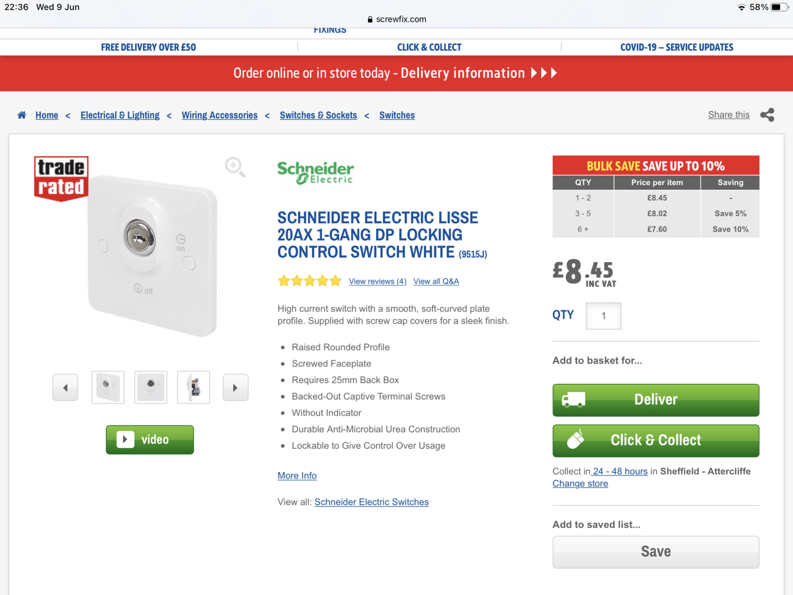

    Nice quiet Humidistat Xpelair Fans in onsuite bathrooms, with no windows, so fans important to remove the steam and humidity.
    New tenants have disabled the fans by switching them off at the DP Isolator switch, I was told they were needed to comply with Regs.
    Are they a requirement ??
    All Circuits in property are RCBO protected, fans run off lighting cicruit.
    Could the switches be removed ?

    There is no regulatory requirement for fan isolators.
    The manufacturer's instructions for some fans say that they should be connected via an isolator. However, the regulations now merely say that such instructions should "be taken into account" (the regs used to require compliance with manufacturer's instructions, but not now).
    So, I suppose the short answer is that there is no 'requirement'. One can, however, argue that they may be 'useful' to facilitate maintenance.
    Kind Regards, John

    I believe Guidance and Manufacturers suggest them, mainly for Isolation and maintenance reasons, but I do n0t recall any actual regulation demanding them, there may be a few unrelated regs that could be twisted a bit to suggest they are needed.

    You can also get a fan isolator in a single grid module now. So that might be an option to have one for maintenance but also deter user switching because it needs a tool/key.

    I can see why having an Isolator is a good idea, and that is why it was most likely suggested, but in a rental property, if the tenant doesn't want the fan whirring away they can disable it, which sort of defeats the purpose.
    Thats a good idea. In my experience though tenants just buy what ever keys they need off ebay, to defeat what ever type of lock you put before them. Is there a more secure way to have it switched, but one that would allow you to lock it in an on position ?

    MK k4858 or 4857 are made for there MK ones, though I am not sure if you can use it to lock ON, though there not perfect, would look ugly and keys i believe are all the same

    The isolators could be removed, but if the problem is tenants switching the fans off, they will just find some other way to disable them.

    Can it be double confirmed there is then NO regulatory requirement for the Isolator Switch.

    Yes it can.
    The regulations do not require local isolators for any appliances; not even the ubiquitous cooker or shower switches.
