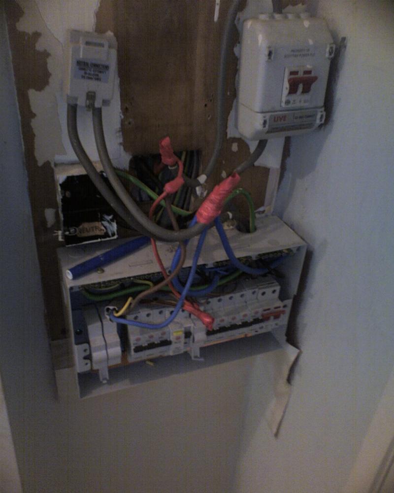

    It's scary to know whats out there, The fuse board fire is frightening.
    And the messy switchroom wall :eek: :eek: :eek:

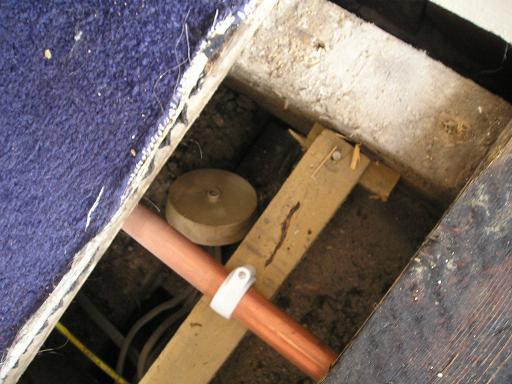

    Not the worst wiring disaster that's on the site but I found a strange set up in the house I'm currently renting. It appears that a ceiling rose is being used as a junction box, between the floors. This might explain why there's a fault with the light in the room below! :confused:

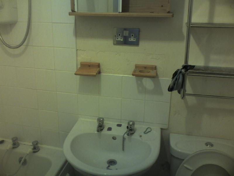

    ive seen some bodges in my time but that switch IN the cubicle takes the micheal just a bit....

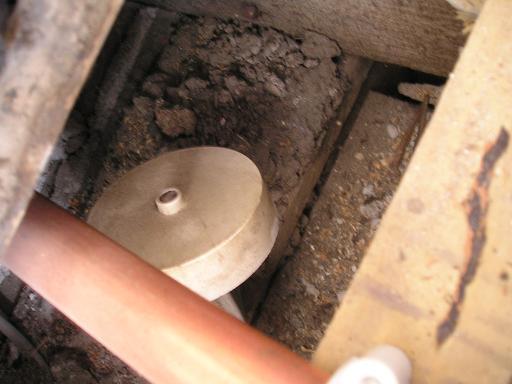

    My Electrical fault I just found on my mums places
    Post "Tradesman" making a right Fudge up of a bathroom ( as an DIYer i was shocked by the poor standard)
    The guy pulled out Washing m/c and failed to refitted drain hose resulting in flooded kitchen.
    Q call from mum stating downstairs ring main wont reset.
    These where done prior to her moving in
    Straight away found earth neutral short. Sod law wiring disappears under a concrete floor, quick prod show this will soon lift.
    Fault 1 Ring main run under kitchen dining room door way with 2 junction boxes that you would use in nice dry places not buried in the dirt/concrete But they where covered in an Argos bag lol.
    Found the fault was in a wire that ran from here to a plug in the dining room.
    Time running out so disconnect the Faulty wire changed the RCD and left ( no Ring main but full working socket)
    Popped round to pull through a new wire, But still trying to work out how a wire failed. As the wire is in trunking!! nice an easy line on end and pull. All set up and promptly pulled 2ft of wire and it went solid :eek:
    tried the other end solid :eek:
    No other option but to dig out the solid'ish floor, So poor the 2lb hammer ate through it.
    After removing all the concrete and damp proof membrane, then 3" damp dirt/rubble.
    I found the cause of the problems a lighting junction box buried in the dirt now full of sand and water. All for the sake of a 3m length of twin and earth.
    All now replaced with water proof stuff etc just making to make good now.
    The other thing found whilst taking off socket looked in one socket "why 2 lives ohhhh he used the red casing to cover the earth" :eek:
