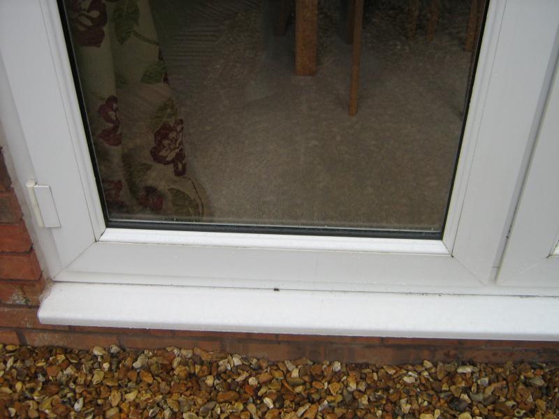

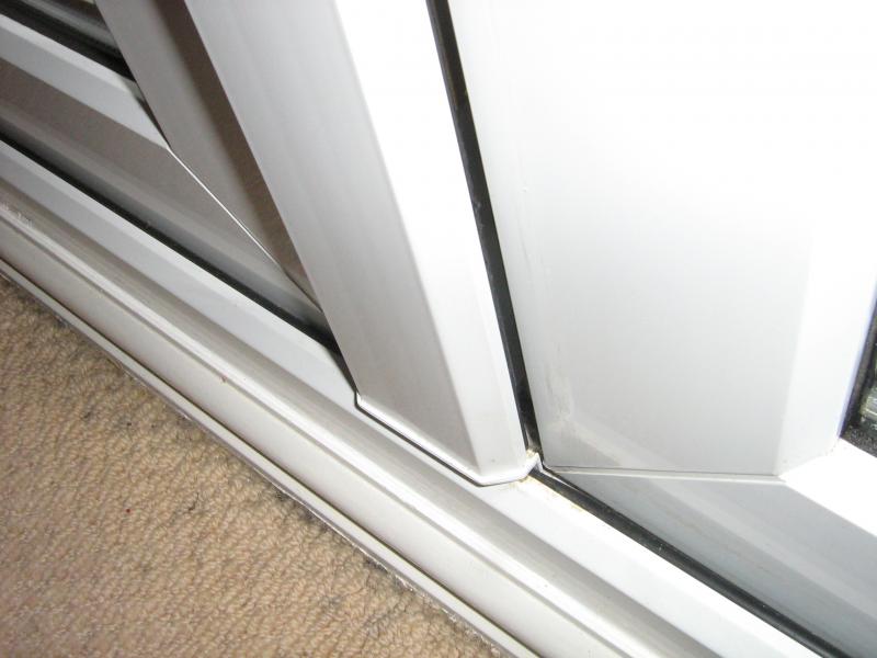

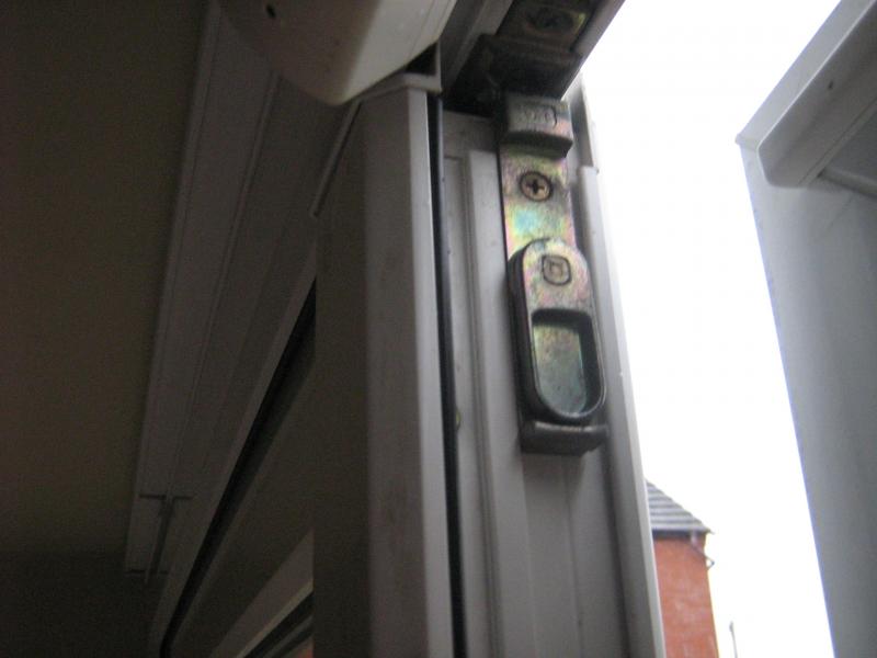

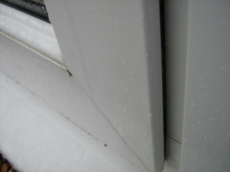

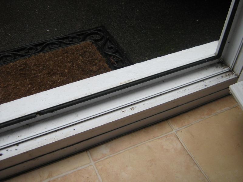

The patio doors are uvpc. After a bit of investigation the gap between the the opening right hand door and plastic uvpc is 10mm (excluding the black seal). The left hand door seems to move around inside the hinges see photos.
The right hand side door also seems to move in and out by up to 10mm (when closed!!). On a windy day I can feel the cool air coming in!!
Patio Doors
Backdoor
it just needs adjusting, try it yourself by thinking logically about what each part does, start with the slave door tightening it up with the receivers, then work on the master door. OR ring a local fitter they should do it in ten mins
