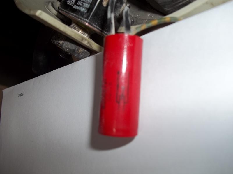

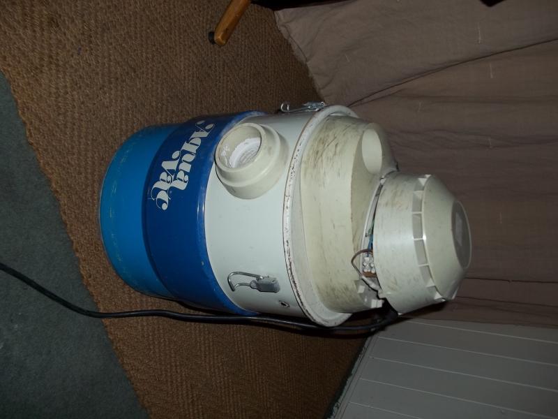

Hi,
I inherited this aquavac from the early eighties and it's come in very handy until it blew. I can't really afford to replace it although I can't afford to do without it either as much of my work is plumbing repairs.

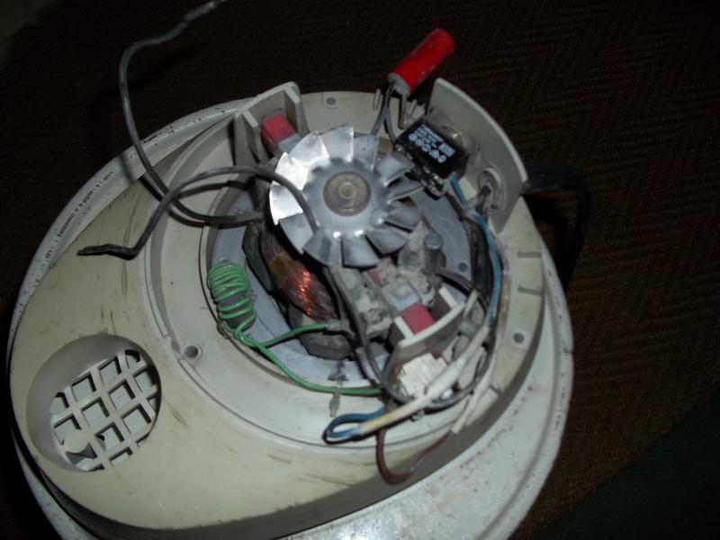

It seems to have gone because the fan was jammed by something. It made a bang and smelt of burning a bit.
The motor itself seems to be ok (although I'm certainly not expert) and I've been assured that replacements are no longer available. I tried a part suggested by my local vacuum repair shop but it wouldn't fit.
Is there any chance it's the red component (a capacitor?) that wants replacing and is so, where would I find one?
Many thanks.
I think the capacitor on these is purely for TV supression, so take it out of the circuit and give it a go.
If the carbon brushes prove to be ok, I'm afraid the motor has called it a day. The burning pong usually proves this!
John :)
Well, capacitor removed and it seems to work. Is it worth replacing? I don't want it to be any more temperamental than it already is!
Run the machine somewhere near to a TV or radio.....if the reception goes beserk then conscience may tap you on the shoulder :P
You'll get a cap from the likes of Maplins, RS etc if you need one - it will have voltage and capacitance markings i.e uf.
