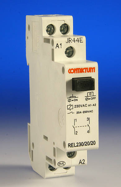

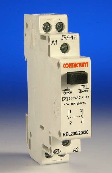

    I have problems with this house, last houses were new, so at least started correct, but this house was a mess. I really do wonder how the last owners lived in it. To turn on central heating you had to go outside down a set of steps and into flat below main house and plug in the pump.
    But I have no problem with these [​IMG]they are beefy units and can take a lot of load, even this upload_2021-11-5_16-9-19.png rated 20 amp so well within limits, this upload_2021-11-5_16-13-38.png however may be rated 13 amp, but would not want to use it for heavy load when I can't see it.
