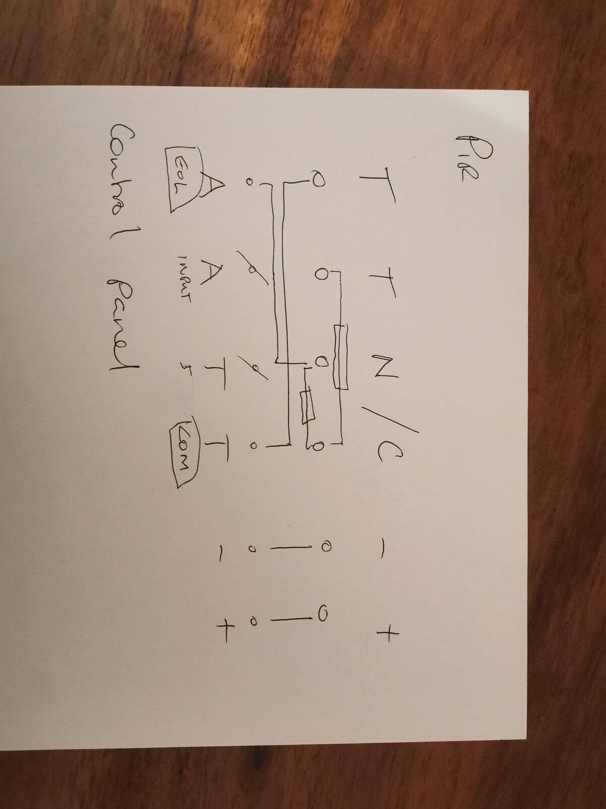

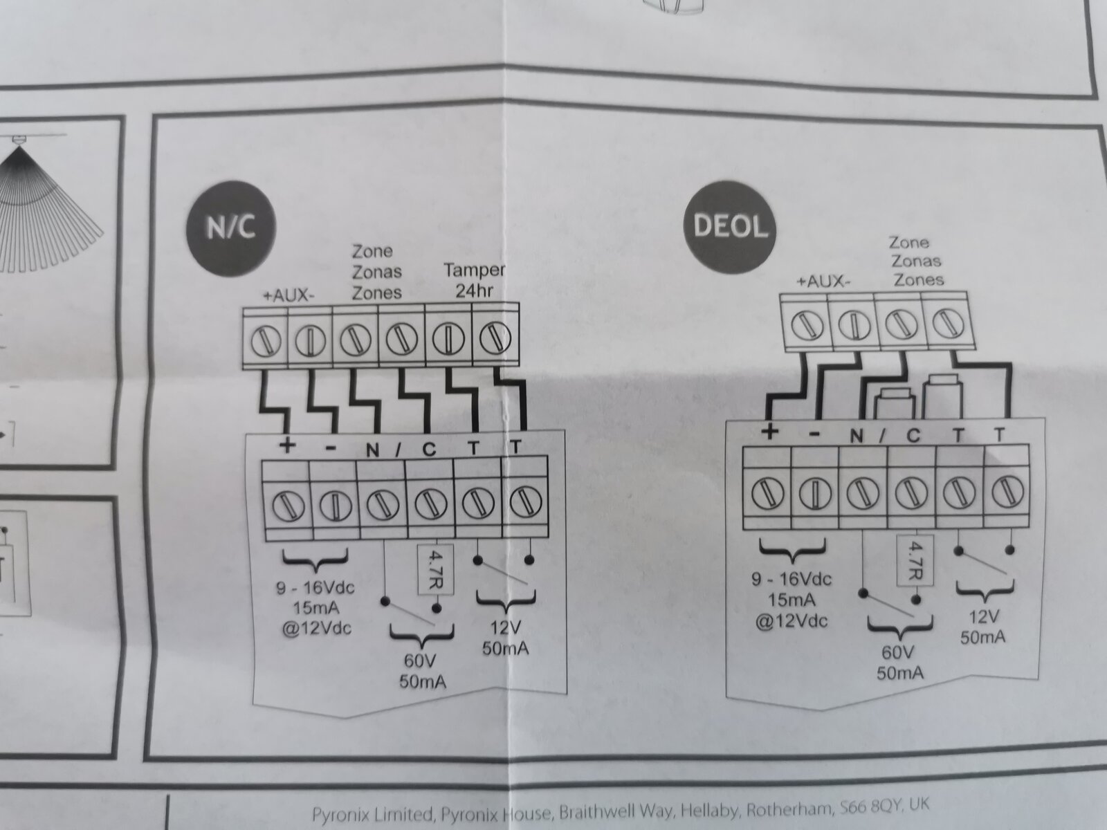

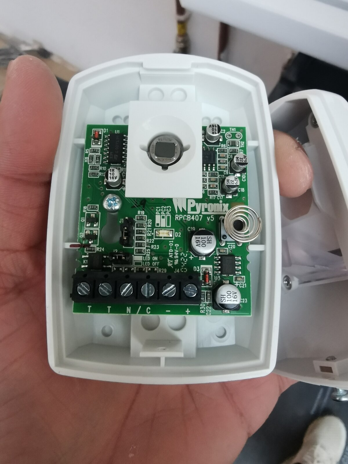

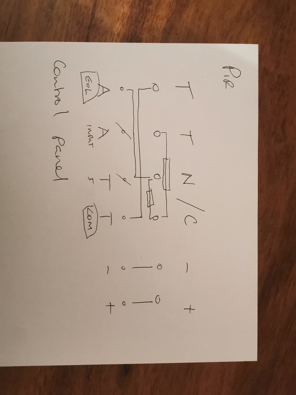

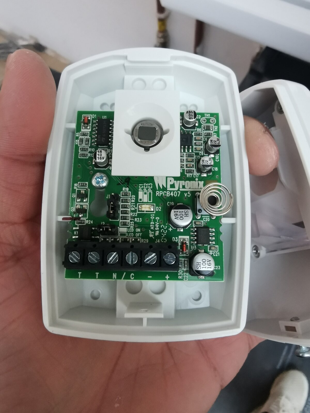

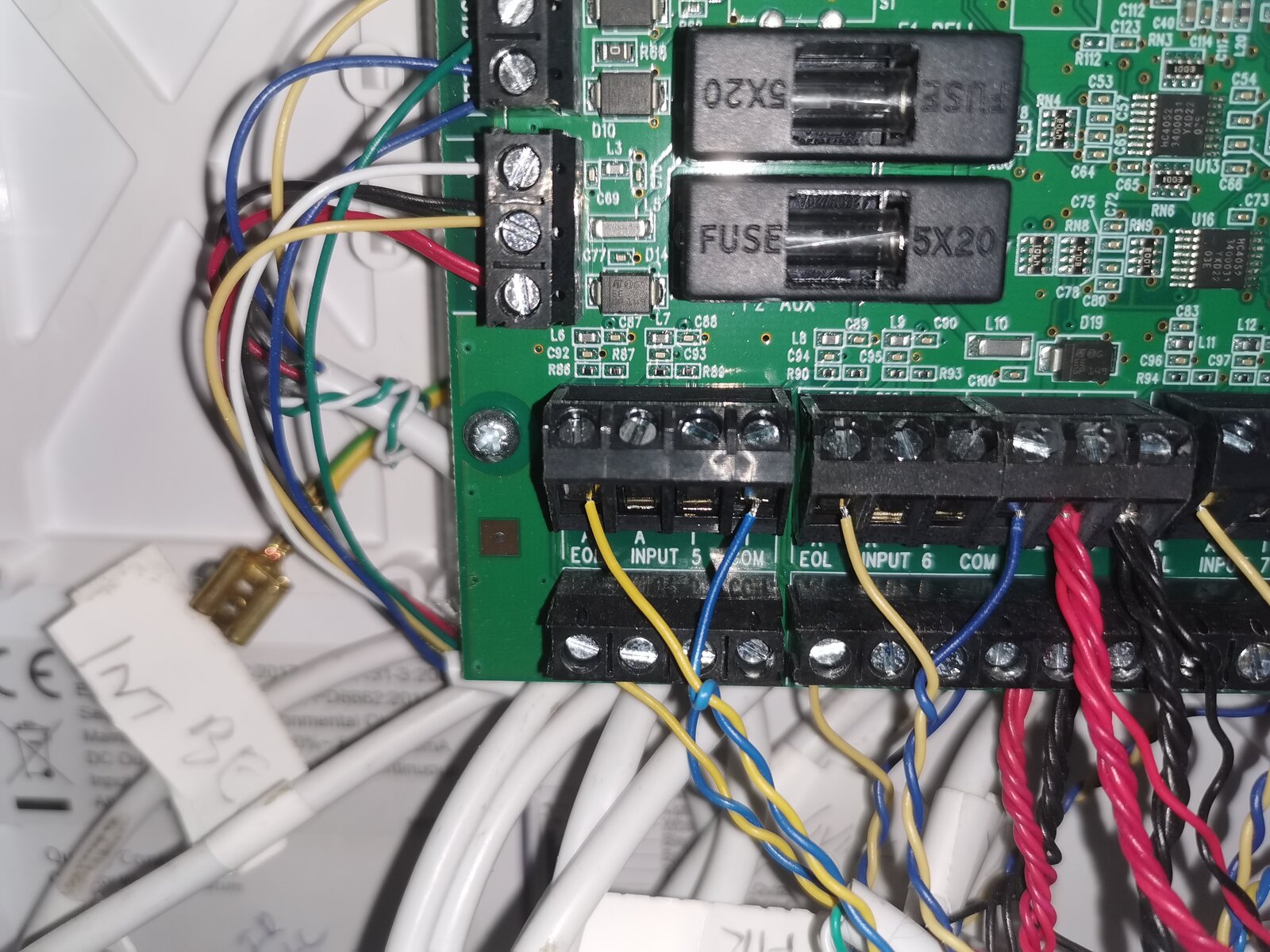

Hi guys,

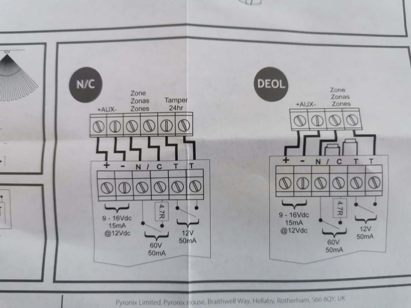

Trying to get the MEBQ PIRs wired into the euro 46 v10 pyronix main unit, but a little confused with the wiring as the manual shows wiring of a PIR with integrated resistors
Could someone help me work out if I'm doing it right as EOL.

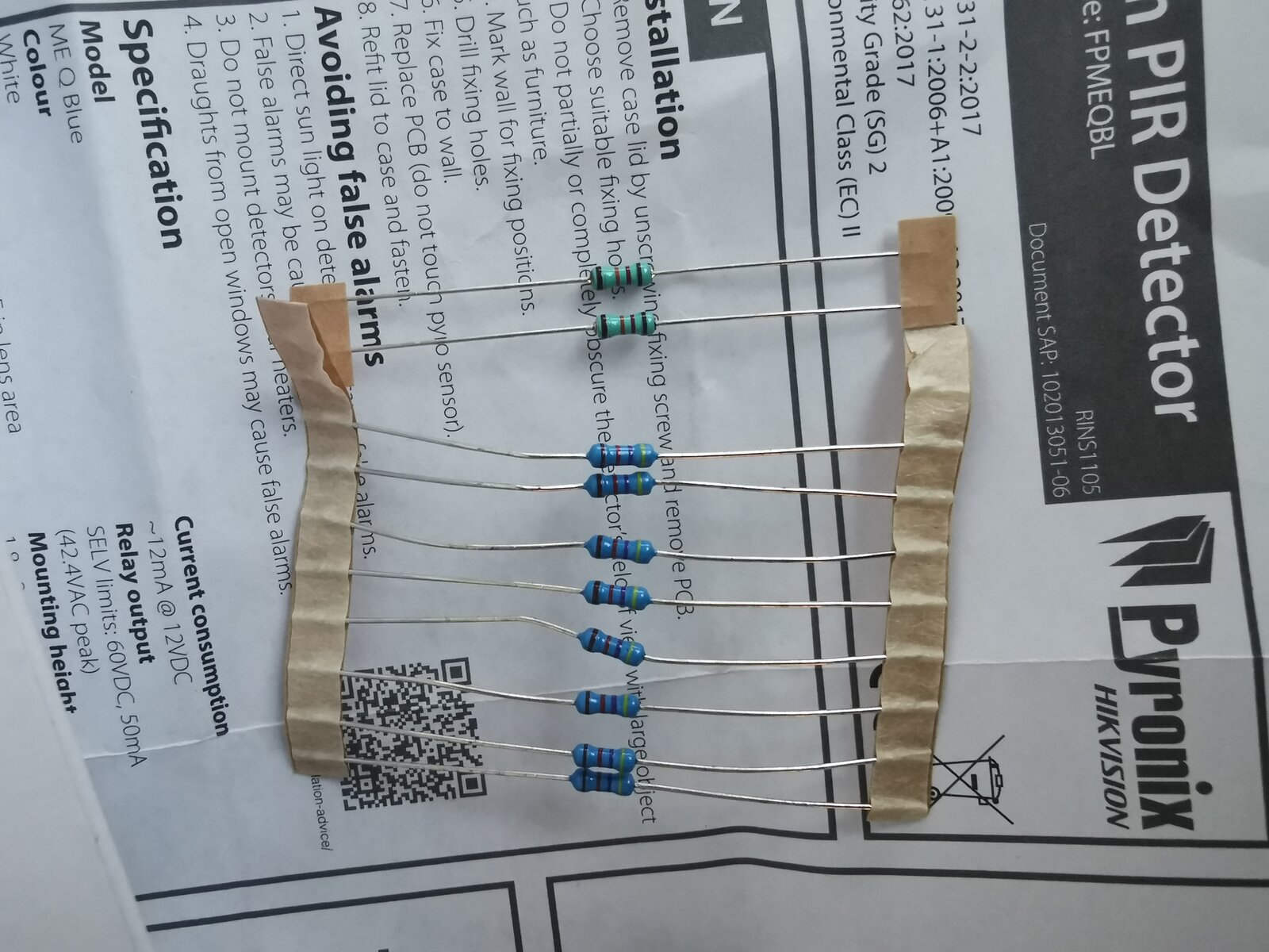

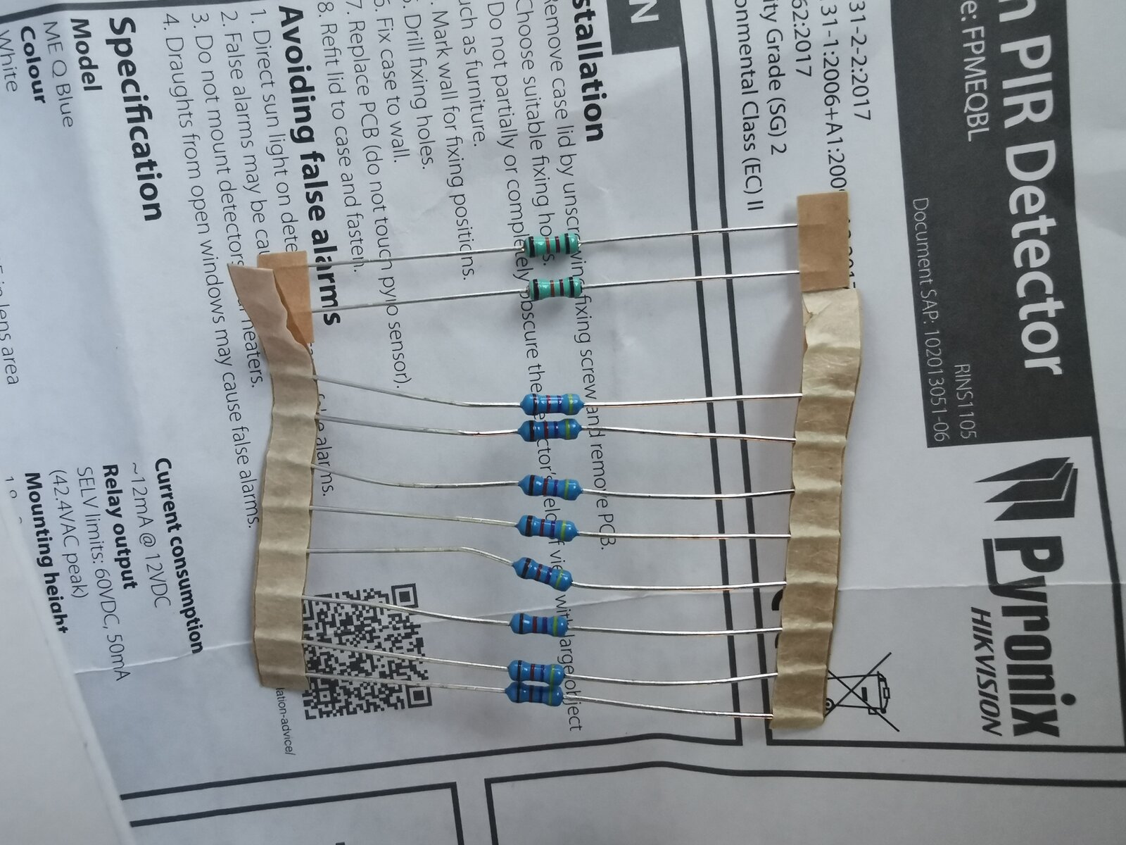

Also these are the resistors (in photo) that came with the main box, are they the right ones? Insert with the PIR shows 4.7k, should they both be that or different?

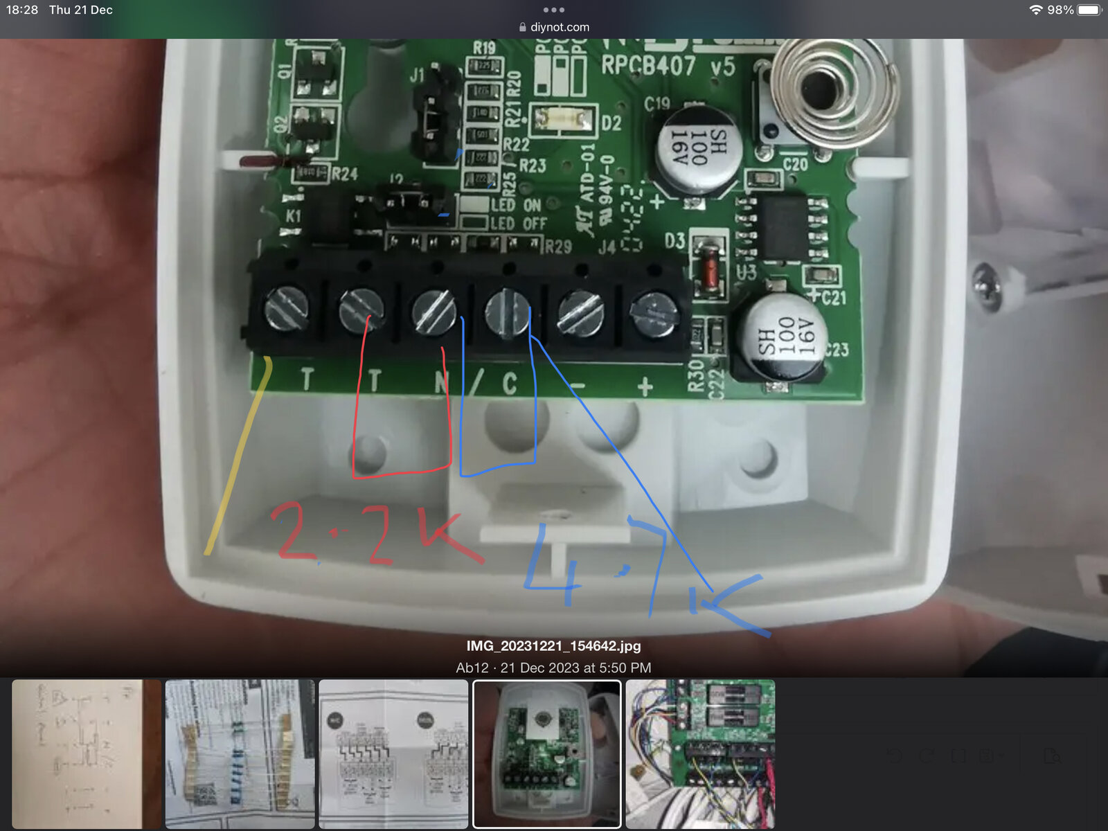

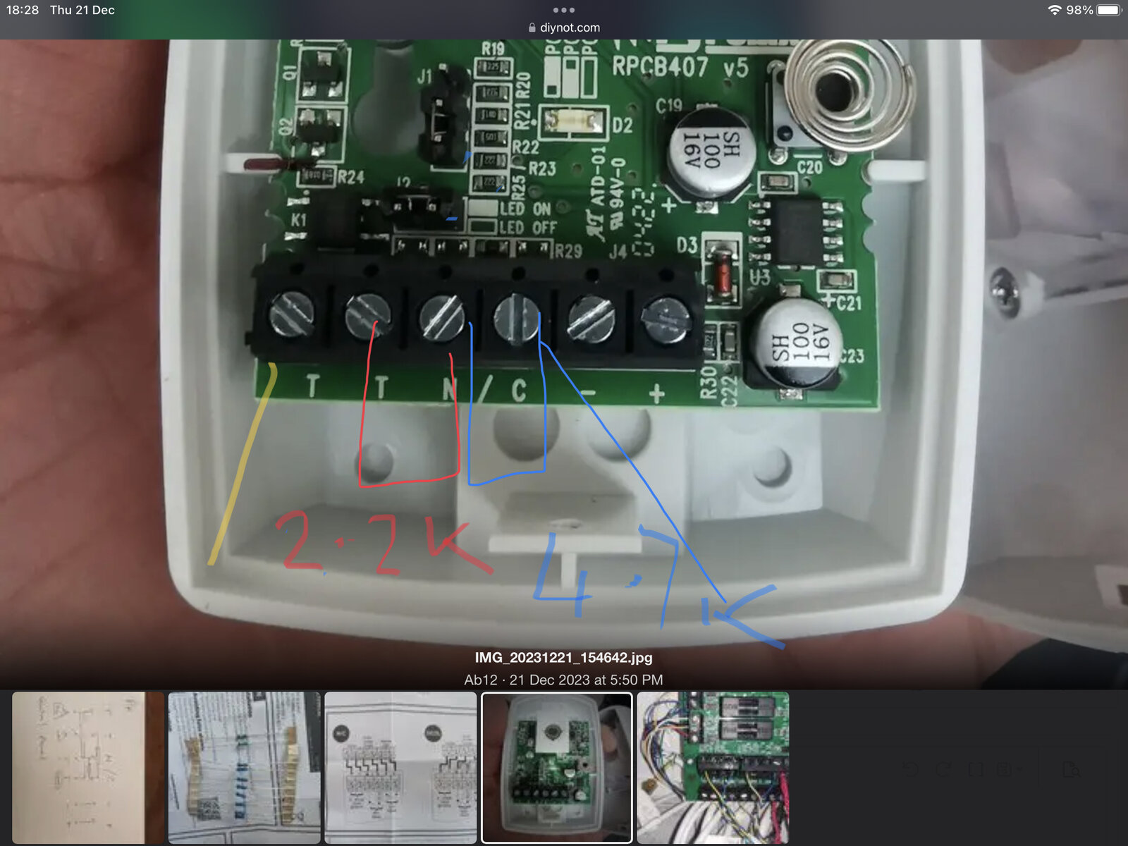

If I do what's in your pic then I assume that's EOL?
If 4 wires + power then that's NC right?
Which resistors are the right ones for whats needed?

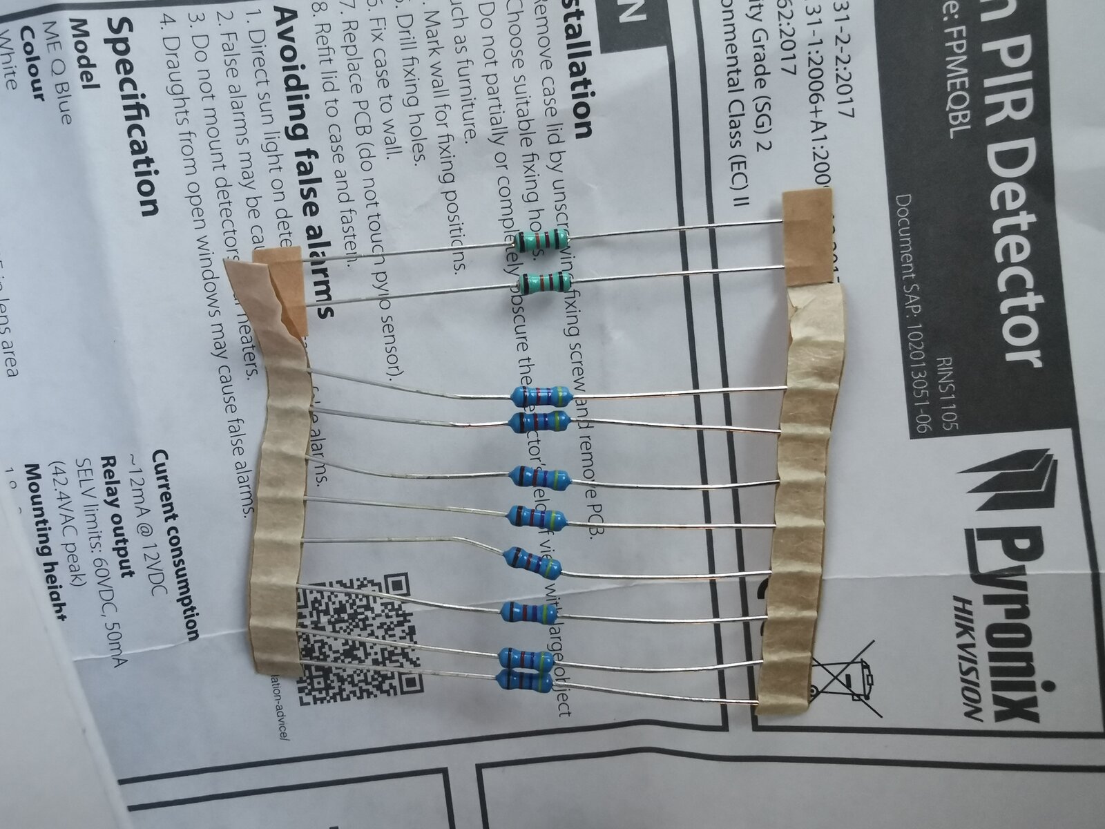

Either of the two in this photo?
How can you tell they are 4.7k. I have another strip but they're the same colour...?
No …the strip of 8 are 4.7k you should have a strip of 2.2k aswell

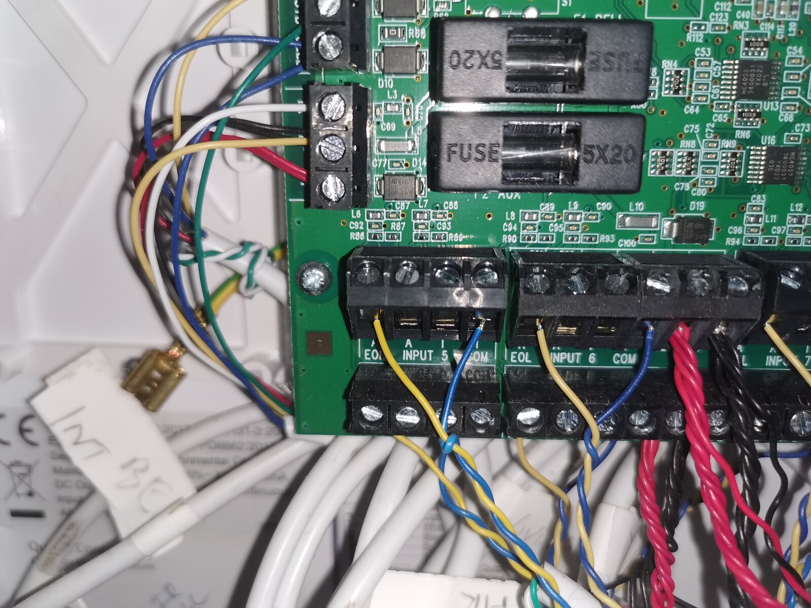

Thanks, seems I did! Managed to work out which ones re which. Just a question, does it matter that yellow and blue are not the same placed as yellow and blue on the control panel. I.e. blue is on T in control panel, but yellow is on T in the PIR?
