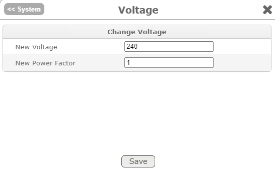

    Once I had established the average power factor and voltage of my installation with which to configure the Owl (both of which are incredibly consistent from day to day), my Owl has proved extremely accurate for a whole installation over any reasonable period of time.
    Since 5th April 2017, my supplier's meter has shown total Day usage of 18,533 kWh and total Night usage of 16,590 kWh. The corresponding figures from my Owl have been 18,552 and 16,622 kWh respectively - representing differences of about 0.10% and 0.19% respectively, which is plenty good enough for me. The same close correspondence exists of any time period from 24 hours upwards.
    It makes no sense to say that they "tend to read high", since whether they read high, low or dead right depends entirely on what PF and voltage one programs into the Owl.

    Interesting John. I was not aware that you could programme your average power factor into the Owl. Similar devices to the Owl I have come across have no means to programme either voltage or power factor into them. How did you determine your average power factor?

    I wouldn't expect you to be aware of everything. This is the relevant Owl set-up screen, showing the default values for voltage and PF...
    I can't speak for whatever devices you may have come across.
    From the kWh and KVArh registers on my meter.
    • Thanks Thanks x 1

    Unfortunately, my Owl does not allow me to change anything in terms of PF and voltage. I am not interested in knowing if I am using power to the nth decimal place just a rough but reasonable idea and I think the Owl has done this. The meter not spinning is also a bit of a giveaway :)

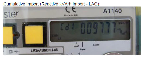

    I obviously can't help'what you've seen'. My Elster A1140 ('dumb') meter certainly does. From the manual ...
    However, that was merely a convenience. Had that register not existed, I would have determined average PF by dividing the kWh figure from the meter by the KVAh figure reported by the Owl (as "kWh") when programmed with PF=1.0.
    To give a feel for how high the average PF is for a whole typical domestic installation, as I reported yesterday, when I last checked my meter it was indicating a total usage of 35,123 kWh (18,533 Day + 16,590 Night) since 5th April 2017. Over the same period, it indicated a total of 3,950 kVArh. Hence:
    Average PF = 35,123 / √(35,123² + 3,950²) = 0.9937
    Kind Regards, John

    I must say that I haven't heard of that one (and nor, it seems, has Mr Google). Do you perhaps mean the Owl Micro? That one does allow you to set voltage, but not PF. However, if my installation is anything to go by then, for 'whole installation monitoring', assuming that PF=1 will make no significant difference - my average PF of 0.9937 is mighty close to 1.0 :)
